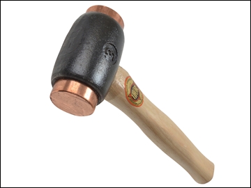

Can you guys get these
a Thor mallet - copper one face, rawhide the other.
Incredibly useful 'persuader'.
