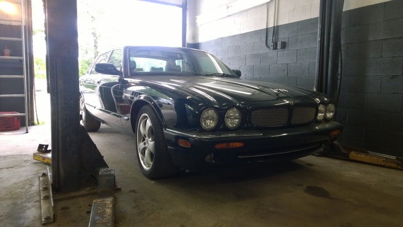

Over the weekend I purchased a 1998 Jaguar XJR locally. The car had been sitting for quite a few years and did not run at the time of purchase. When I looked at the car, it turned over like it had no compression. I picked it up really cheap and couldn't pass up the deal.

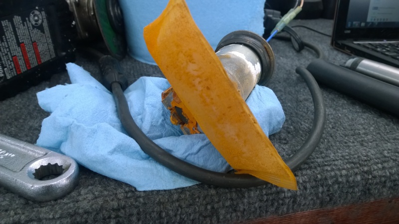

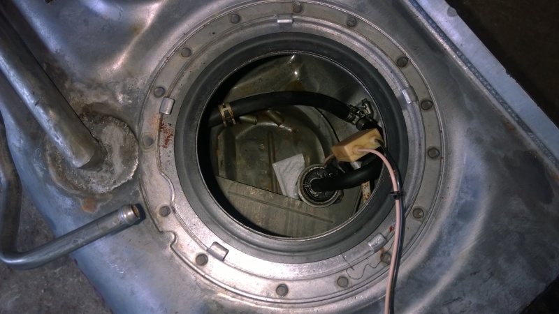

I got it back over to my shop and pulled the tank to drain the fuel and check the pumps before anything else. I was quite surprised by the disaster I found inside!

Needless to say, that mess turned into an all day affair. Both pumps needed to be replaced, fuel filter was replaced, tank was drained, flushed and cleaned...not to mention I had to back flush the lines with a custom cocktail of fresh fuel, Seafoam and Lucas injector cleaner. Picture for reference of the tank going back together.

Congrats! Car looks very good.
(What was "the disaster" inside fuel tank? That piece of foam was inside?)

And what brand was the new fuel pump that didn't work?

Congrats! Yes, same question, want to know what "junk" or "gook" was found inside the tank and what fuel pump brand had to be avoided.
