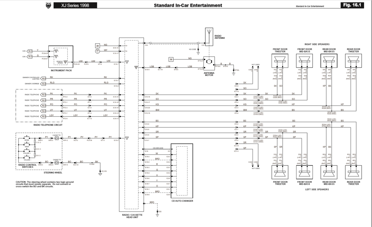

Crutchfield, I get my Pioneer equipment and harnesses from them. I just replaced my PITA Clarion this past Spring. Not knowing what factory system you have, here's both schematics.
