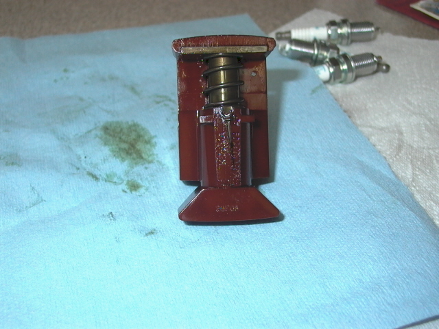

My dad is a mechanic and when I said I wanted to replace the 2nd tensioners he thought I was crazy spending money and fixing something not broken. But, when he went to remove one of the tensioners for me it fell apart in his hands. The best money I have spent so far. If nothing else a little piece of mind!

@DavidN - to turn a blind eye to plastic tensioners is Russian Roulette.....for the sake of your engine, get them done asap.
I recently looked at a friends XJR 2001, it had the plastic tensioners and looked in good shape until I removed one, a great big crack on the backside that you don't see until it's out of the engine, and the same on the other side, needless to say we changed them out that day.

Yes, a wise move. My tensioners looked okay after removing the cam covers, but when I got them out they both had splits in the body and one of them came apart in my hands. I tried to attach a photo. The plastic body had a split in it in both cases. I did the easy replace method and just did the tensioners (with new bolts), the gaskets and seals and the spark plugs. Didn't cost much and since I take very good care of my engine, I think I'm good to go now for a long time. Oh yeah, I did the water pump and thermostat also, which wasn't a bad job either. I guess that might be a couple of reasons why I was able to get a beautiful, powerful european saloon car for basically a handful of peanuts.
