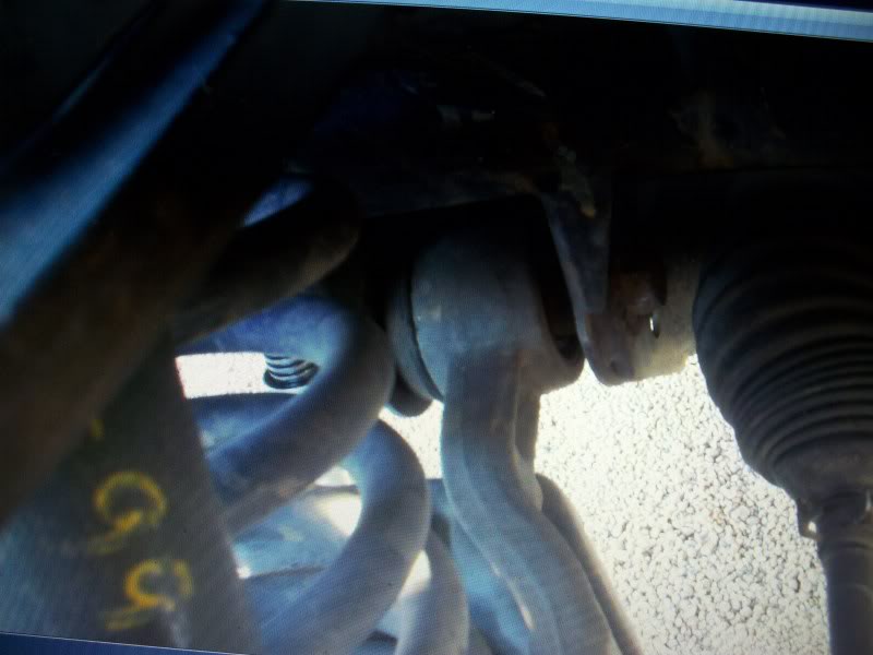

Hello all,
I have 2 questions for you guys. My independent shop cannot find this part for me. They called it an alignment bushing or something along that line. I have a slight camber issue in the front left and am wearing out the inside of my tire too fast. They told me they were confident if this part was repaired and then an alignment was redone it would fix the camber issue. In the pic provided it is the part directly to the right of the second spring from the top in the pic and to the left of the 5 edged bolt..sorry not great the part names lol..and sorry this is a cell phone pic..
http://i5.photobucket.com/albums/y17...ORDANS/133.jpg
second question is if this fails to fix the camber issue they suggested a camber kit that looks to bolt on somewhere. They said that would fix the issue as well, but if the first pic has a broken part as well I would like to get that fixed..just need to know what it is so I can find it online and have them install it...much cheaper than the dealership and they are good, hardworking people

This looks like a rear lower control arm bushing and the bolt that secures it is adjustable for alignment. The bushings are readily available from online stores eg, Autohaus.
I am surprised that your indy could not find them. Were they talking about fitting a control arm with the bushings already in it?

hmmm well at 66k miles which was 11k ago for me I had the lower control arm bushing on the left side replaced? possible I got screwed over with a crappy repair?
That looks like a poor aftermarket replacement bushing or possibly just a rubber insulator stuffed behind the lower arm in an attempt to shore it up. Attached is a bulletin with part numbers to help get the right part.
Good luck!

Correct me if I'm wrong here, but it looks to me like you need [or were asking about] the REAR bushing on the lower control arm. The way I read it, that would be a suffix BB bushing, not a suffix AB, for a 2002 XJ.

my fault just to clarify the problem is the left FRONT lower control arm bushing i believe..getting the car up on a rack friday so i will know more...would that link i provided work for the front left or is that an aftermarket bushing as well?
