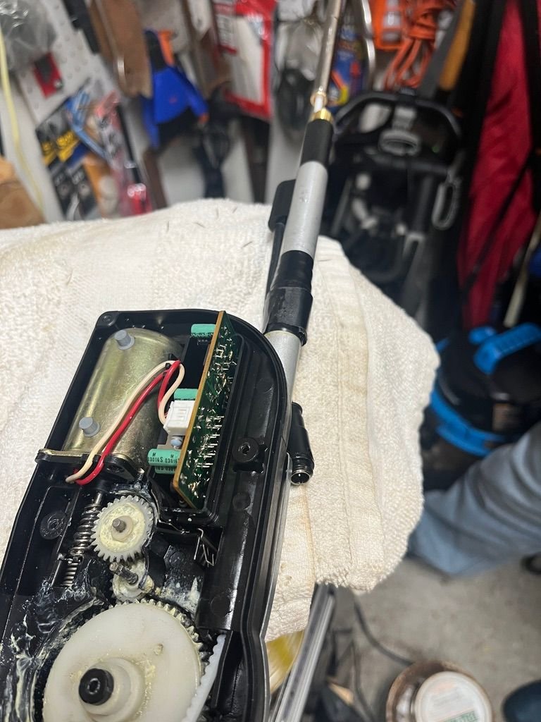

In trying to get this new antenna mast into the housing of the motor, it is just a hair too large.
In trying to get this new antenna mast into the housing of the motor, it is just a hair too large. Ideas?
In trying it to feed the saw-toothen cable from the bottom, the aluminum tube that houses the retracted mast wont budge so I can  feed it in. Ideas?
In trying it to feed the saw-toothed cable from the bottom, the aluminum tube that houses the retracted mast wont budge so I can feed it in. Ideas?

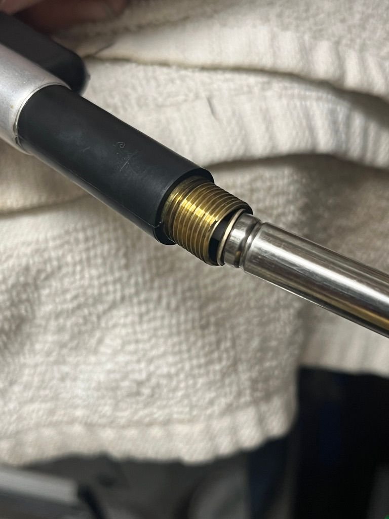

It looks like that washer at the bottom is preventing it from going in. Try filing it down using either a file or 120 grit sandpaper. It won’t be seen so it won’t matter too much if you catch the bottom of the chrome. May help to use a bit of lubricant when installing such as 3 in 1 oil or WD40.

If I recall there's a stainless sleeve with the brass washer at the bottom of the mast - 3" long or so - slide that off and pitch it. You should then be able to install the replacement mast from the top.

I had the exact same problem when I tried to install my brand new Jagaur original mast. So I just filed it down a tad!

A tiny bit of time on the grinding wheel did the deed. Thank you!

Very funny. I was absorbed in a radio program, had a few extra minutes and stopped for a wash. Of course, none of my other cars have aerials. So when I rolled into the wash,, trouble stuck about half way through. I looked in the rear view mirror, and saw the mast leaning over.
Hello?
Turns out other after market antennas have a washer at the bottom end that is 0.2 mm too large.
Recommendation: sand paper, a file or a grinding wheel. The latter did the deed for mine. Now, Im happily connected.
