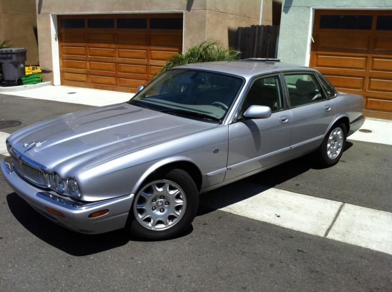

There is a Happy Ending to this thread. I bought a beautiful 2000 XJ8 1 owner car. I am happy! Now I just have to see if the tensioners were attended to. If I can figure out how to post a photo I will do so.
Thanks to all
WT
