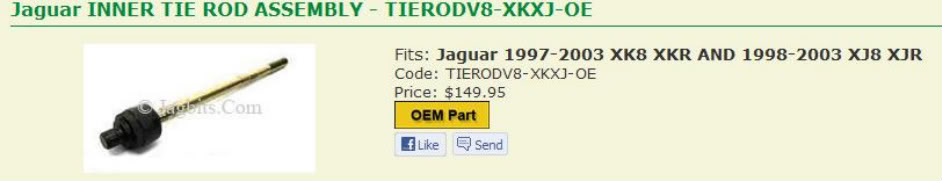

Here is the part number and image of the inner tie rod:
Attachment 168087
Jim Lombardi
hispeed42 Dec 13, 2011 06:12 AM
Jim - yes, that tells me how to release the tie rod from the hub, but I know how to do that and have the tool. I'm looking for how to release the inner tie rod from the rack. From the picture, it appears to be pretty straight forward: get the inner tie rod tool, take off the boot (gaitor?), operate tool ... I have new boots, so not worried if I have to cut one off. Then again, I just might try the heat trick ... decisions, decisions.

BlackX300VDP Dec 13, 2011 07:34 AM
From my experience, Jag does not sell the inner tie rod separately. Its not that the dealer WANTS to sell you a whole rack, but they probably aren't going to search out an aftermarket inner tie rod. They are available. Rebuilders can get them so why can't we? Try Welsh Enterprises. I know they can find a whole bunch of stuff even when its not listed on their website. I also get some stuff from Chris at Jaguar West Chester parts. He usually can find stuff if you give him time.
