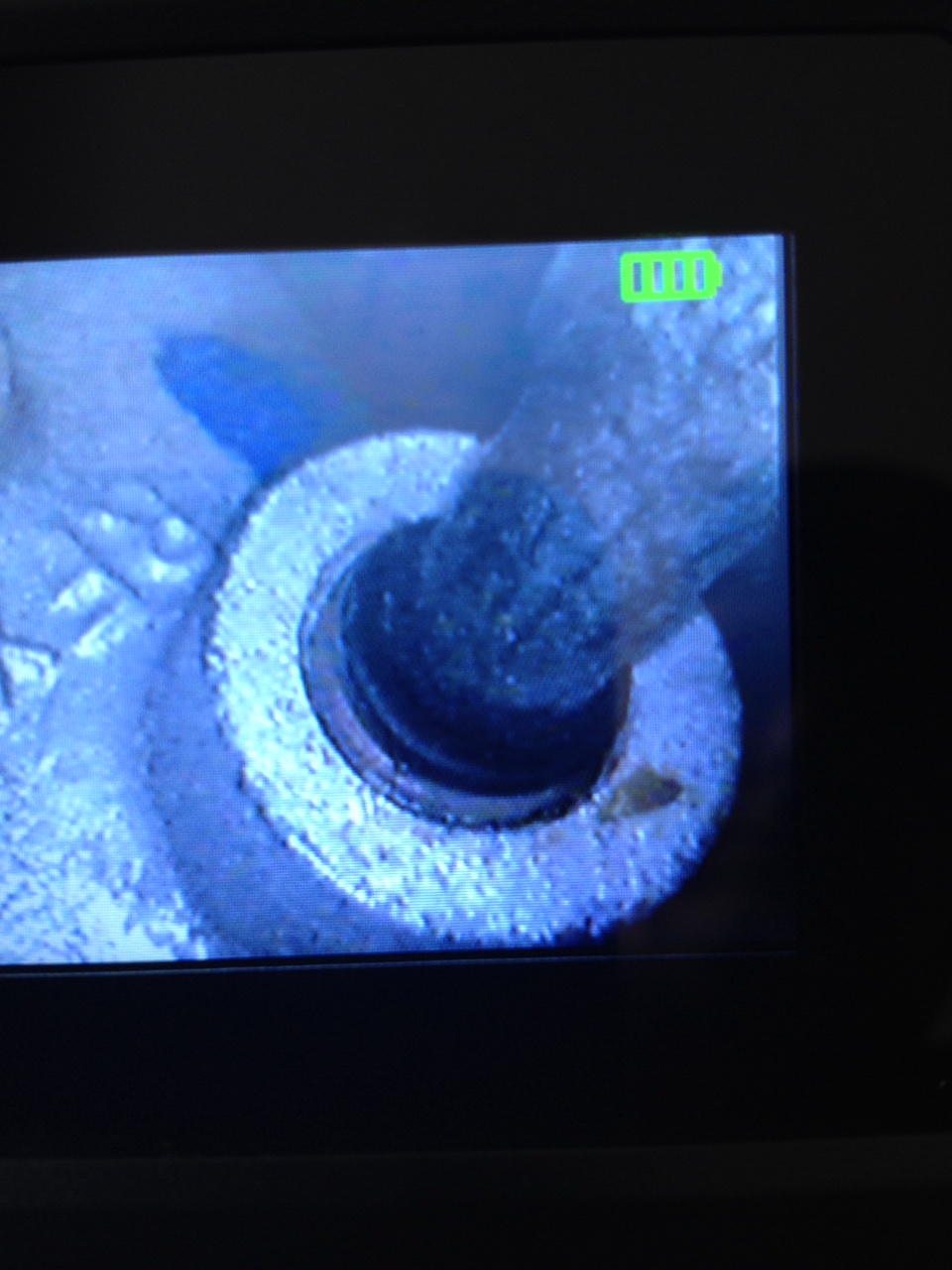

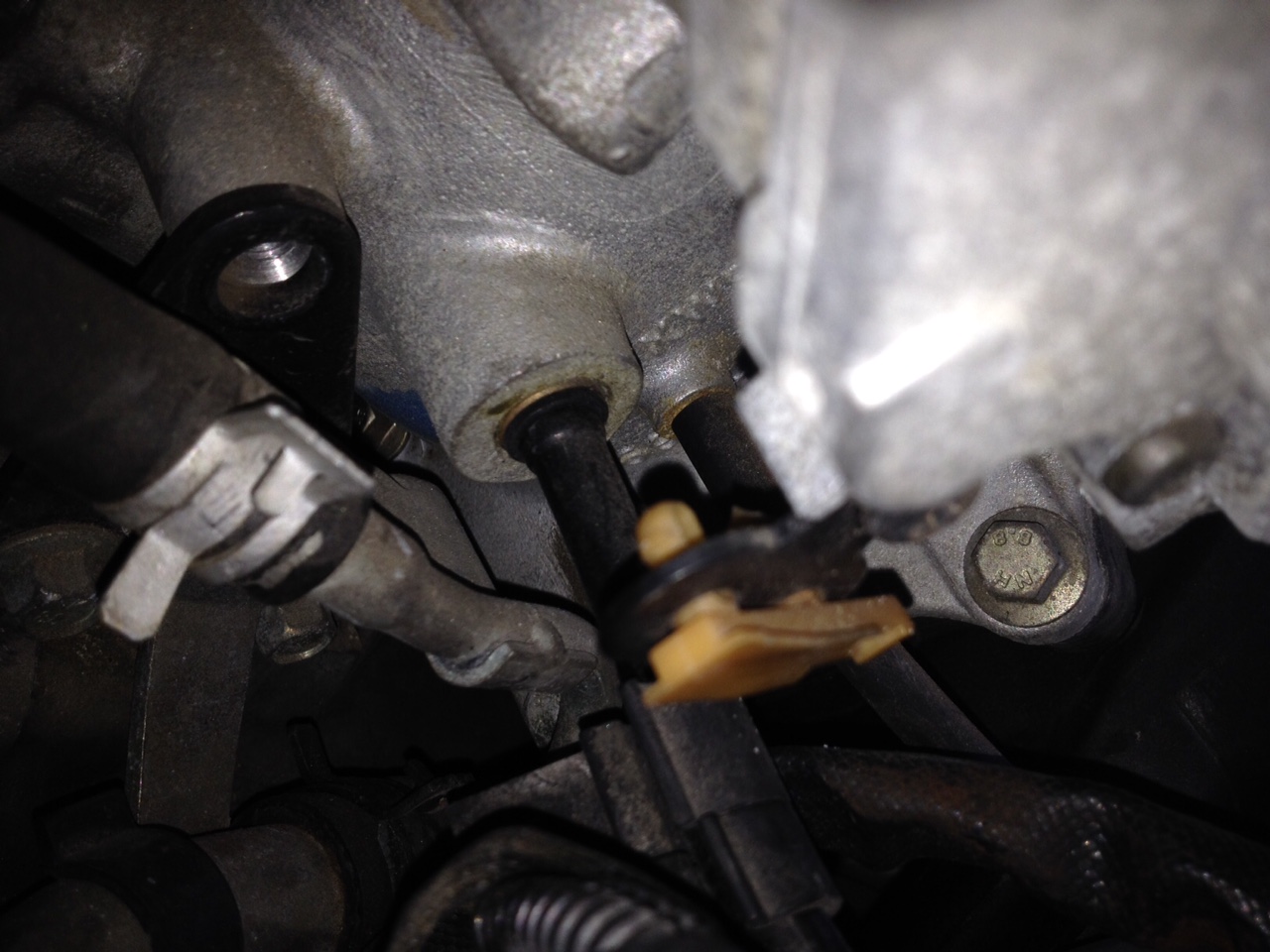

I have experienced a rasping sound during acceleration. I hooked up the smoke test machine this morning and found a leak in what appears to be an air line coming out of the throttle body elbow and going into the compartment that also contains the brake reservoir. I am speculating that this is something to do with the "air assist" version throttle body. It's not immediately apparent how this line connects and I'd rather not start messing with it to attempt a repair until I know what I'm dealing with.
The attached pictures show a photo of my inspection camera screen and the other is a direct picture of the location with the leaking connection about mid screen.
Anyone know how I should remedy this leak?

Part number C2S15816. Gets you a brass housing housing containing the "O" ring and a new collar for that vacuum pipe.
Remove the pipe, remove the collar, replace the "O" ring and put in the new collar.

Excellent, thank you! I will probably dab a little RTV on it to prevent leaking until I can get the proper parts in to fix it. Since access is limited, will I have to remove the throttle body to install the new housing and O-ring?

Usually not, though if the throttle body is off it will be easier.
You get the housing, but you don't use it, just the ring and collar. The housing is actually the part that is pressed into the aluminum induction housing, you won't have to change that.
