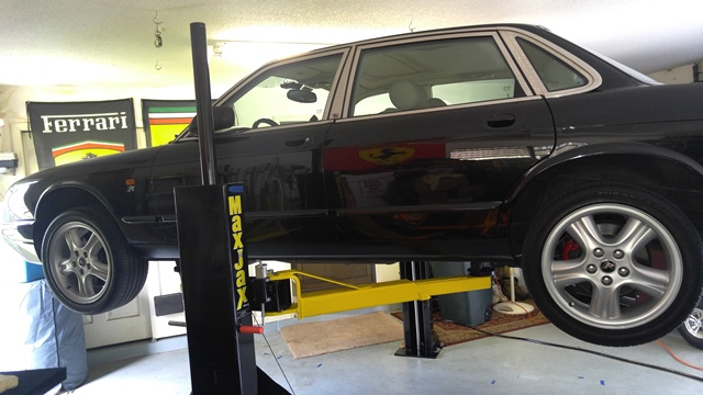

Changed the oil and filter, cleaned the part load breather and gave the entire undercarriage a good look over.
Did it all in 30 minutes on my Maxjax, best tool I have ever purchased for my garage, period.
Pic of the Jag on the Maxjax from a few months ago:
Alden

Originally Posted by Stu 1986
That looks like an awesome thing to have Vector, however you need a spacious garage to house it!
Not really, that is one of the reasons why I chose it.
I do have a 3 car garage, but it holds 3 cars, a golf cart, a 50" zero turn mower, 2 recumbent bikes, 2 large standup toolboxes, a large workbench and shelf storage around the perimeter too.
You can unbolt the Maxhax from the floor anchors and roll the lift rams out of the way when not in use. The hydraulic pump is on wheels too. In my garage, the lift stays in place and I just park one of the toy cars in between the lift arms. Plenty of room to get in and out of the car too.
Since it only goes up 44", you don't need a high ceiling either, mine is 8.5'.
It is easy to roll around and work underneath on a mechanic's stool with wheels.
I installed a new O2 sensor and condenser fan bi-metal sensor on my Ferrari last night too.
Having a lift is the best, makes most every under car task easy and quick.
Vector

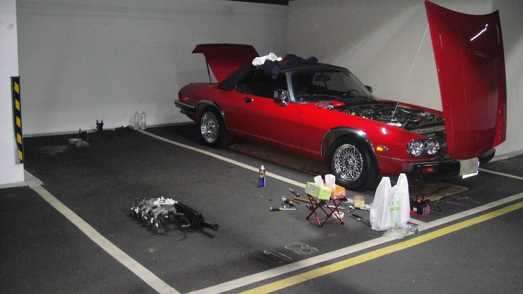

Well, at least you guys have garages .
I am struggling in our underground parking.
Luckily I got one at the far end, and keep a low profile to prevent kicking out (cleaning up every night), but I have no electricity nor anything else.
And they don't come with the apartment, are in short supply, and sell at ~ USD. 50.000 each, normally sold within a couple of hours ...

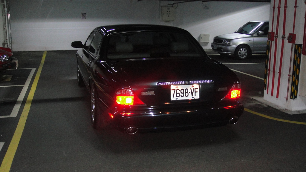

I opened up the hole for the 2nd tail light (as standard on the x300) and modified the fitting plate for the additional 10W lamp.
Now got some extra visibility, and hopefully some extra security by being a bit more visible in the night.

Originally Posted by smtguy
...I decided to pull the back seat and rear shelf and install my new OEM sunblinds
Scott,
Did you buy the blinds new?
Any info?
I would love have some (one piece version in my case) but anything after market I have seen so far sucks.
Eric
Old Jan 1, 2017 | 07:02 PM
  #1737
nilanium's Avatar
Joined: Oct 2014
Posts: 1,465
Likes: 515
From: MD, USA
I like this, any shots of it from further away (entire back of car)? The x308 tails do look a bit too small at night.. I'm assuming it's only the running light, and not a bifilament bulb like the brake light?

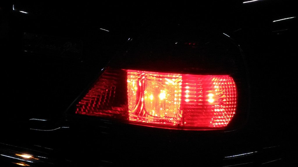

Originally Posted by nilanium
I like this, any shots of it from further away (entire back of car)? The x308 tails do look a bit too small at night.. I'm assuming it's only the running light, and not a bi filament bulb like the brake light?
Yup, it is only the additional 10W running light on each side of the car, not the brake light.
Just as it is/was for the x300, but kind of omitted for the x308.
The hardware is already partly there, but you will need to create power in the lamp socket (or buy a x300 lamp holder, very cheap), provide power to it, and create a small hole in the taillight itself for the bulb to stick through.
The bulb is behind the red reflector, and both lights have the same intensity. On below (sorry, crappy) picture the flash reflects in the reflector though, hence it looks a bit like it is a brake light.
