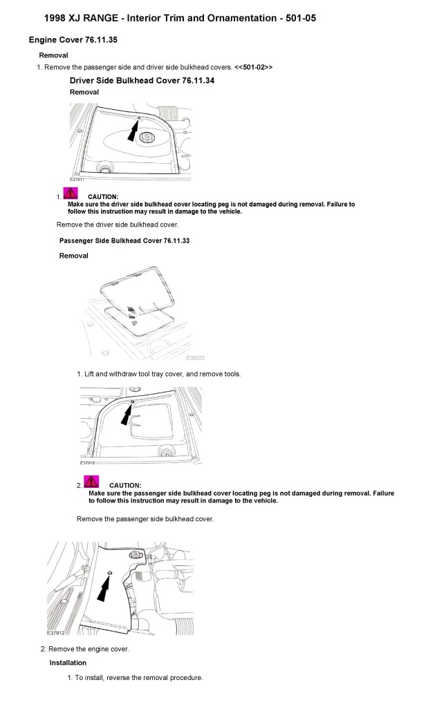

Hi Newby
Sorry about your engine cover damage.
I am sure you will be able to remove and install the engine cover, but it is nice to have instructions with the steps, precautions and illustrations:
Here is a JPEG that I made from the Jaguar Shop Repair Manual (You can increase the viewing size with the view zoom in your internet browser 125% is good):
Hope this helps
Jim lombardi
