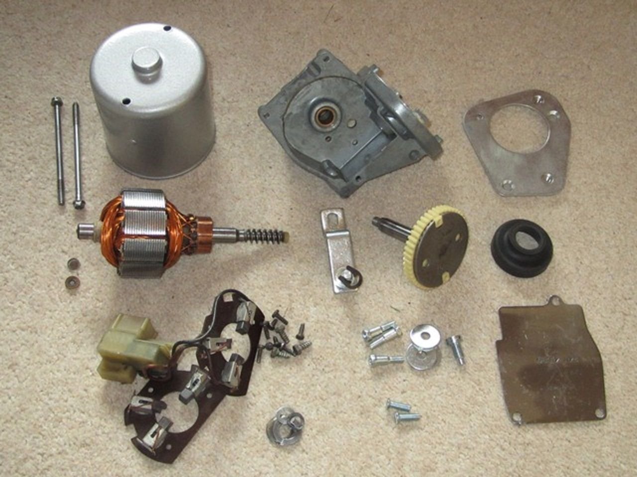

As far as I remember, its not the lever, but the wiper motor itself.
It has contacts to determine the stop-points, which wear out.
I don't know if it is even repairable, we changed the whole wiper assembly on 2 cars.

This information is based on the X300 model which may be different
There is one contact point micro switch under the cover in the motor gearbox that can be replaced
The dimension of the red button depression is critical and they come in different dimensions
Some get the normal open and normal close switches mis - ordered
the motor itself turns through a continuous one direction full rotation after another
Someone replaced a capacitor on the motors electric brushes

Thank you very much! That might be helpful! I'm a little hesitant on getting a used one since regardless of the fact there are many good used parts out there, I wouldn't like to test murphy's law on getting the same problem on a different part. However new ones are scarce and quite expensive so I'm going to check if it can be serviced and the contact point replaced.
Cheers!
