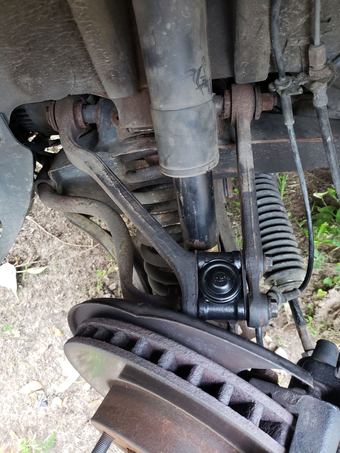

Ball joints
Got all 4 ball joints done this was actually easy and nothing note worthy. Easiest ball joints ever. Although this does not make up for everything else. https://cimg4.ibsrv.net/gimg/www.jag...fe762f9015.jpg
