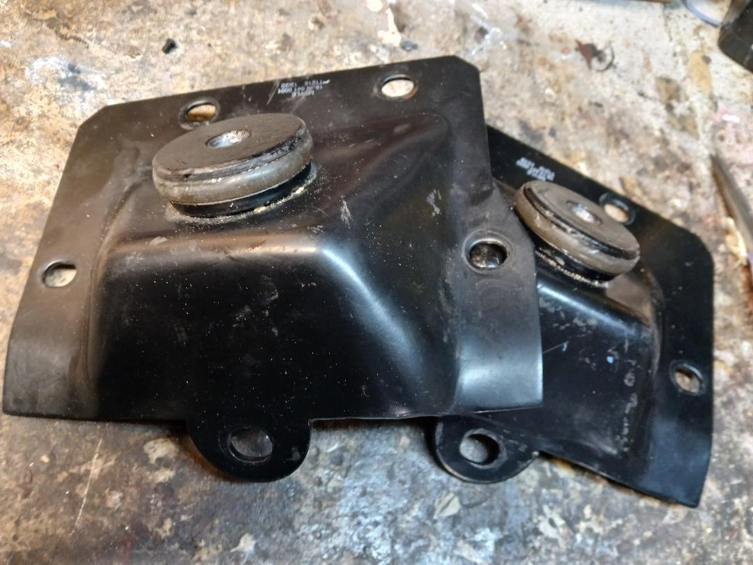

After the huge success of the XK front shock mounts I've been asked to create the flexible urethane mounts for the X308, and here it is. After more than 2 years on the XK's with no visible deterioration this material should last forever and you should never have to replace the mounts again. I'm told that the aftermarket ones are absolute rubbish, and OEM's are rare as hens teeth. For $80 the problem is solved forever!

Looks like a good buy, . . . except, how hard does it get in cold. The problem with neoprene was they hammered when cold . . .

That material has been on the XK8/R for over 2 years, all over the world, and I haven't heard of one problem!

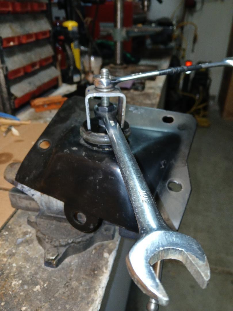

Since I don't have a press, I made up this simple little tool to Squeeze the parts together and roll over the center tube into the bevel! Quick and effective!

Hi Peter, Thanks for posting this...very helpful for do-it-yourselfers. For those of us who are a bit mechanically challenged, perhaps you could post a photo of the special tool being used during installation of your new parts on a bracket? Also, the diameter/length of the threaded rod would be helpful in gathering up the various components to duplicate your design. (looks like a lug nut in the middle?) Thanks again, Eric

3/8"-16 threaded rod 5" long 3/8" 16 nuts and washers
The center long nut is called a standoff, 3/8"-16 x 1" long, 5/8" AF, ground on a bench grinder to 45 deg.
Mcmaster carr has these # 91115A313
Top U bracket, made from 1/8" x 1-1/4" steel, 1-1/2" high x 1.6" wide. Not quite 1-5/8"

Perfect. Thanks!

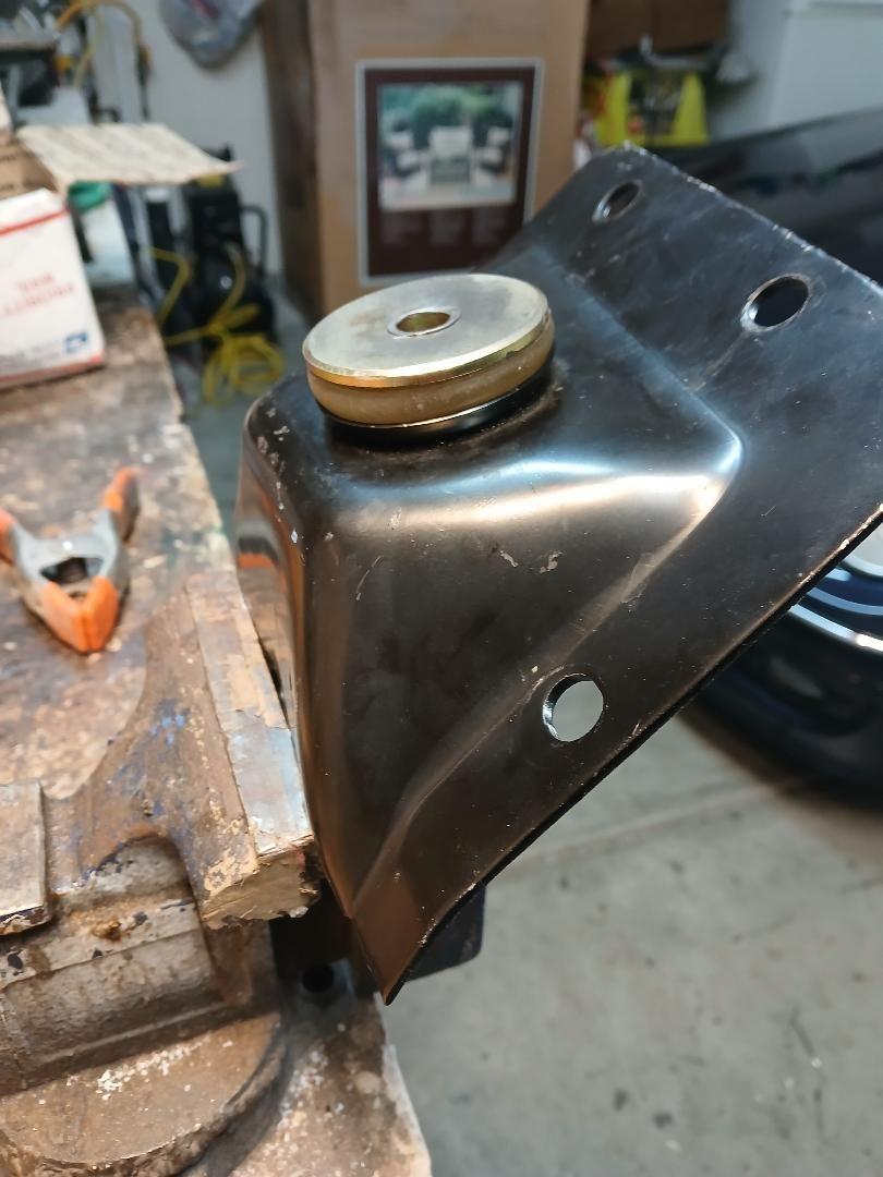

This works too! except for adaptive

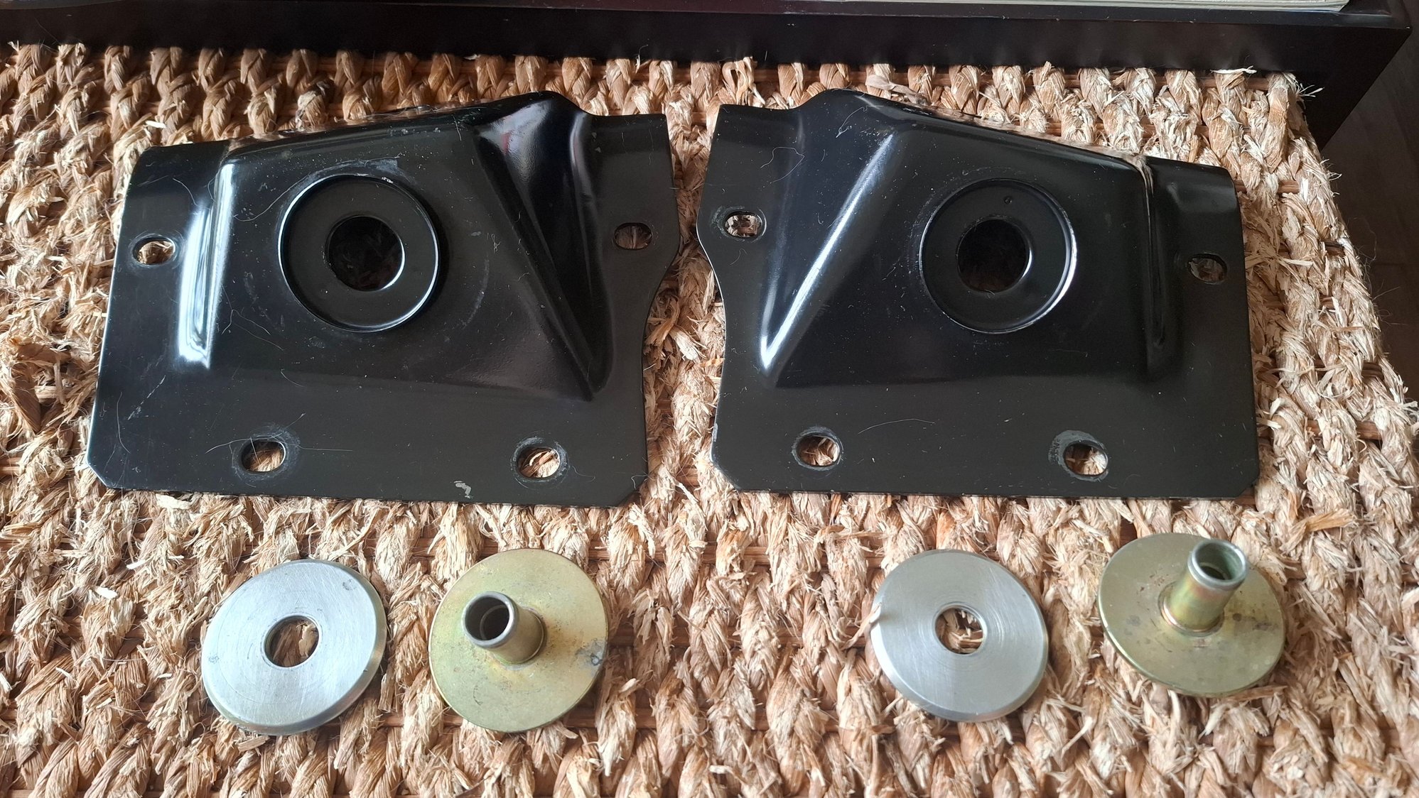

Have you put yours together yet? if so, pictures?

I used phoban's bushings in the spare (original) set of Jaguar OEM brackets yesterday. They came apart fairly easily using a small 3-leg gear puller with a spacer, and went back together using just a threaded rod, a suitable diameter spacer and some nuts/washers. Disassembly of the URO bracket, which had suffered a failed bushing at less than 500 miles, would have required a lot more force (I tried), and probably a torch to heat up the retaining washer. (The hardware is slightly different between the two). A test drive this morning was fine except that the CATS on my car seems to have gone to full firm when that URO shock bracket bushing disintegrated, and it remains stuck on full firm on all four corners. Anyway, I'm very pleased with phobman's product and service.
