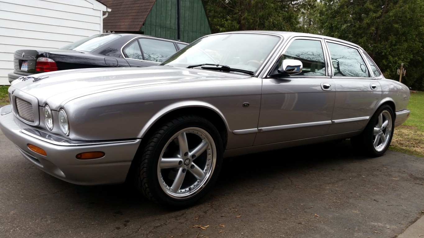

As a point of reference, I just put 255/40/18 on my 2000
Attached Thumbnails XJR Tires 255/45/18-wheels6.jpg
