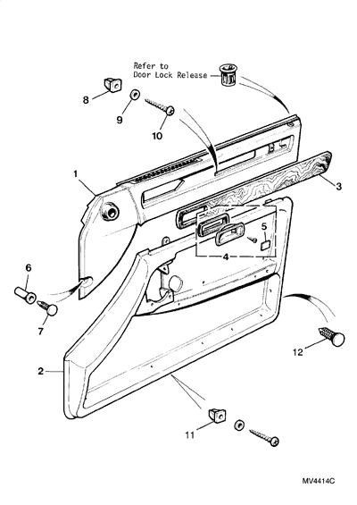

The diagram on JHT will show you all the fixin's, I'll try and find the diagram and post it in a sec.
here you go
Looking at the diagram, I guess you'd have to pry out those two push on's at each side and maybe no need to remove lower panel (armrest) either ...
here you go
