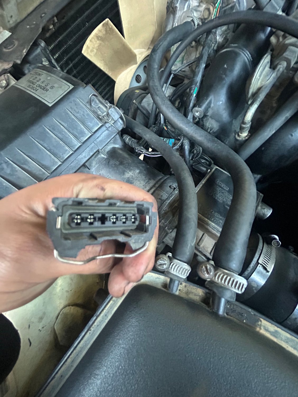

My apologies bout that. This is the condition of theMAF sensor atm.

Check all the air intake hose connections and vacuum lines, sounds like you have a vacuum leak. The big corrugated hose to the throttle body can get pinched easily, check that at the bottom too. Overtightening the other end can collapse the plastic elbow also letting unmetered air in.

Turned out to be an intake manifold gasket. Air was seeping through heavily replaced that all good now!
