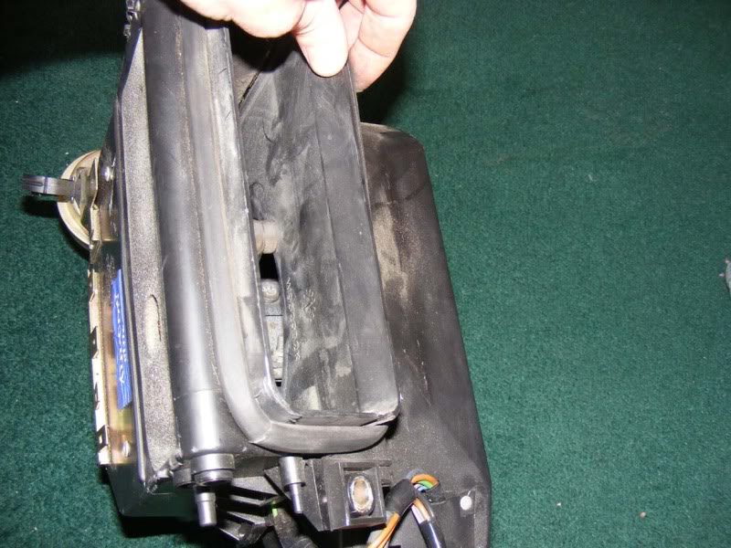

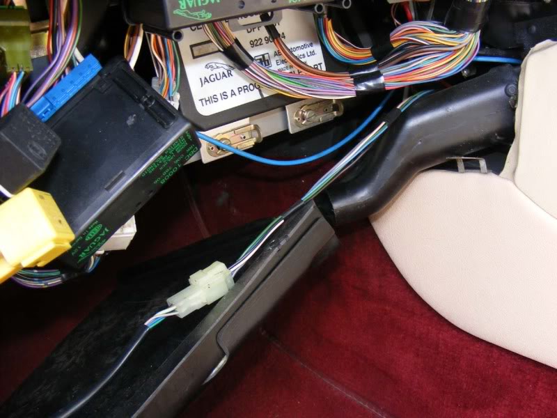

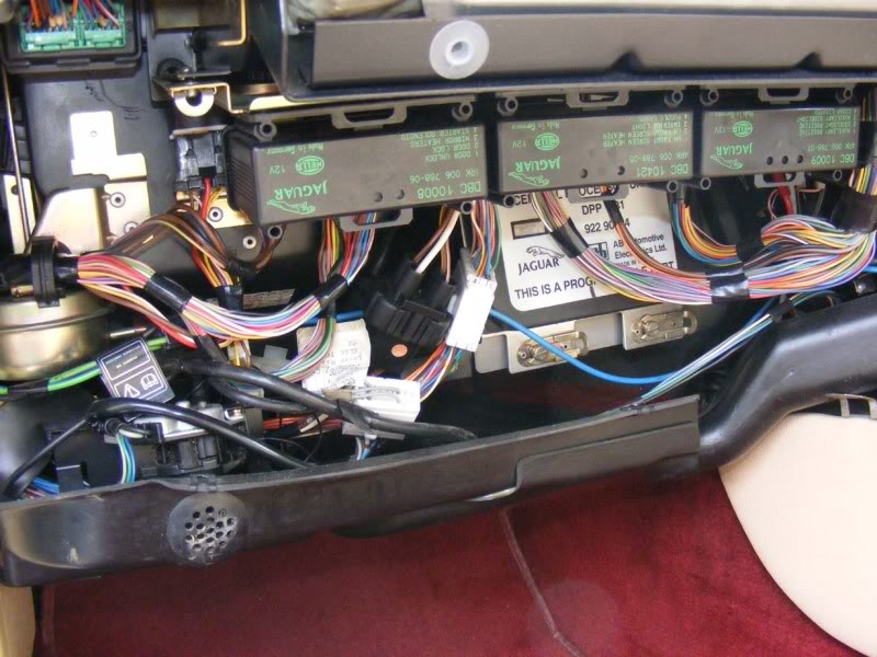

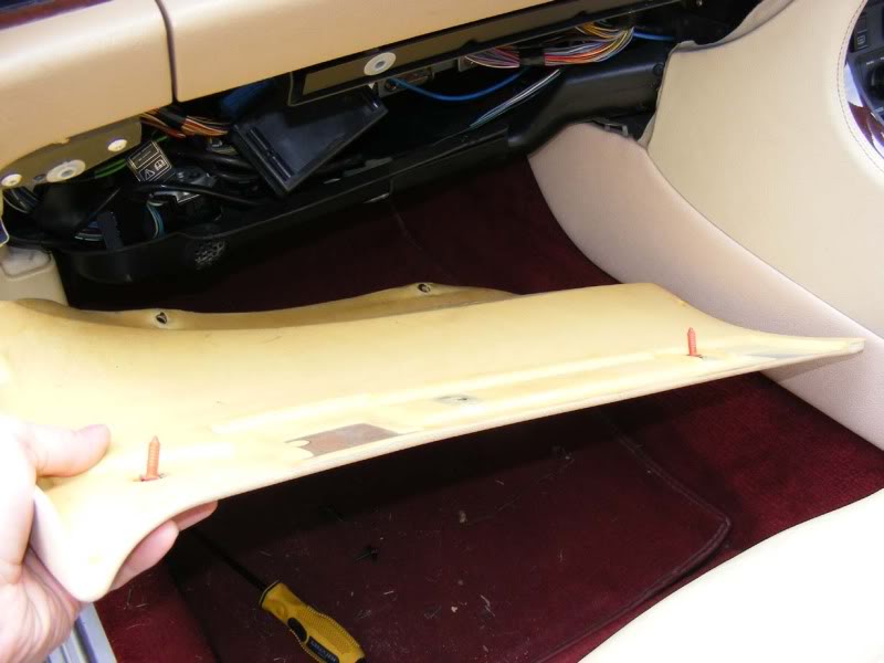

Step 1 - To start with we need to remove the lower cover in the passenger footwell. There are 4 Philips screws holding this on, one on the far left (nearest the door) shown in the first picture, one slightly further in front of the vent and two more on the right hand side nearest the centre console
Step 2 - Once you've removed the 4 screws you should be able to ease the panel away gently (note the 2 red plugs which hold the trim in place so it will need to be pulled out directly towards the passenger seat)
Attached Thumbnails XJ40 - Rebuild blowers motor not working-hbstep1a.jpg   XJ40 - Rebuild blowers motor not working-hbstep2.jpg   XJ40 - Rebuild blowers motor not working-hbstep3.jpg

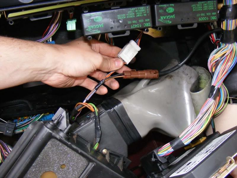

Step 3 Remove the lower air box guides airflow temperature sensor.
Attached Thumbnails XJ40 - Rebuild blowers motor not working-hbstep6a.jpg   XJ40 - Rebuild blowers motor not working-hbstep6b.jpg

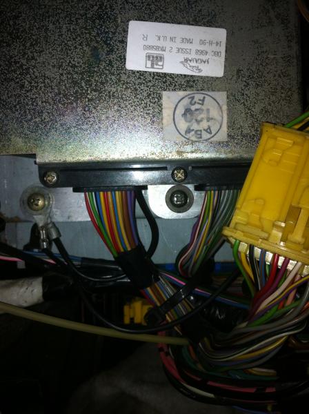

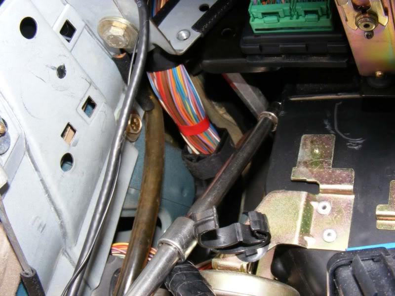

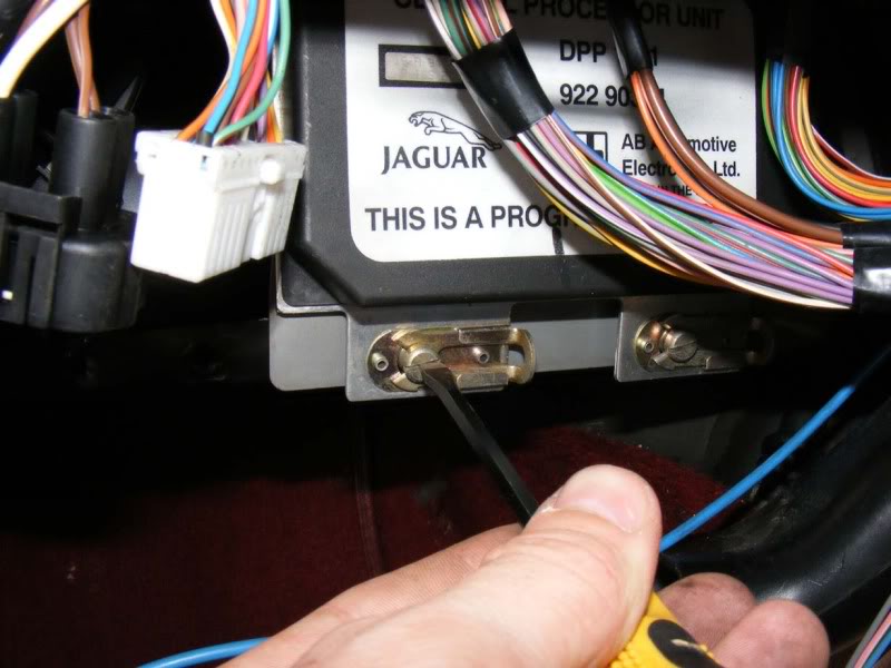

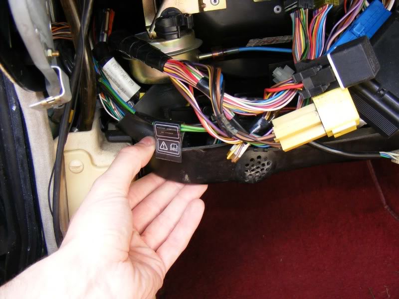

Step 4 - Disconnect all the multiplug connection which are starting to get in the way, also disconnect vacuum line and then remove ECU.
90 XJ40 model:
Attached Thumbnails XJ40 - Rebuild blowers motor not working-062.jpg   XJ40 - Rebuild blowers motor not working-063.jpg   XJ40 - Rebuild blowers motor not working-064.jpg   XJ40 - Rebuild blowers motor not working-065.jpg   XJ40 - Rebuild blowers motor not working-067.jpg
XJ40 - Rebuild blowers motor not working-068.jpg   XJ40 - Rebuild blowers motor not working-069.jpg   XJ40 - Rebuild blowers motor not working-072.jpg   XJ40 - Rebuild blowers motor not working-hbstep16.jpg

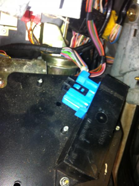

Step 5 - You can now slide your extension bars up and remove the 10mm bolt holding the blower motor fan in place. I beleive there are total 2 bolts secure the motor in place. And final you can remove the motor out.
Attached Thumbnails XJ40 - Rebuild blowers motor not working-hbstep12a.jpg   XJ40 - Rebuild blowers motor not working-hbstep23.jpg

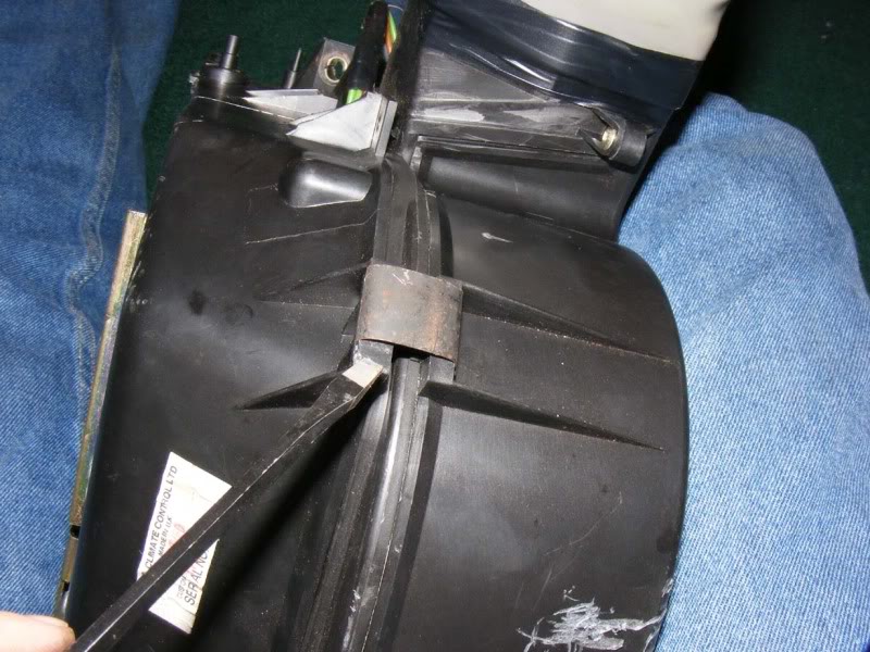

Step 6 - There are 5 clips around the fan unit which hold it together, ease these off with a flatblade screwdriver (and cover with your hand so they don't go springing off!).
Step 7 Remove 2 philips screws and rubber seal
Rubber seal
Attached Thumbnails XJ40 - Rebuild blowers motor not working-hbstep25a.jpg   XJ40 - Rebuild blowers motor not working-hbstep26a.jpg   XJ40 - Rebuild blowers motor not working-hbstep27.jpg

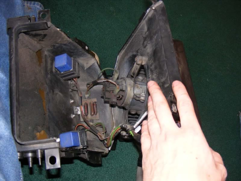

Step 7 - Open up the blower motor, you see 2 blue relays insite. This relays need to check replacement them if bad.

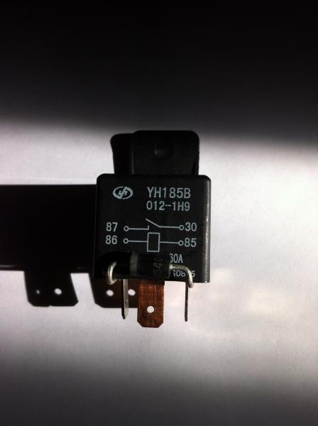

Step 8 - Those relay has a diot connected terminal 85 to 86 and The duty of diode is protected relay coil, it let high voltage, high current flows around cycling the coil thru diode when supply voltage between those terminals suddently cut off. So it may burn out some time and go to damage relay coil.

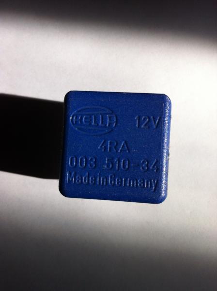

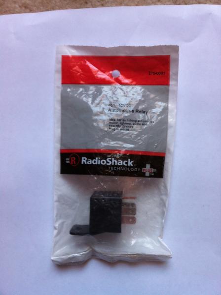

Step 9 - These relay is hard to find in auto part. There are some on ebay but used. I would not recommand to buy the used one. I would suggess you go any local auto part close to you and buy the one like this which I bought from Radio Shack and modify it

Step 10 - Take a look at closely the original relay circuit in step 8. Use solder iron to solder the diode 1N5401 between terminal 85 & 86 of standard relay. See the black standard relay had been modified with diode 1N5401 below. Don't bend the diode to the site what I did below because it will get stuck and will not fit the relay into blower motor what I did mistake. Bend the diode to oppisite site.

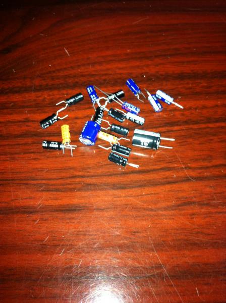

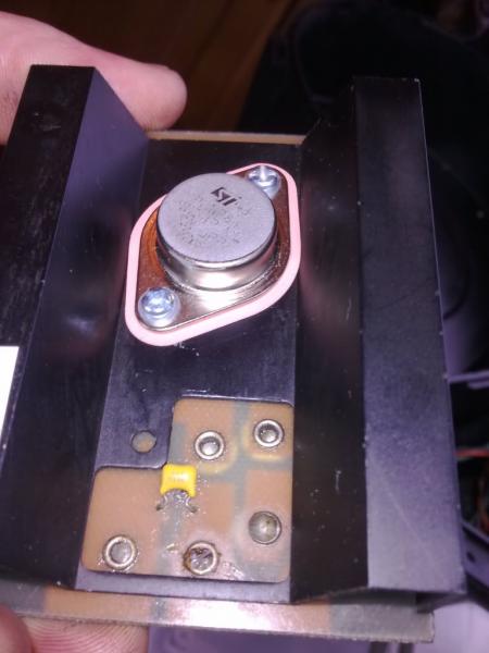

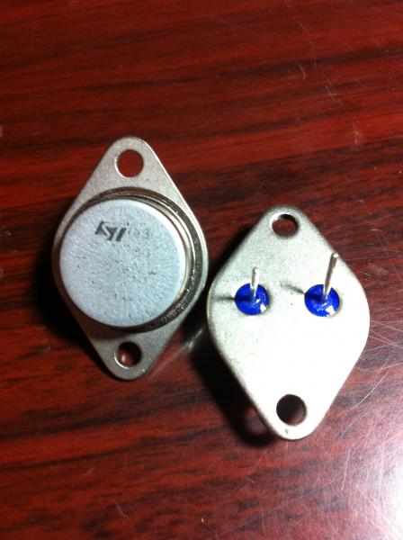

Step 11 - I heard many people complaint about darlington transistor in circuit board of blower motor go bad by the time with some reason like water leak in the motor... Once we take a part blower motor out, all the hard works has been done so far, I would recommand rebuild completely the main circuit of blower motor because all the electronic components supply for this circuit is very cheap.
Components list:
1/ Darlington transistor: 2N6284
2/ Diode : 1N5401
3/ diode : 1N4148
4/ Tatalium Polarize capacitor: 22uF 16v
5/ Resistor: 68 ohms 5% tolerance
6/ Ceramic capacitor: A1C/103M that mean 0.01uF ceramic capacitor
all these components you can buy fom Radio Shack or you can order from Jameco Electronic. Here is link:2N6284: ST MICRO: ICs & Semiconductors
Attached Thumbnails XJ40 - Rebuild blowers motor not working-047.jpg   XJ40 - Rebuild blowers motor not working-033.jpg   XJ40 - Rebuild blowers motor not working-038.jpg   XJ40 - Rebuild blowers motor not working-035.jpg   XJ40 - Rebuild blowers motor not working-031.jpg

Zenidial,
What is the part number on the relay you found at Radio Shack?
Do both relays need to be replaced with modified relay's?

Here is the main circuit board of blower motor.
Attached Thumbnails XJ40 - Rebuild blowers motor not working-073.jpg   XJ40 - Rebuild blowers motor not working-075.jpg   XJ40 - Rebuild blowers motor not working-079.jpg

Rob Evenson,
the part# 275-0001 at Radio Shack.
I would like to replace for both relays because the internal diode of original relay is going to be bad by time. Those original diode is very smaller and with more than 10years, so you never know what is going on? Since you pull out the blower motor, Why we don't put the new one for another 10 years.

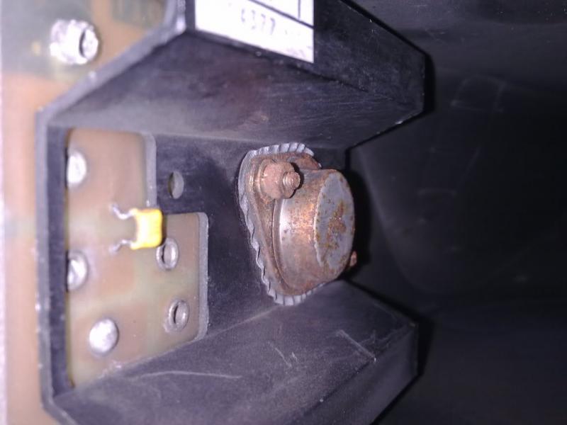

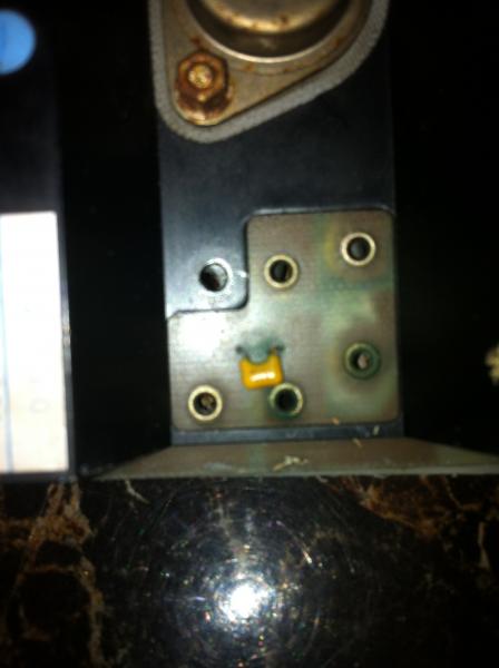

Step 12 - Now, you need solder iron, solder wick for unsolder all old components, and then replace them all with new components.
Here is some pics for old corrosion transistor......
Before:
After:
Before :
After:
Attached Thumbnails XJ40 - Rebuild blowers motor not working-22102011318.jpg   XJ40 - Rebuild blowers motor not working-25102011340.jpg
