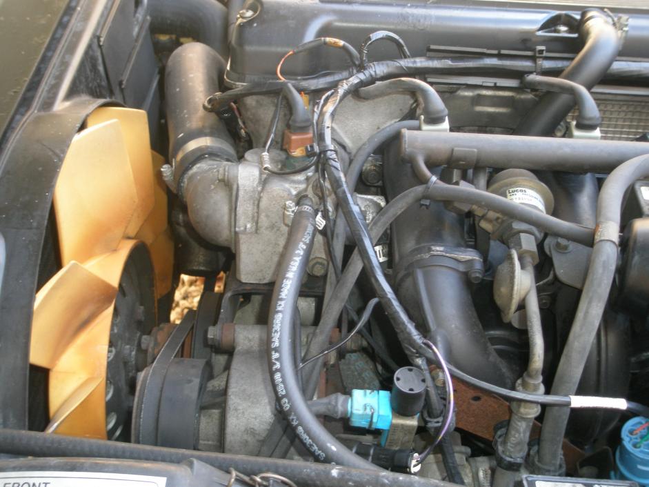

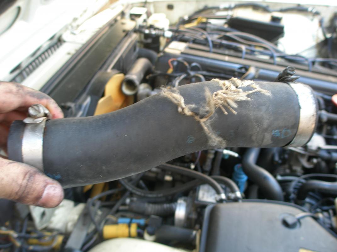

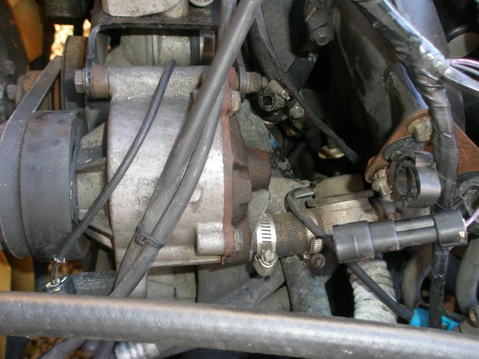

I didnt even realized that there was a water hose down there, until of course it got busted.
I am going to attach a picture so you could see it better.
What I need to remove to get to that hose?
Please tell me I dont have to remove the all intake manifold, to get access to replace that hose.
Since I going to be there I will make sure I replace all hoses if there is any more down there, to avoid this hassle.
If someone has done this job, let me know how to tackle. I dont want take parts apart that dont need it to be.
The hose is towards the front of the engine, if I am not mistaken it is attached to the water pump,or the thermostate housing.
My jaguar is 1992, xj6 soveraing
thanks in advance.

to add a footnote, the hose is hoocked up to the water pump, not to the thermostate housing. it seems that, what I need to remove is the thermostate housing, to make some way to remove or replace the hose that got busted.
Am I in the right direction?

I had to do mine in the parking lot at work and it was a pain in the ****. Small hands help, but it can be done without a tear down. I just pulled the vac and electrical connectors off and out of the way so I would break them and went at it from the top side. It will not be quick and patience will be required.

Thanks for your input, yeah, I managed to get it out of there without tearing apart, the thermostate housing, I did have to move the air filter, and some vacumm lines.
