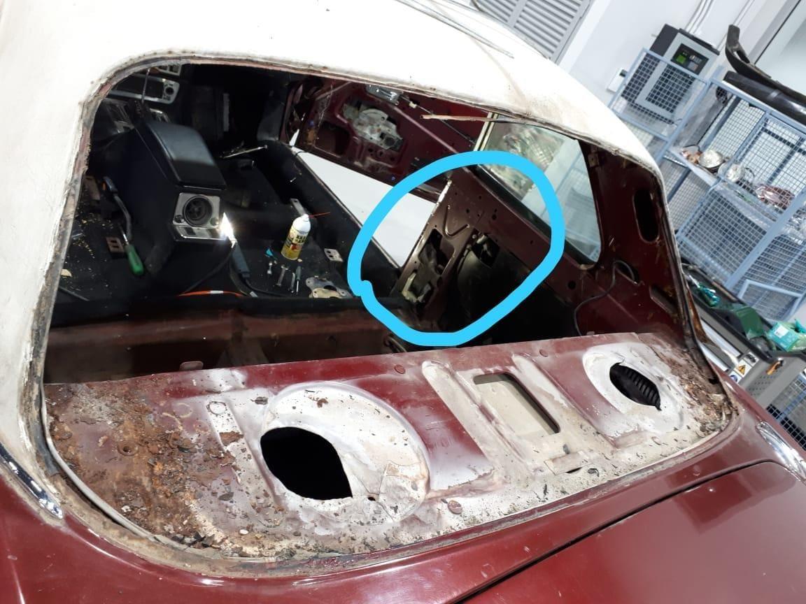

My name by the way is Hosam. Okay back to the Jack.will start from the body.The body was made naked. And this is to search for rust.The weakest area in these cars is the driver and passenger floor and the side sills.Complete rust.Pus the rear fender arcs.And under the fuel tanks covers.

Yes the leaper is missing and it is gold color.Plus the fender leaper emblem badges are gold leapers.As you see the rear dash is rusty due to bad design.The have two holes with hoses to drain water.And they are blocked.And made severe rust in rear dash.

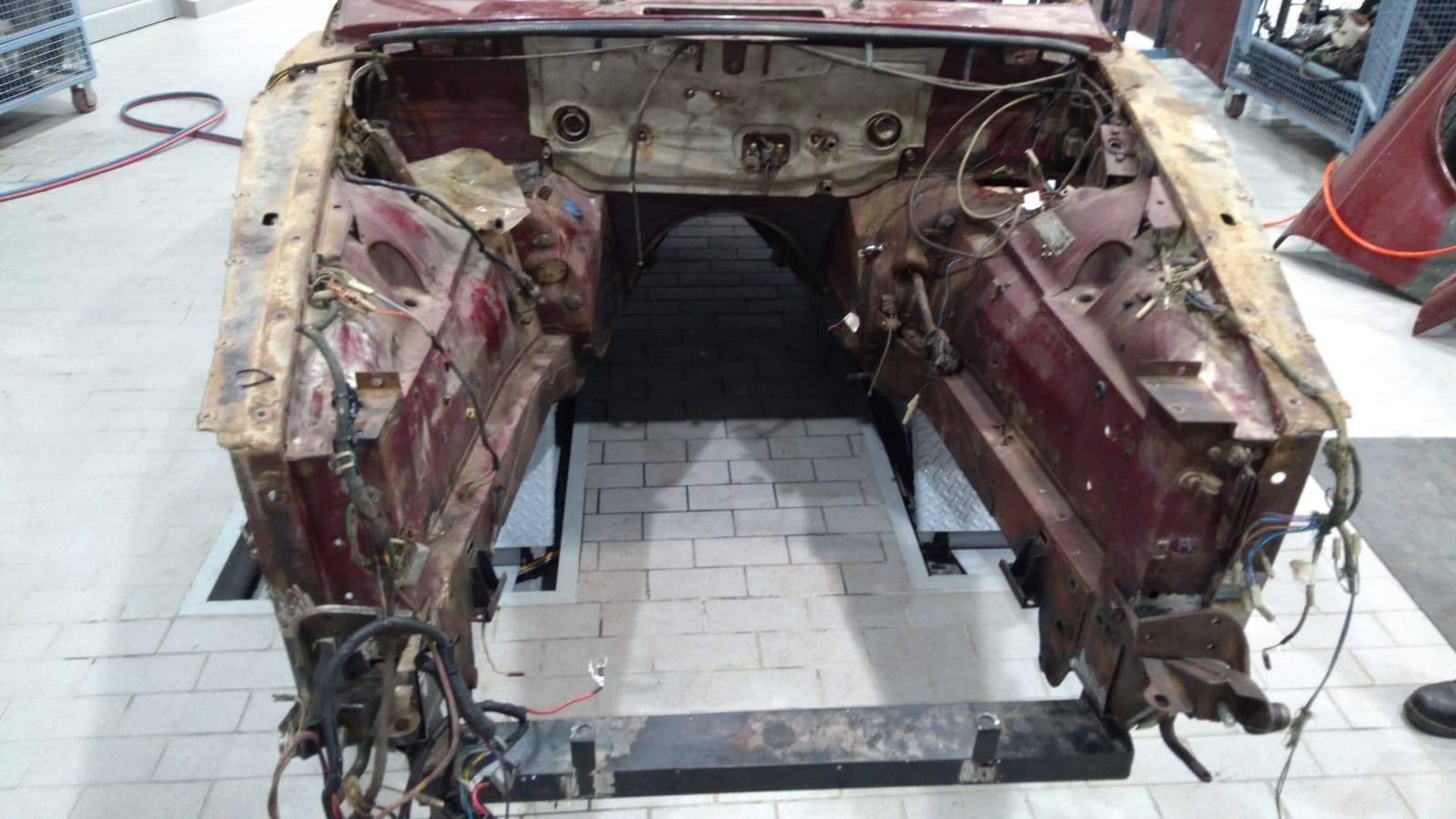

Okay now more pictures about stripping out..

Regarding the wiring harnesses.I am going to remove all and discard.I will use wiring harness from Kiwkwire. The LS engine came with its computer and wiring harness.So the Jack will be equipped completely with new wiring harness.

The most important in such restoration and the age of the car is to change the wiring because it become like fretting.And cause ground and fire.And possible electrical issues.The other things is the rust.Which is i call the hidden cancer.And when we strip the car more and more searches i am sure we will fine rust and corrosion.
