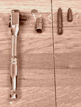

So, could you send me a photo of the screw extraction tool you rigged up to do that task so I can make one of my own without totally guessing at what it should be?

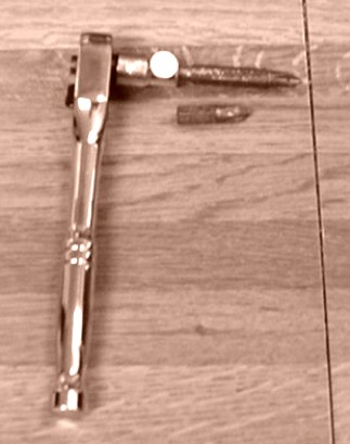

here's what I used to remove that screw under the Opticell housing, located at 6:00 o'clock:
small ratchet > 1/4" socket > extended phillips bit > magnet on the socket to prevent losing the parts.
(the small phillips bit just in case you run out of space when backing the screw, it's a tight fit).
