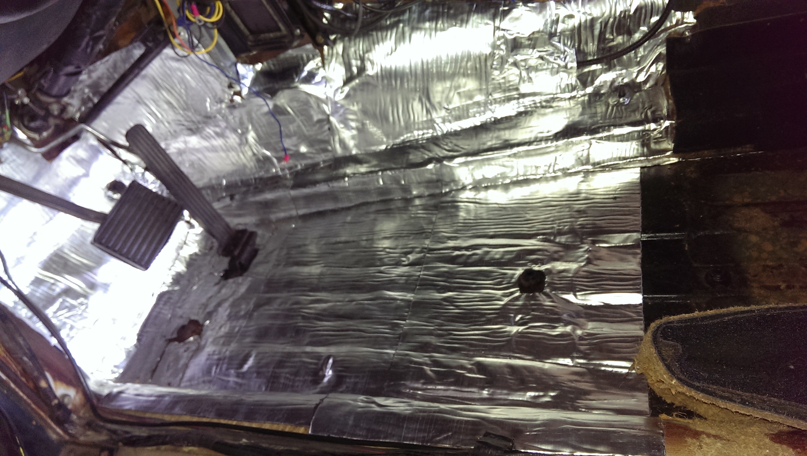

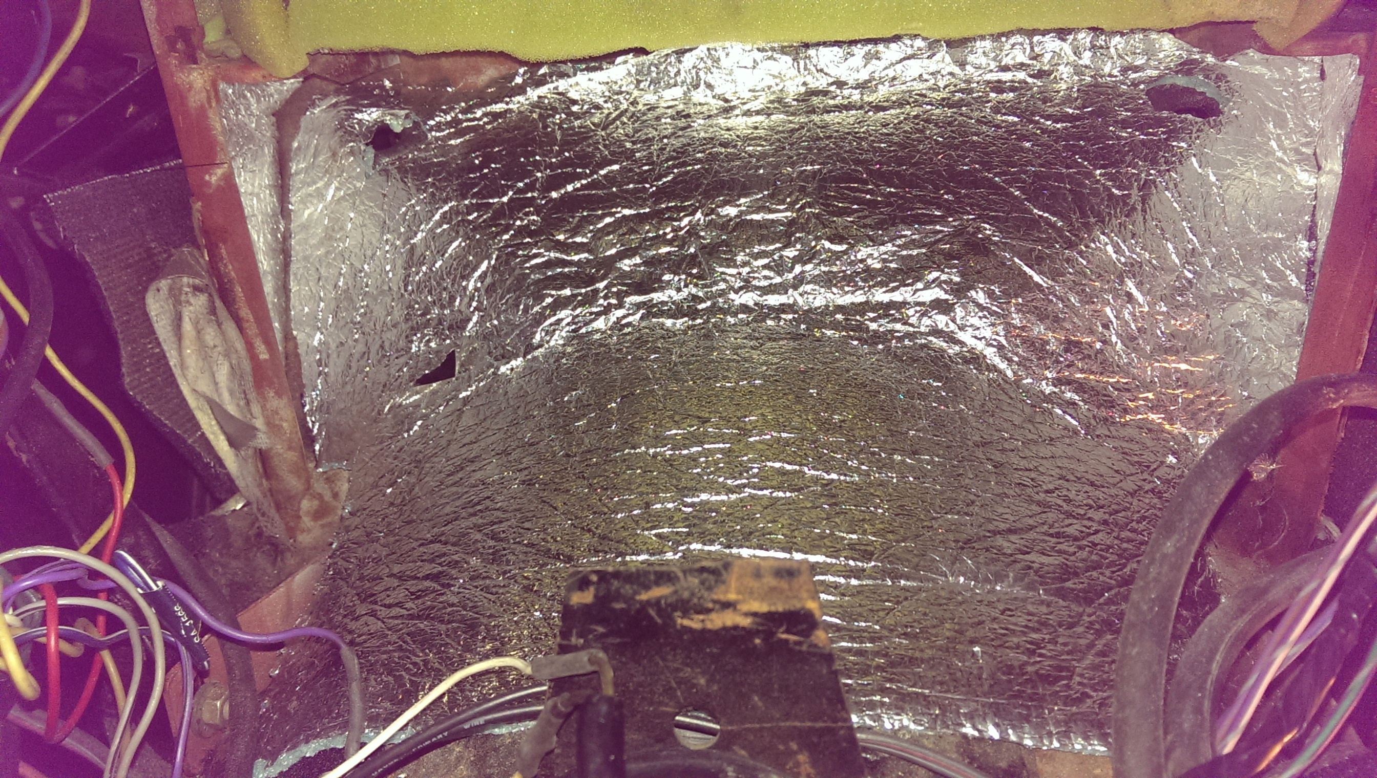

In my quest for colder cabin temps, I just added more insulation under the AC evaporator. That upper trans area does create a lot of heat.
Infrared gun showed temps there as 88F after driving 15 miles...after insulation it was 63F.
My car already has complete insulation added from the top of the gas pedal all the way to the rear of the package tray, under the headliner and inside the doors.
Attached Thumbnails 86 DD6 console getting hot-insulation-under-evaporator.jpg   86 DD6 console getting hot-imag1678.jpg

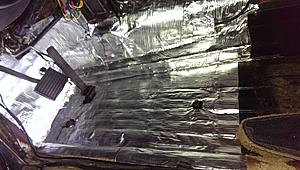

When Nix's floors got all that work in 2014-2015 I insulated everything I could access with this stuff, Roger, and it made a Huge difference, especially with noise.
While the tunnel is empty this winter, I'll clean it up and insulate the Underside too as you have done.
Great stuff that B-Quite insulation; easy to work with, sticks to almost Anything!
