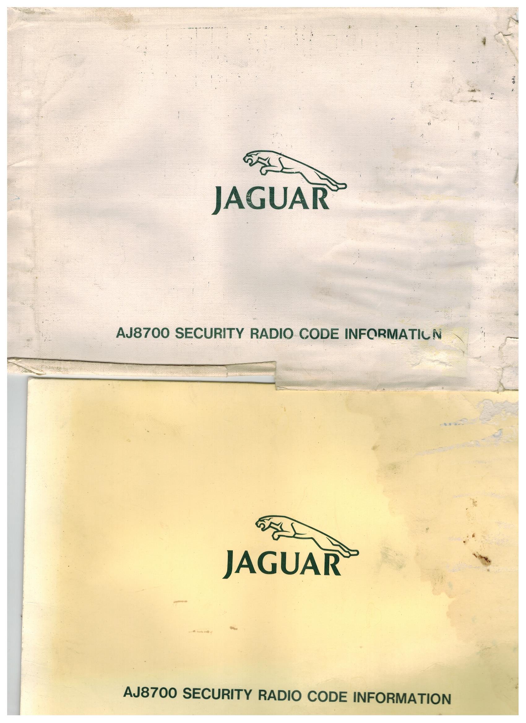

Your car should have the AJ8700 Security Radio...
When it was new, it came with an envelope with instructions on how to program it, a cool card to keep that had the security code, and the stickers that you could put on the outside of the car window to show the radio was a coded radio.
The instructions do call for a 5 digit code.
Occasionally you can find the code written in the owner's manual, or on top of the radio..
I've seen plenty of these radios that would no longer accept the code.
Chances are the dealership gave you a universal code that would have originally worked on all of the radios..

It's a 5 digit code you need.
I have a friend at Jaguar- if you get me the radio serial number (from the back of the unit) I can get the 5 digit code for you.
Send me a PM with the serial number info. That's all I think that is needed...
