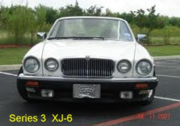

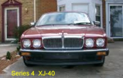

hi, here's some info.:
the Series 3 XJ-6 body with a 4.2 liter engine was shipped to the USA until 1987.
Jaguar kept making the Series 3 body until 1992 but only with a V12 engine and only shipped it to other countries, not USA due to emissions regulations.
in 1988, the new XJ-40 body style arrived in the USA with a 4.0 liter engine.
the 1988 has 4 round headlamps just like the Series 3, but they are arranged differently. Pictures below.
if it was a Series 3, it will have a General Motors Saginaw power steering pump, so hoses and fittings can be found easily. I am not sure about the XJ-40 pump.
as to the color of the fluid, maybe it has a store-brand fluid which is not red as it should be.
