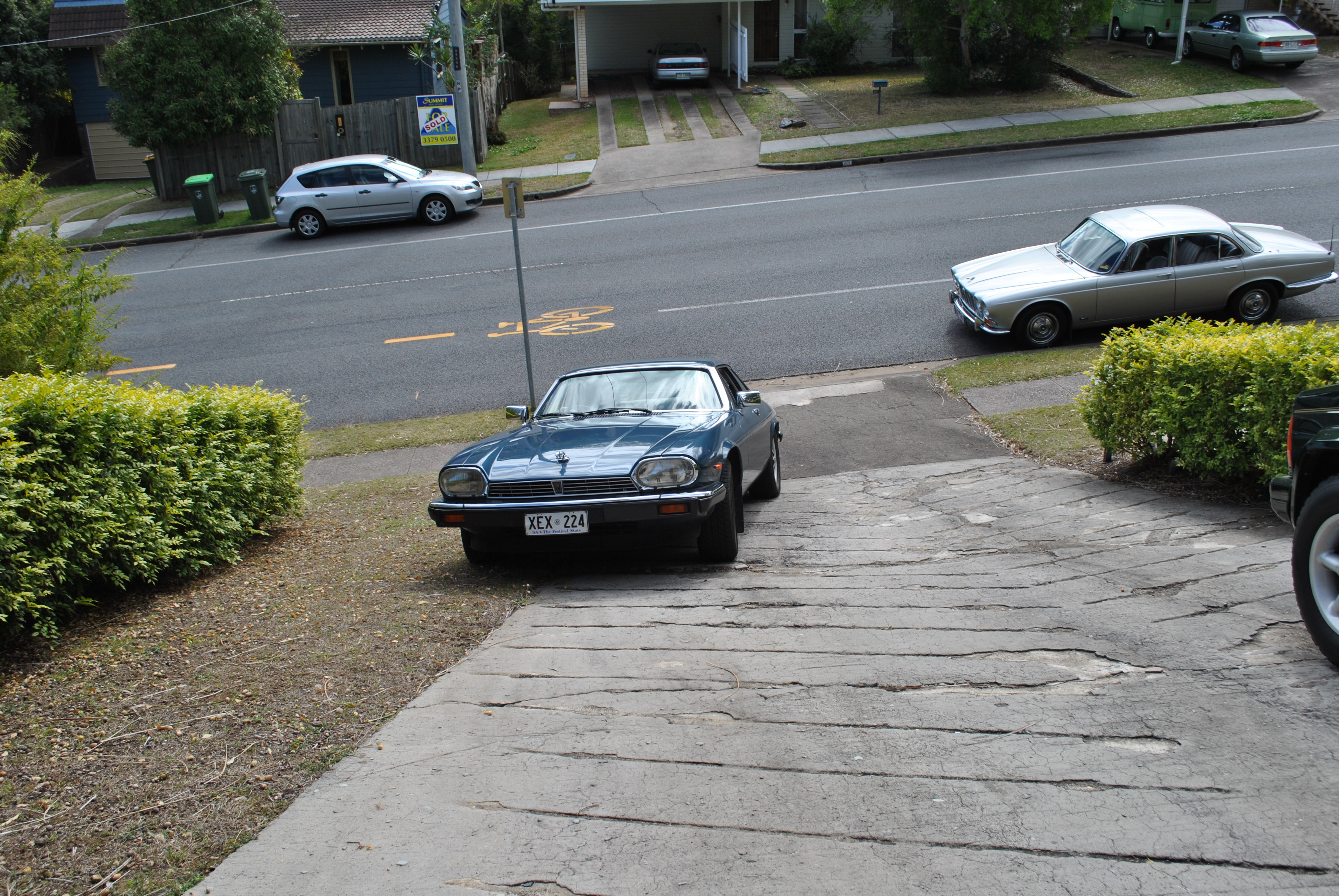

I thought I had it all sorted until today, driving home from work I got to the freeway and no power. By the time I got home it was cutting in and out so much I had to line up the garage door from across the street and get a run up to get up the hill,just made it in second try. I really need a flat drive way.
Need to sort this by next weekend for a forum run west of Brisbane or I'll be taking two wheels instead.
After some food and a couple of glasses of red I thought I might check the dwell angle, was set to 34 last week(book says 35 +/- 3), meter is reading 56.4.
from that I am assuming the points gap has closed up.
