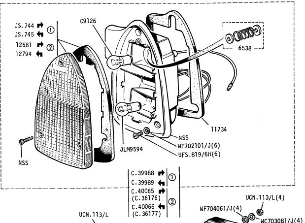

A part nuiber would help to no end, i looked in my parts manual and for the later triangle lights, the lens and gasket behind it have teh same number, i assume that means they come together, but the light assembly and and body gasket both say NSS, no clue what that means, maybe not sold separately! i know i have done nothing at all to answer your question, but most of the time i have the best luck finding parts if i have the number..

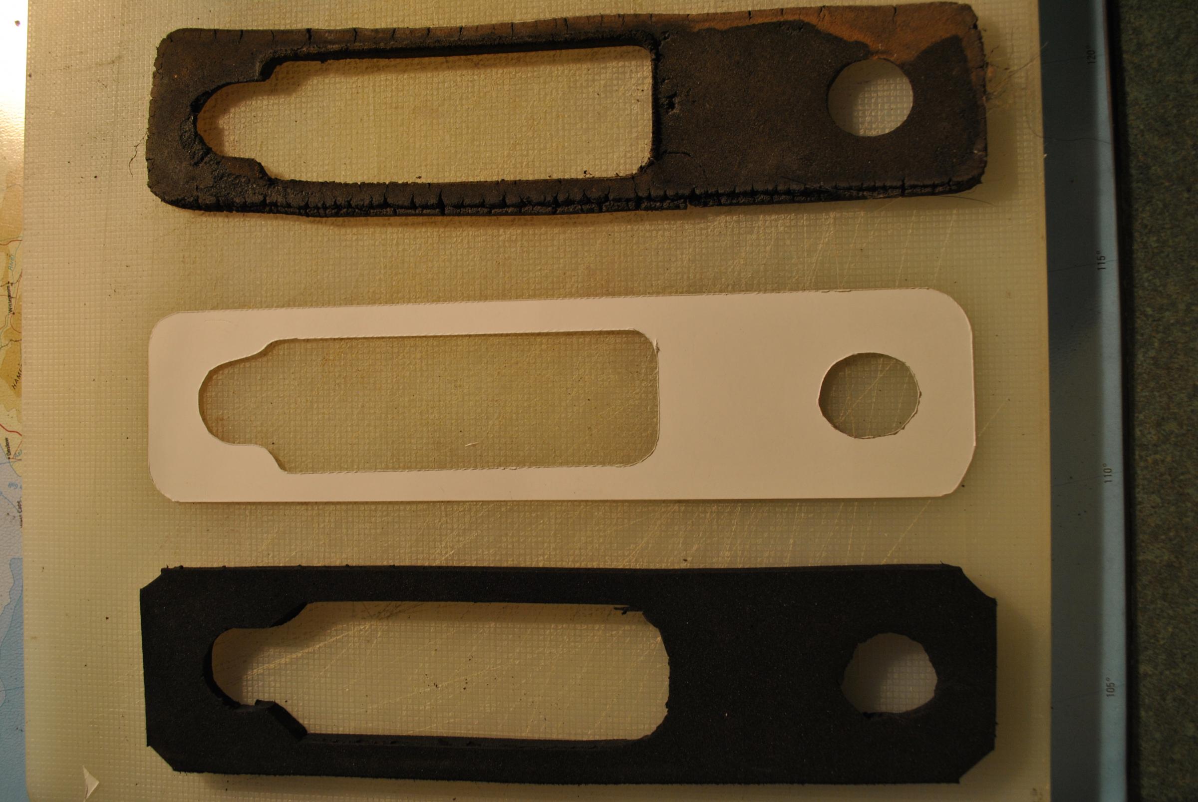

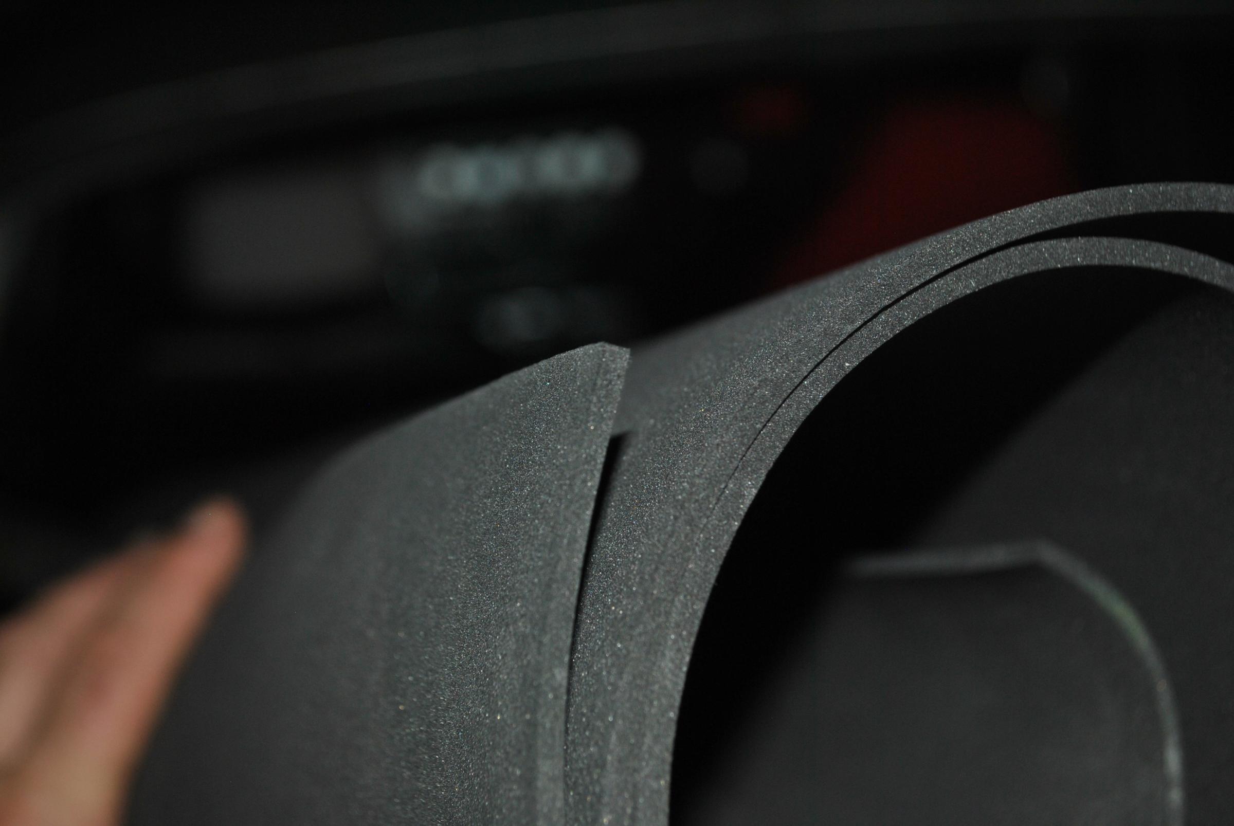

I have lights out at the moment and will be hand cutting new ones from a sheet of 3.5mm gasket foam. $12 for a 750 x 1200 sheet at the local rubber supplier.Clark Rubber - Leaders in Foam, Rubber and Swimming Pools
I know it works as I use it at work all the time for oil seals (not high pressure)and chilled water insulation.
I'll post back how it goes in a few days when I get around to cutting them. I will also be buying some 1.5mm rubber tomorrow to make gaskets for the door handles.
If I can't get what I need for the door handles I will go a tyre shop and pick up an old inner tube.

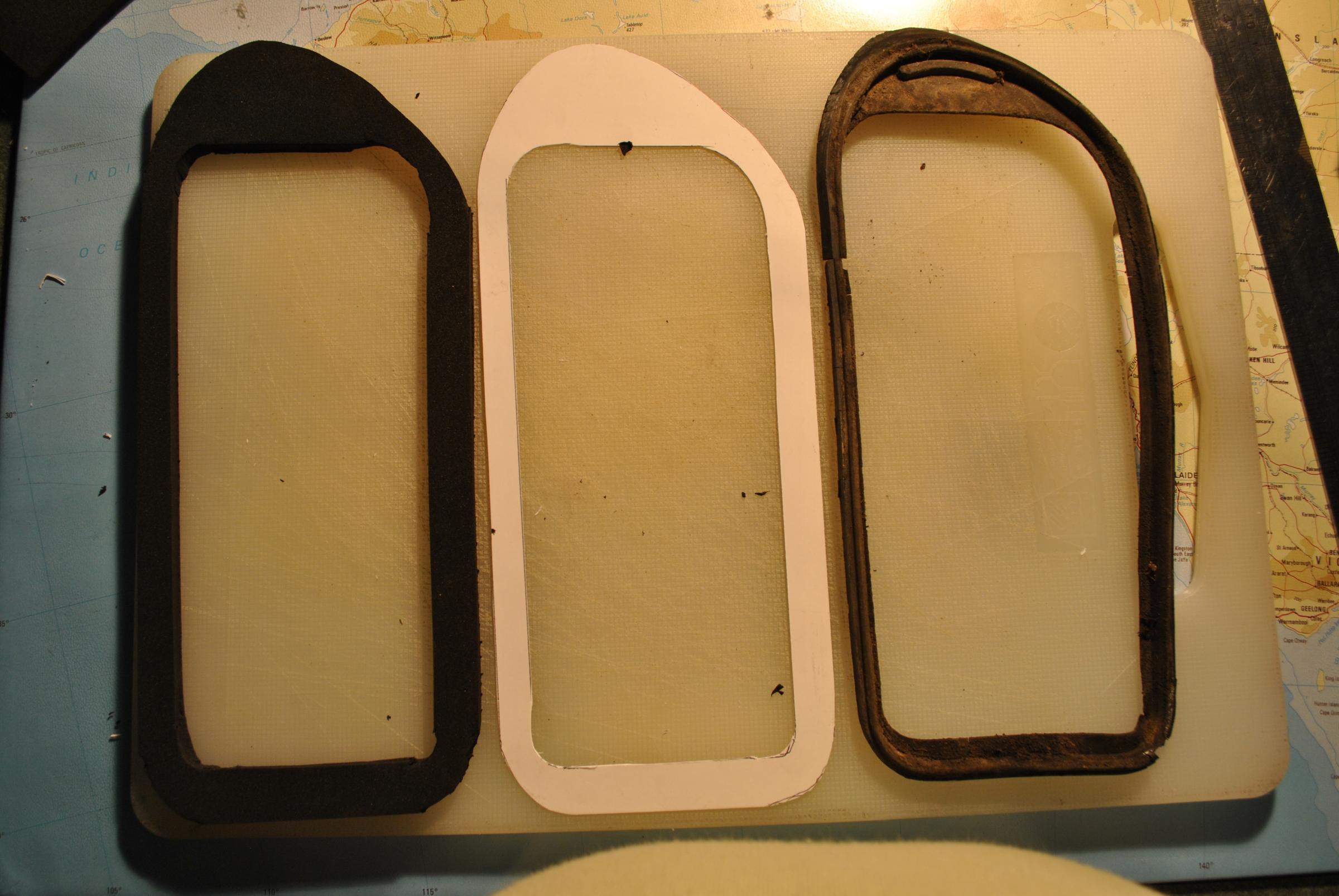

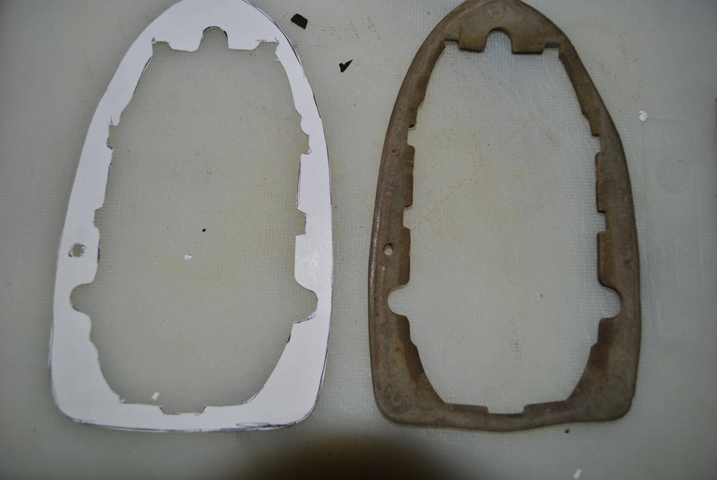

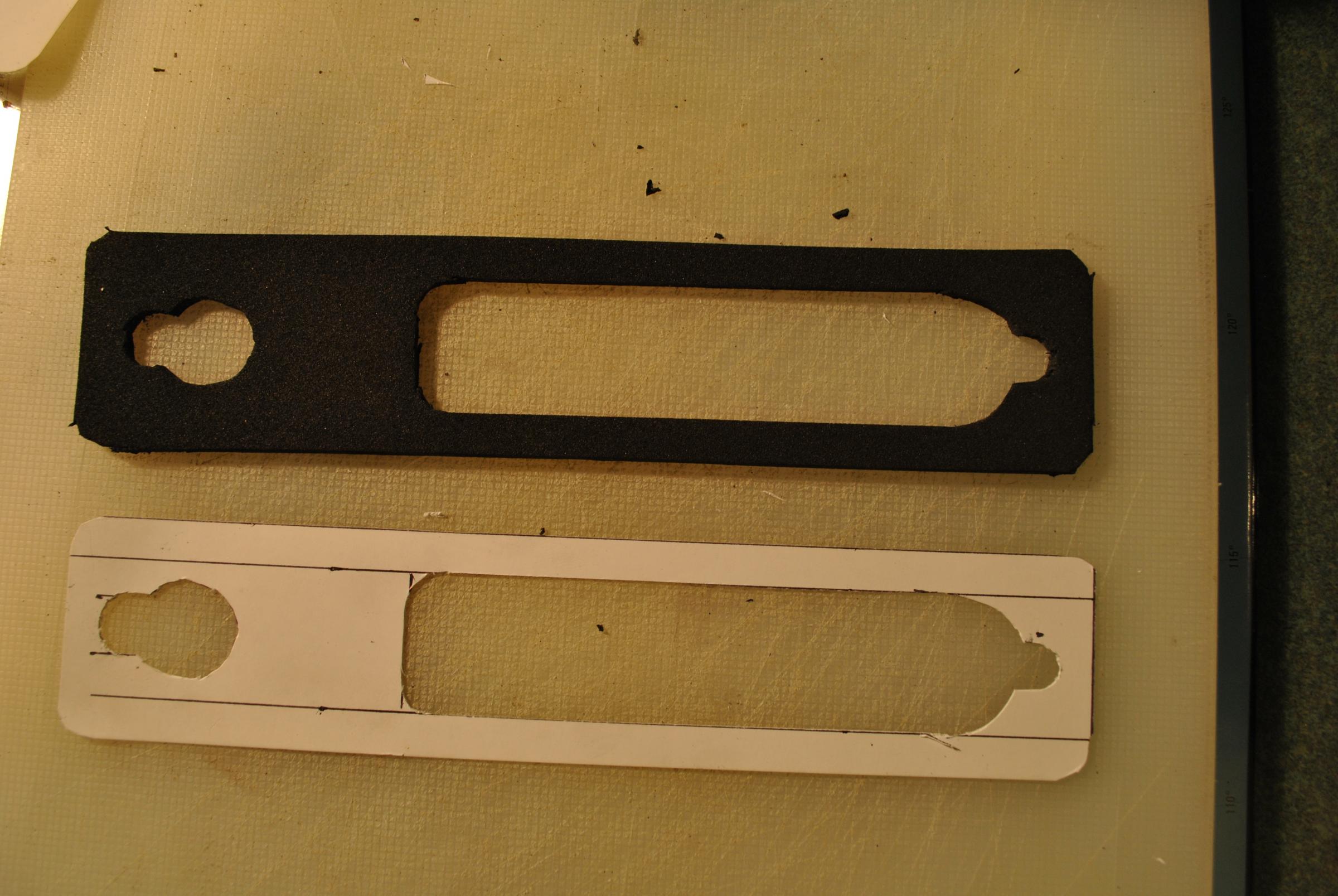

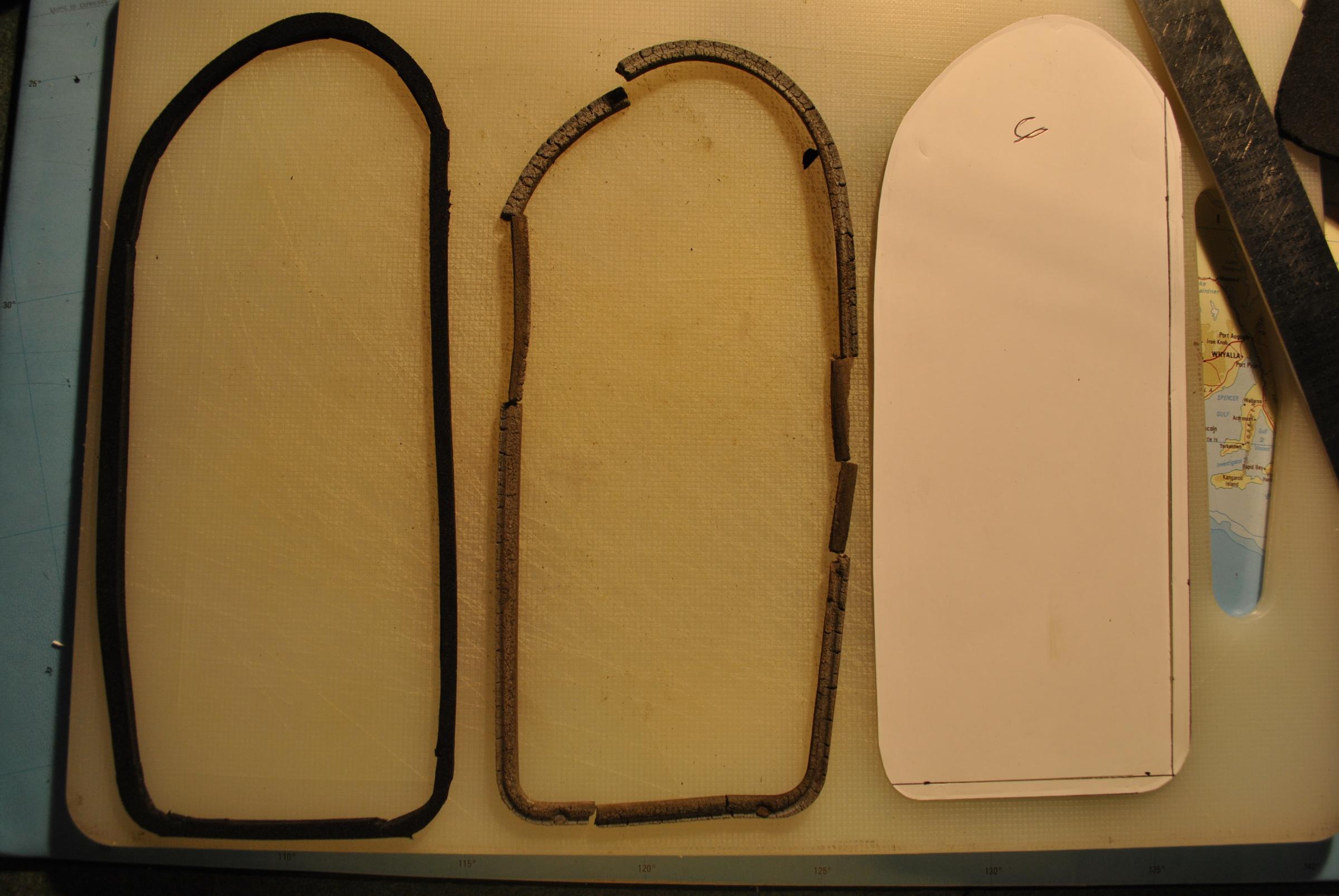

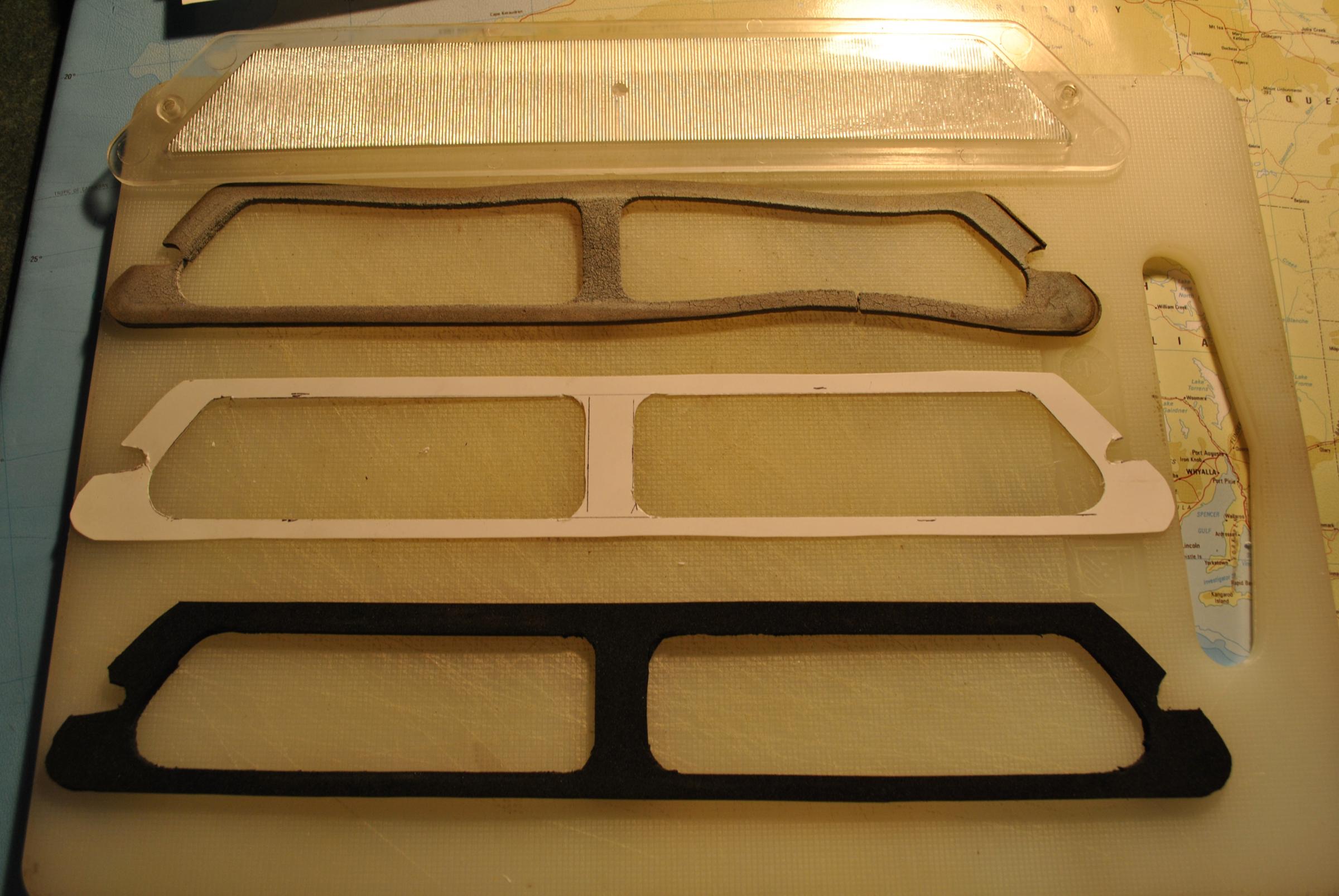

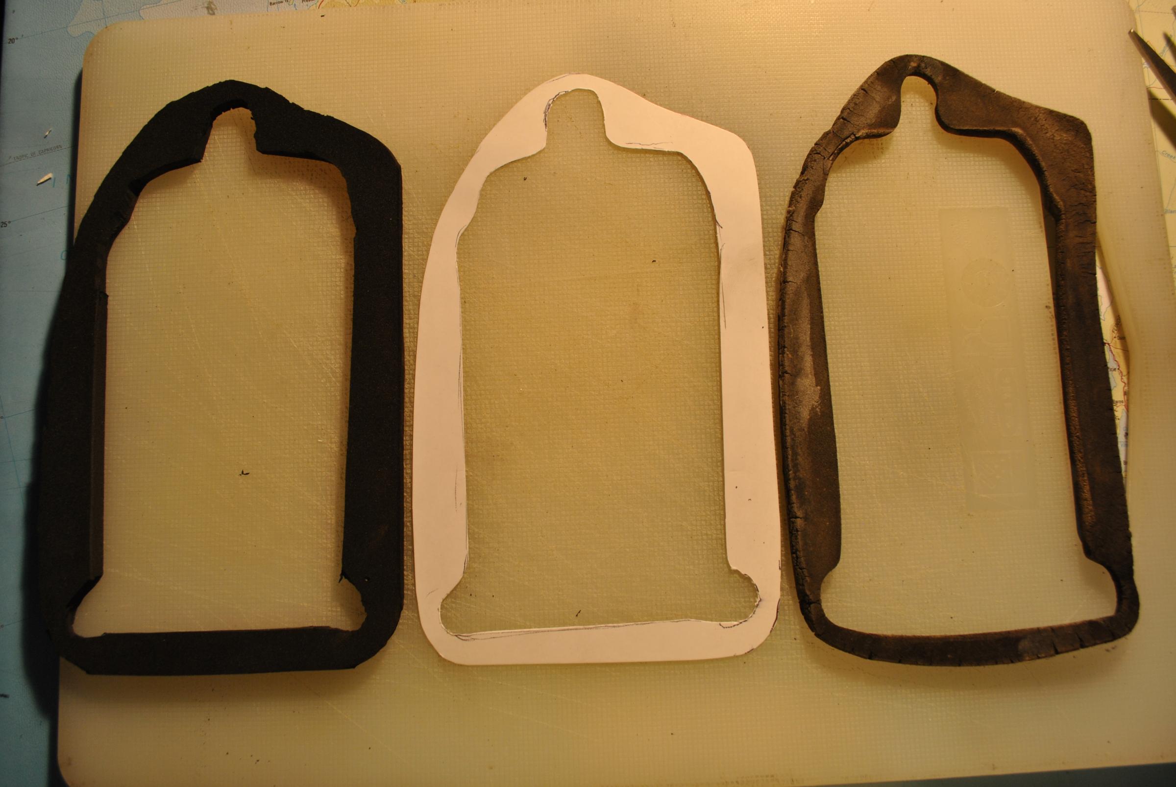

I made gaskets for the tail light lenses today,it took about 15 minutes to hand cut the template and two gaskets. First I made a cardboard template off the original part, then used the template to cut the gasket. The right is the same as the left, only turned over.
I will be making the tail light to body gaskets, reversing light, number plate light and front indicators gaskets over the next few days.

The part number I have for the light to body gasket is 11734

I'm off to the rubber shop again today to get thicker stuff for the gaskets, only realised they were thicker when I started making them yesterday.
Old Feb 7, 2015 | 03:11 AM
o1xjr's Avatar
Posts: 28,386
Likes: 6,340

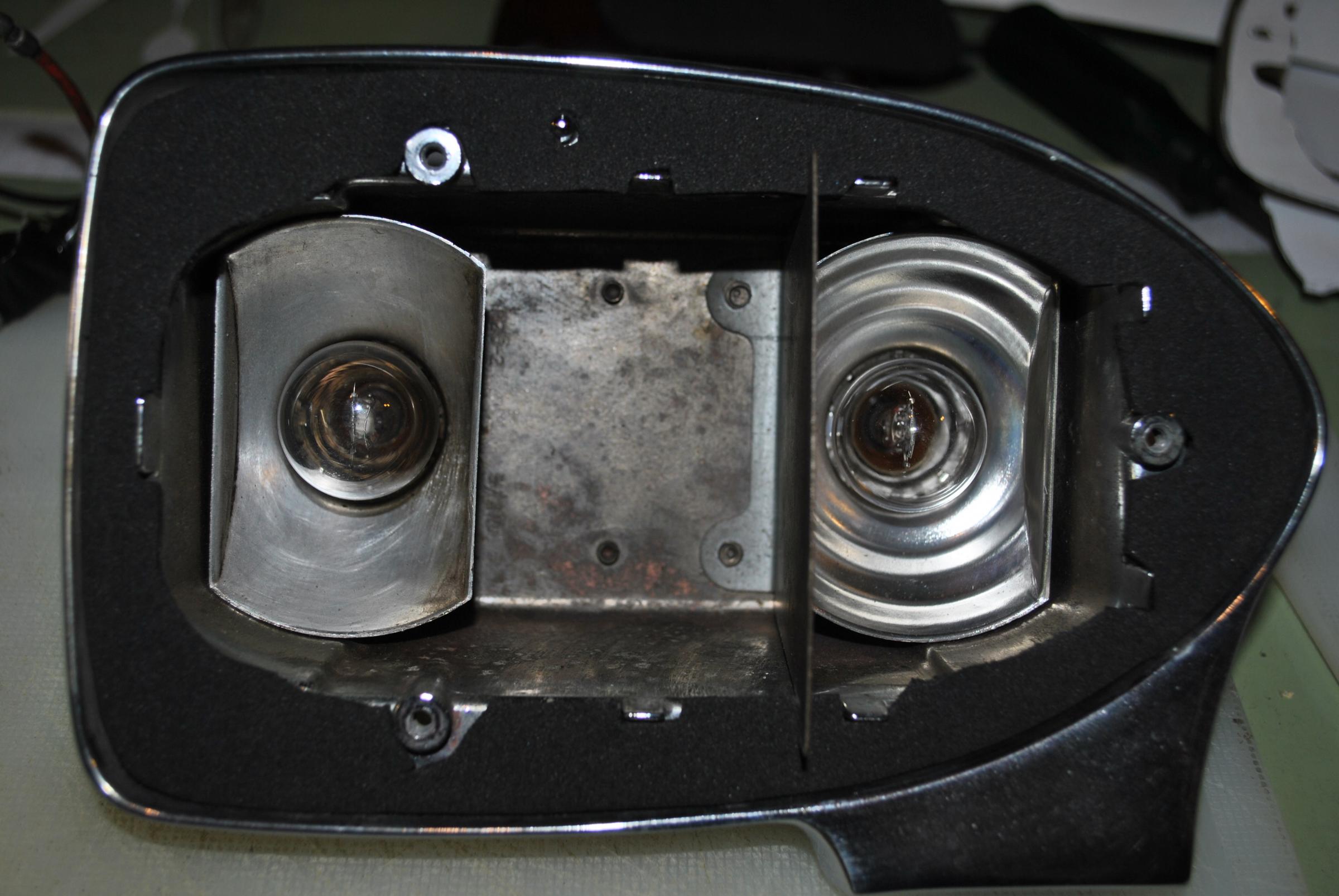

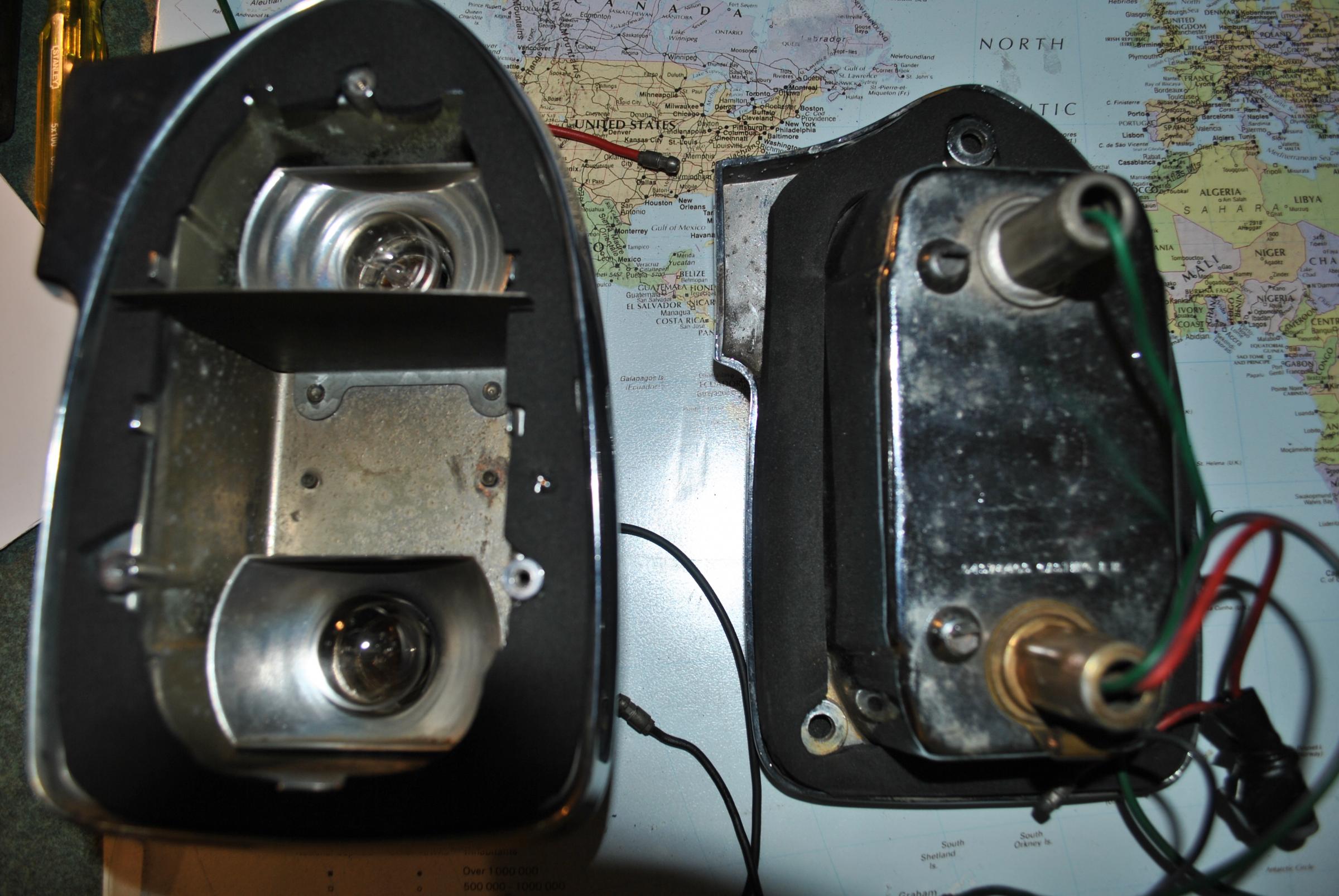

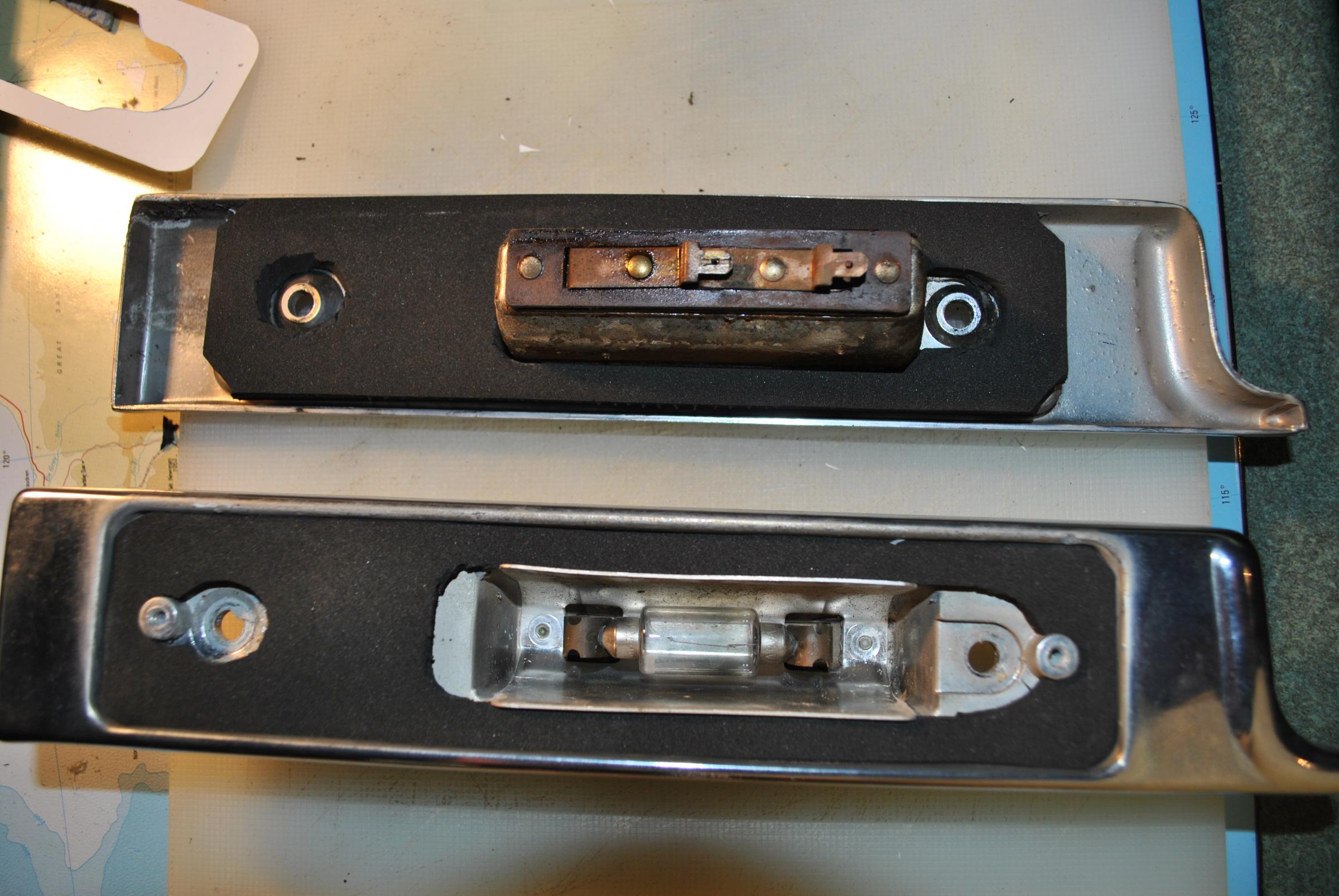

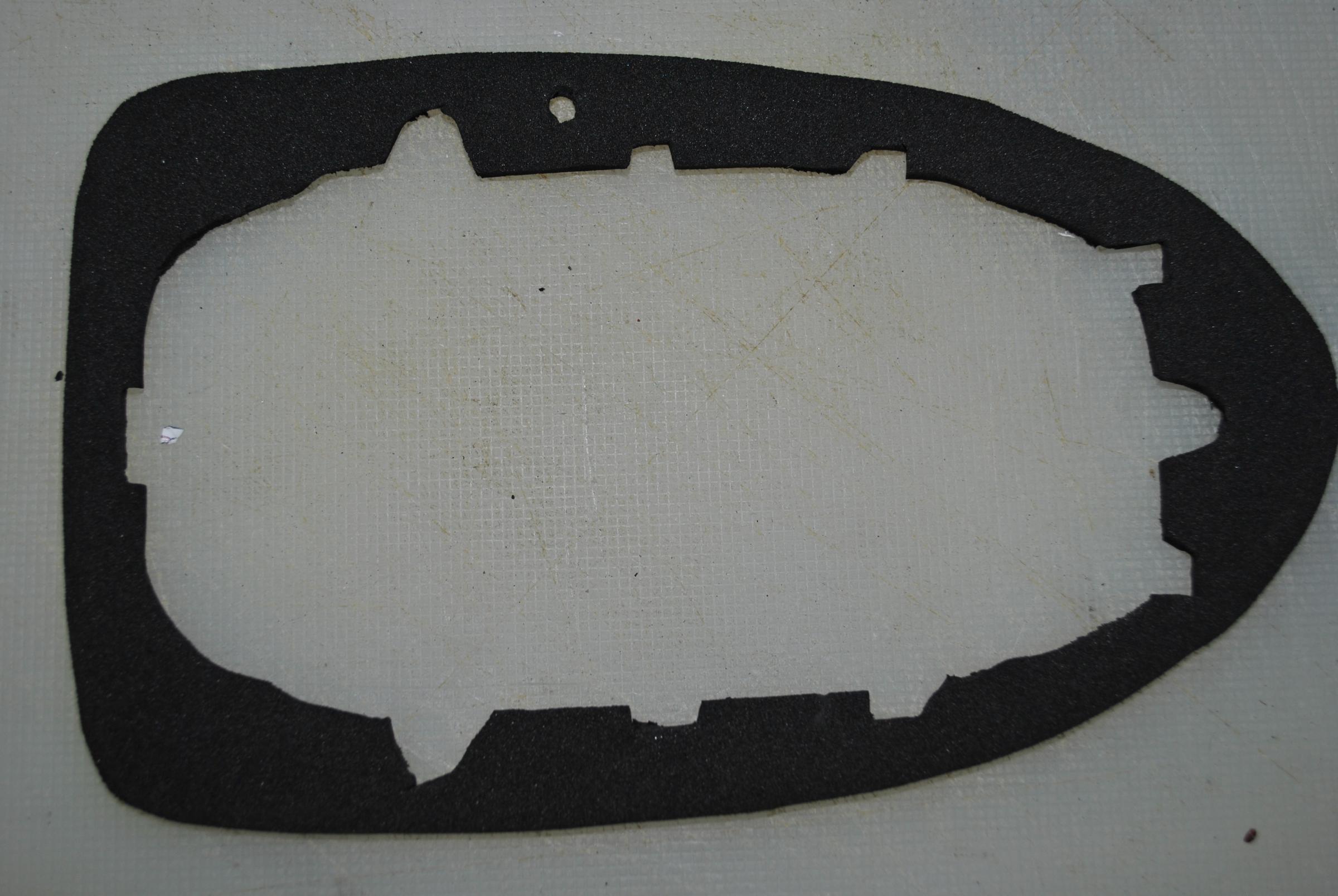

Default Here is the full set.
It cost me $26 for the materials, and took about 4 hours.(but I already had the lights removed from the car)
They don't look pretty but are functional and I will be the only one to see them. Probably a sizeable saving as one gasket for the rego plate light was going to cost me $21 plus postage.
Body gaskets-dsc_1418.jpgBody gaskets-dsc_1419.jpgBody gaskets-dsc_1420.jpgBody gaskets-dsc_1421.jpgBody gaskets-dsc_1422.jpgBody gaskets-dsc_1423.jpgBody gaskets-dsc_1424.jpgBody gaskets-dsc_1425.jpgBody gaskets-dsc_1426.jpg
