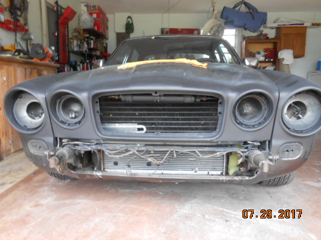

I am trying to remove the Bumper Impact Strut to no avail.
I can turn the 17mm nut that holds it in place for maybe about 5 turns, then the complete strut turns as I turn the nut.
Since the nut turns the whole strut,I locked the wrench in place on the nut and
and turned the strut about 50 turns but the nut does not come off.
It's as if the inner part of the strut where the stud is located is turning as I turn the nut.
Any ideas on how to remove the impact strut?
Can I drill a hole through the area where the strut is located to lock it in place and see if that helps?
Anyone had the same issue as me? and what did you do to remove the strut?

OK. So holding the nut with a wrench, the strut turns inside the cavity where it is located.
I am assuming that the strut is made up of two pieces, the smaller of which projects to the front of the car. The larger diameter piece i would also assume is where the absorbent material is and also the stud to which the nut is screwed on.
I am also assuming that this larger diameter portion is turning but the stud is not or only the smaller(visible) portion is turning within the larger piece. Not sure.
The reason I want to remove them is that I am stripping down the car to repaint and the right strut is about 1/4 inch shorter than the left so the bumper looks off kilter.
SUCCESS! I removed the impact struts today.
Since every thing was turning with the nut, I drilled a hole through the bottom of the cavity but not through the strut. I bought a 1/4 inch bit that has a flat tip.
I carefully drilled it then placed a bolt in the hole and used my floor jack to push the bolt to lock the strut in place. I was then able to remove the nut.
