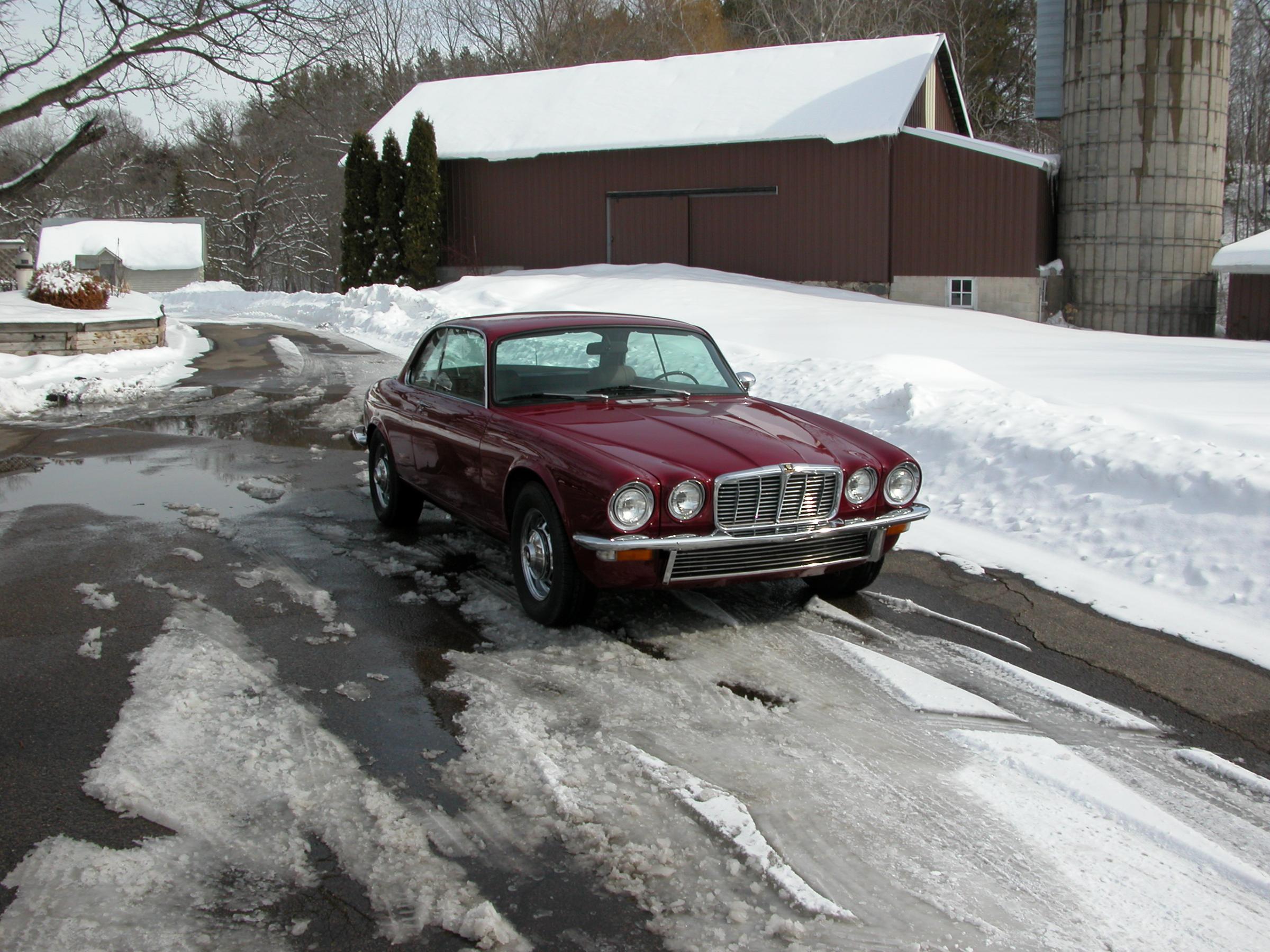

I just finished installing euro bumpers on my 1975 series 2. It is relativly easy. The hard part is I had to settle for a less than perfect front bumper. Very rusty. I am still looking for a nice part. See attachement

Looks great from that distance!

Really nice ride by the way!
