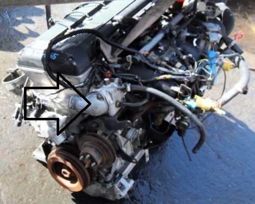

And do you know exactly where the thermostat is in these cars? series 3
They are right under the thermostat cover that the arrow is pointing to in the picture.
I just grabbed a straight six engine picture but I am sure yours won't vary by much.
Not sure about access since I don't have a six.
Also, are you absolutely sure your coolant is topped off in the radiator? Not the overflow tank, but the radiator.
Other problems could be valves that allow engine coolant to enter the cabin heat radiator binding, not actuating. I am not sure there are any in your car, but what little I know about Jaguar, they over engineer. If they can put a valve in, they will.
Also, on lots of cars there is an air blend door that flaps back and forth under your dash. Turn on the air conditioning it flaps closed the heat side and vice versa. If you are stuck on the "summer" side, you are up a creek until you get it freed up or get an actuator.
An easy trick is to warm the car as best you can (take a drive) and turn the heat on full. When back home, grab the heater (coolant) hoses that go into the firewall and check if they are close to being very warm - both in and out hoses. If both are warm the air flapper thingie may be stuck.
