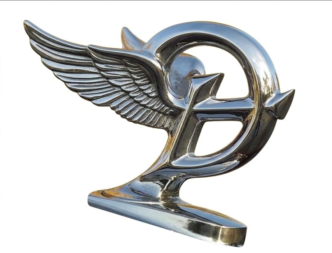

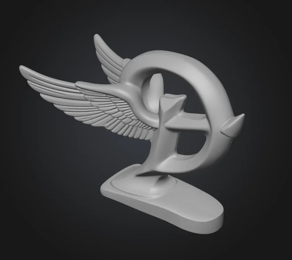

Dear Daimler Enthusiasts, I hope you will indulge this small heresy of mine in creating a bonnet mascot of my own design, fully aware that such departures from factory practice are not to every taste.
Alas, my 1992 Daimler Double Six was never intended to bear one, and all those previously offered by Daimler have never enticed me. I therefore decided to develop one myself using free mesh software, guided step by step by Grok AI. I now asked a sculptor to realise it in pewter, finished to a mirror polish, from my 3D model. The intention is to install it in place of the Daimler badge upon the radiator, as with my Photoshop rendering. I attach a few images to illustrate the design and its intended character but bear in mind that I will have to redesign the mounting as the A.I. took input from the leaping jaguar base.

Why Not - Looks Very Elegant!

I like it too! Elegant and classic, and more graceful than the original Daimler ornaments.

I think that is completely fabulous! Very well executed and the designers at Daimler should be very envious.

That's very similar to what was used on the early Daimler DS420 Limousines

@Jagboi64 I had, in fact, bought one of those original Daimler mascots and found it wanting.
Following an exchange with the Secretary of the Daimler and Lanchester Owners’ Club, a wonderful chap (*), we agreed that the vertical stroke of the “D”, particularly where it meets the airflow, appeared ungainly and the very low silhouette too, was somewhat inglorious for a marque as Daimler. I had also always preferred the twin wing design, as on Rolls Royce and Bentley mascots and I decided to use those ornaments as the basis of my design.I placed my Corniche and Continental nose to nose and found that, whilst the wing angle of the Spirit of Ecstasy was preferable, the plainer Bentley wing appeared more suitable for my Daimler “D” mascot idea.
I photographed the Daimler radiator “D” badge, then placed a sheet of plain coloured card behind the Rolls-Royce and Bentley mascots and took images from multiple angles. With GIMP I removed the backgrounds and prepared a series of initial bitmap files copy pasting the Daimler “D” onto the Bentley mascot. It didn't work as well as I hoped. I then tried to simply remove the central stroke of the “B” but, again, I didn't like it. The first model, I confess, was ghastly.
I had been using SuperGrok Heavy for idiot-proof, step-by-step guidance with Gimp when I thought of uploading the entire collection of these partial bitmap results into Grok itself and request it to generate a 3D rendering of the finished concept. It produced a very good approximation. I then asked Grok to transform those renderings into an .stl file for MeshLab, but here Grok failed miserably. So I relied, again, on Grok to deliver an idiot proof step by step guide on how to use the bitmap rendering in MeshLab which I eventually ended up doing manually.
When I finally obtained the .stl 3D model, I realised that the single vertical stroke of the “D” rather disappeared in the tighter wing angle of the Bentley wings.
In a final iteration I adopted the broader, more graceful wing spread of the Spirit of Ecstasy, together with her reduced contact point at the arms which is the end result that I published here. I then scaled it all down by 80% and I am waiting to see what the end result in pewter will look like.

I will donate the intellectual property and design to the Daimler and Lanchester Owners’ Club (DLOC). I am confident that they will allow club members to buy the 3D .stl file for use. But you would then still need to commission its realisation from a craftsman.
My preference would be to have it executed in polished 316 stainless steel, as the Bentley and Rolls Royce mascots. Unfortunately I have been unable to find anyone who can, at a reasonable price. Any help would be really welcome.
I found an artisan able to produce it in mirror polished pewter for 300 CAD, exclusive of taxes, import duties, and shipping. We are now considering how to attach it, whether a single bolt through the radiator Daimler badge housing or by metal bonding to that same housing. The base of my model will require reworking as the angle of the housing slants forward and is perfectly round. Anyway, anyone interested to place an order for the polished pewter version, with me, is welcome to do so, should I go ahead.
Louis Lejeune Ltd. would craft it in 316 steel but the cost is rather unfriendly ... Could anyone help me locate a craftsman able to produce it in 316 stainless steel at a reasonable price?

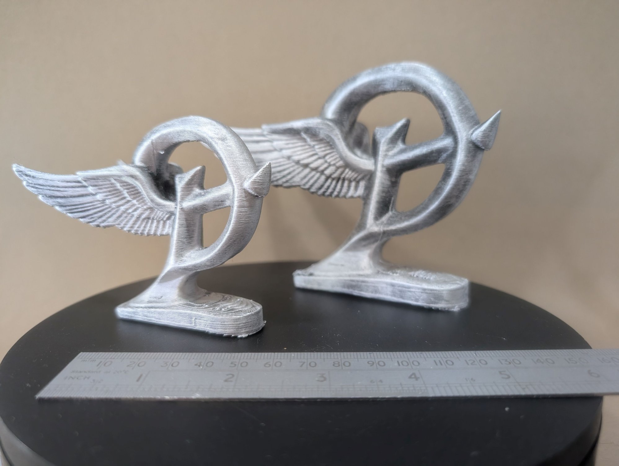

Update: The pewter option from Canada remains under consideration but I have not heard back for the 316 steel proposal, also from Canada. I have, however, spoken with a gentleman at Louis Lejeune who has kindly agreed to make a more competitive offer for the door bronze, chrome plated (CNC 30 micron) version and include the revised base, angle, and more pronounced feather detail into my design. I'll share the offer once I shall receive it. In the meantime I can share images of Lejeune initial 3D printed models.
