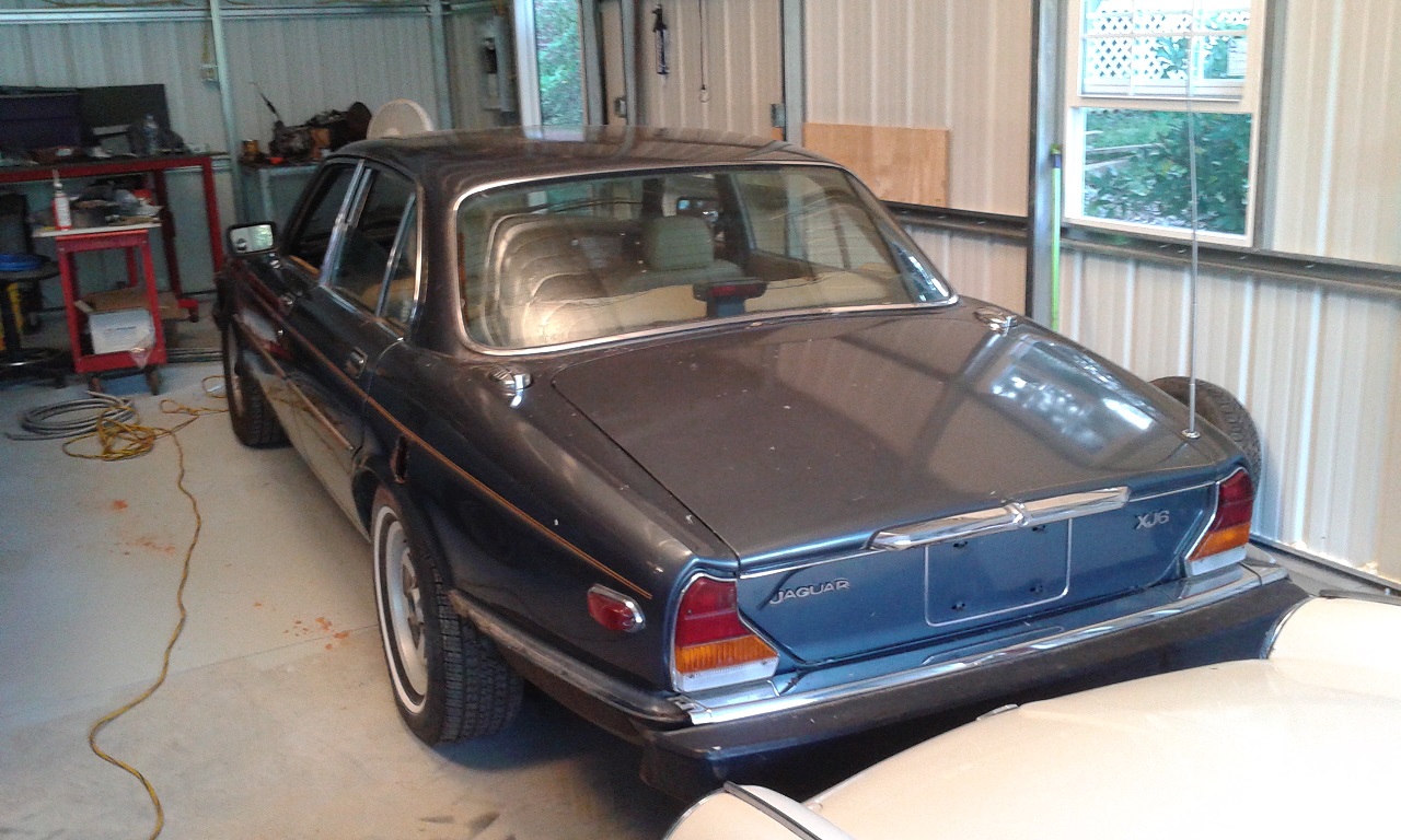

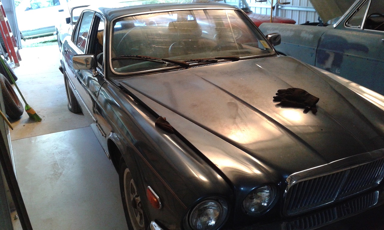

I dragged Blue Six (as I so dubbed it) home last weekend. After getting the car out of the former owners junk-filled shed I discovered a 3 inch square hole in the left rear quarter under the fuel fill. I know that's a common area for rust and a friend of mine has already stated he has a repair patch for that. The left tank is toast anyway but the PO gave me an extra tank to replace it. The rest of the car is solid. The engine is not running at present but everything is there and it does turn over. Most of the electricals appear to work as well and the exhaust doesn't need any attention.
Due to the bad light at the time and my horrible eye for color the car turned out to be Cobalt Blue rather than the Sage Green, something I confirmed when I checked the paint code. Other than the aforementioned damage the paint is in overall decent shape.
Here are a couple of pictures.

Yup, cleaned up, the car looks more than decent.
Other than finding an original flywheel for a stick shift Jag, I wonder if there is not another way. Adding a friction surface to the flex plate?
After market, alloy with steel insert?
Carl

Yup, that hole looks familiar....
Mine had exactly the same hole in the same spot when I brought her home.
Decided to replace the entire wing to be sure...
Look for rust around the windows. When we had the wing off, the path the water followed was clearly visible from the lower left windows edge all the way down to the hole...

Yep, the car has surface rust at the lower corners of the rear screen so I know I'll have to fix that down the road.
