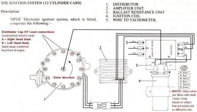

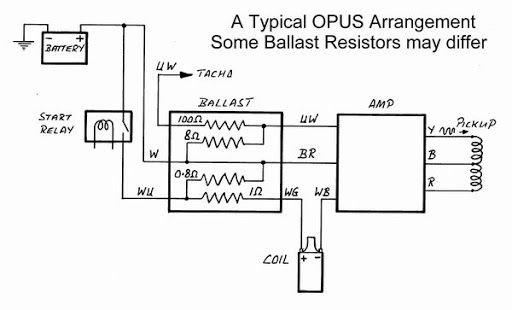

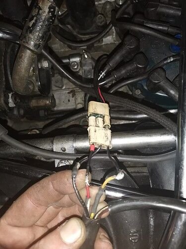

Greetings, please help. My XJ12L from 74 worked on the spot and just went off, I assumed the amplifier had burned out and after disassembling the case it could be seen to melt. I ordered another one, but I didn’t see that it was from 1980, the difference is in the wiring and the connector. I have short cables and all black wires on the old one, and on this one from 80. Red, black and yellow, there is a difference in the connector as well. I found the schematic in some catalog (I will attach) and put it together as it says, but it still doesn’t work. Another thing, I saw oil leaking from the coil and ordered a transistor ignition coil from our auto parts store, should that fit? I found a circuit on the internet where the resistances on the resistor are written, I measured and everything is fine except the resistance between W and UW according to the circuit should be 8 Ohms, and with me it does not measure anything. Can I put an 8 ohm resistor here, I live in Croatia and there are almost no such cars in our country, maybe 2 in
