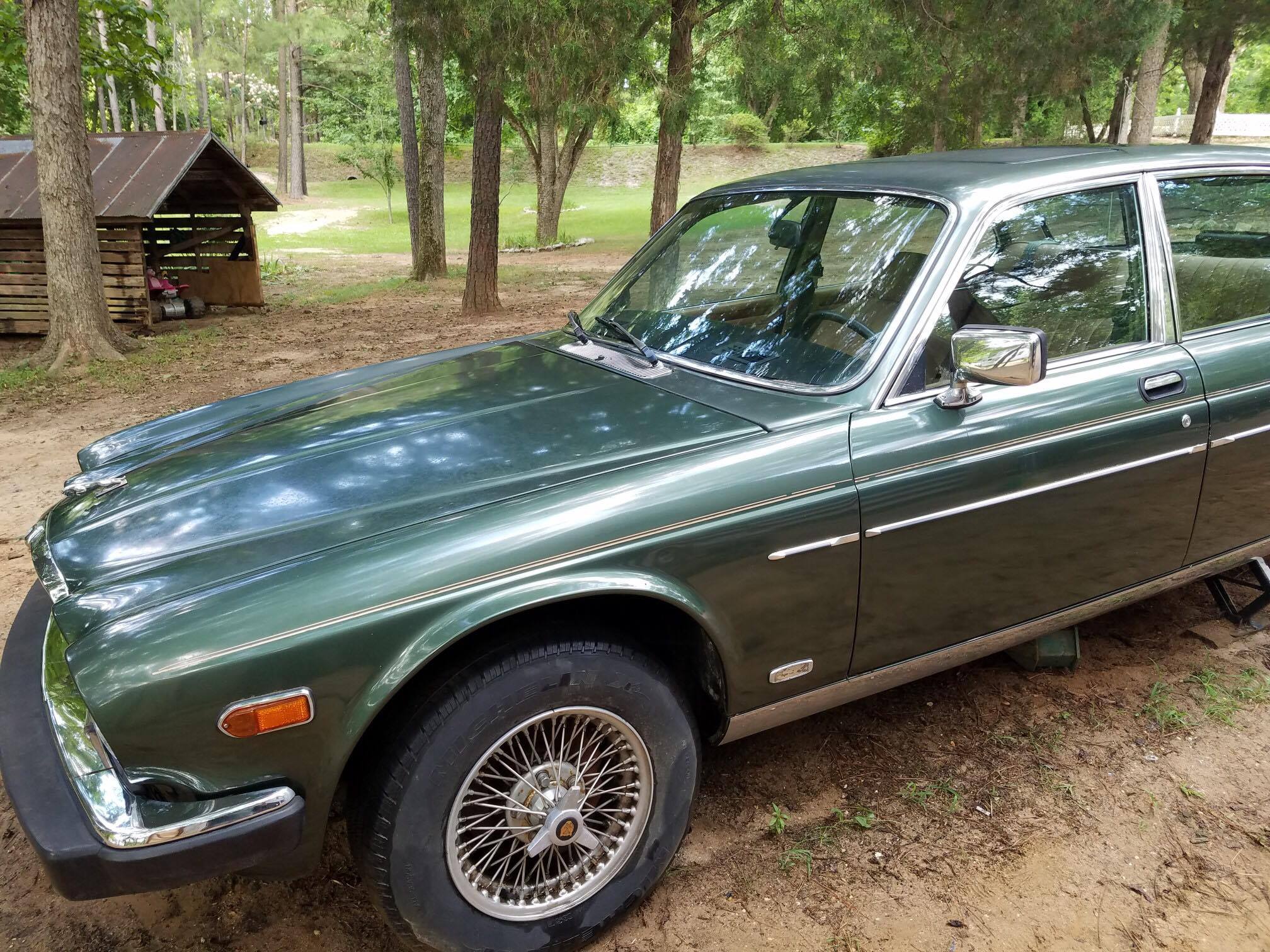

After 2 years of searching, I finally located my Grandfather's 1987 XJ6! He purchased the car (I'm told special order by my Grandmother) and drove it until about 2001. The car was sold at auction and lost for all I knew. We tracked it using the VIN# and finally located and purchased just a few days ago. The car hasn't been registered since 2003. Currently, will crank and idle but cannot be driven due to parking brake being engaged and untouched for over a year and stuck engaged. The previous owner has replaced the calipers and rotors on front. My plan is to drop the IRS and replace calipers, rotors, parking brake and whatever else that should be replaced while the cage is out. Could anyone send quick answers to the following questions? Feedback, tips...
A) Shocks recommended? I see calls for Boge but Boge seems to be a bit difficult to find.
B) Did the XJ6 in 87' have white wall tires or black only (typically from the dealer)?
C) What major points of maintenance should I plan to tackle to include rear brake overhaul and shock/strut replacement?
Thanks! I look forward to sharing the progress of the car!

What a great find and on two levels. Hard to beat that. It sure looks superb.
While many have dropped the IRs and refurbished it in varying degrees, I'd ask myself it were really necessary.
1. Is the parking brake stuck at the handle In the cabin? If so, getting down and under and disconnecting the cable at md point or even at the rear might release a bind and allow the handle to be twisted and pushed forward. But, of course, that does not mean that the pads are no longer in contact with the rotors.
2. The "odd" device that contains the pads and the levers to operate them Might be freed in situ. Disconnect the cable and attempt to work the lever.
3. Removal of the "odd" device for a bench rebuild is quite feasible.
4. When the calipers on my car went beyond a seep, I replaced them.
I decided, I was no longer up to that. so, I hired it out. Rebuilt Calipers from Rockauto and $600 bucks to a shop to install them. All good, except. But that tale has been told.
Keep us posted on the return to the road of that beauty.
