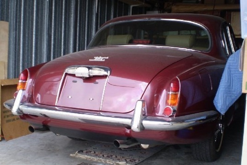

You need to post pictures of those tail lights at night with and without the brake pedal pressed down. How many did you make? I'd love to see how they look at night, and how much will you sell them for?
as you know, the bulb sockets are removable from behind so you can invert them up or down, in other words, the STOP and DRIVING lightbulbs can be placed at the TOP, they are normally at the bottom, and the TURN SIGNAL bulbs can be placed at the BOTTOM, they are normally at the top.
the result is more visibility for the STOP and DRIVING lights at night. THis came about because I was driving one day and the fellow driving behind me stopped when I stopped curious about the S type and inmediately told me that he could hardly see the STOP lights because they were so low, it was daytime.
So I had the bottom Lens reproduced in amber and moved the TURN SIGNAL bulb socket to the bottom position, and the STOP/DRIVING bulb socket to the TOP position which allows for more visibility. Very effective, you can't miss the STOP lights now.
And it looks a lot more elegant and "Bentleyish" with the Amber lens at the bottom, just like Jaguar did with the Series 3 XJ-6, (they lowered the Turn signals and RAISED the Stop lights for more visibility, so in effect, a Safety improvement).
I made 4 pairs only, the cost was enormous because a mold had to be fabricated, then 3 color-testings followed that. I have two more pair. I will send you a pm about price.
As to night pictures, I have tried already, I can't get the night effect either in photos or video. But the pointed UPPER RED LENS looks wonderful when you step on the brakes!
