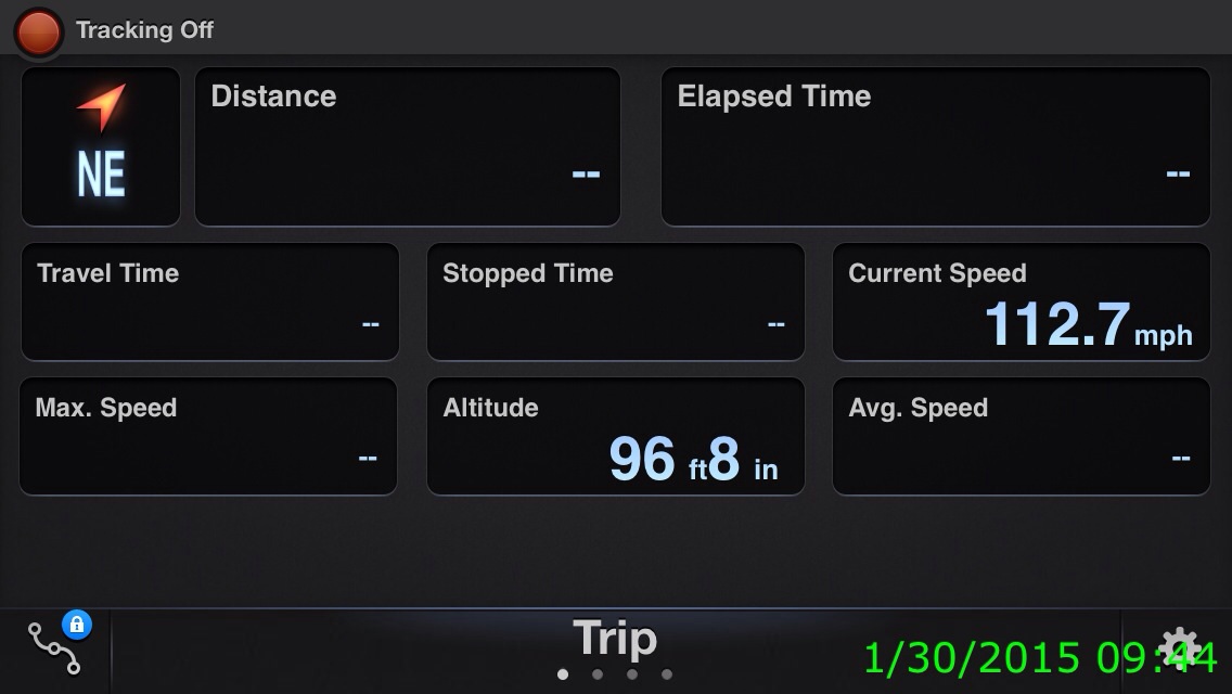

So I took Jank the Jankity Haguar on a longish road trip for work yesterday. I covered approximately 340 miles. I learned a few things about the car on that trip.
1. I don't think too many other cars passed me on the highway yesterday morning. I was moving along at a pretty good speed. Only problem was the speedometer said I was only driving at 63 mph the whole time (when at highway speeds). I had reason to mistrust the gauge when passing Mercedes, Porches' and BMWs. I downloaded a speed tracker app on my iPhone and found that I was speeding slightly... 112.7 mph...
Has anyone experienced this with their speedometer? Do you know if there is a way to repair it short of replacing the gauge and then having to deal with the discrepancy in miles on the odometer?

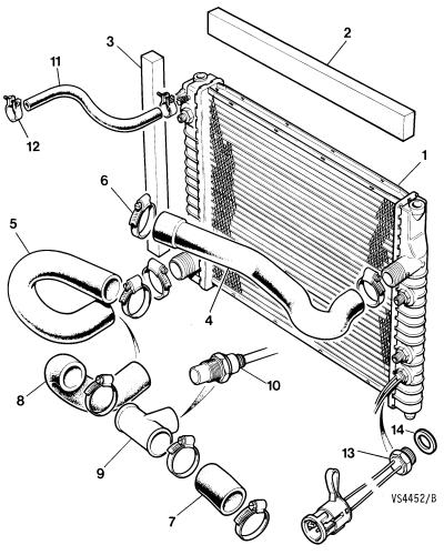

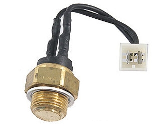

the only other related component will be the Thermal Switch located at the bottom right corner of the radiator, (part number 13 in diagram), a pain to get to without removing the air filter assembly and even then, almost impossible. Check with a flashlight to see if the two black wires are connected,
ideally you would want to disconnect either wire of the Thermal Switch while the fan is running, to check the system, but it will be extremely hot to get in that corner. You might try to get to it from under the radiator.

The complexity in that drawing amazes me. The low water indicator in my car, when it was DOHC powered failed me, as did the temp guage!!
Carl
Old Feb 2, 2015 | 02:42 PM
Jose's Avatar
Posts: 9,139
Likes: 2,662
Carl,
the drawing does not show some aluminum tubes that go around the top of the radiator from one side to the other, talk about complex.

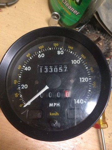

I bought a used speedometer from David Boger at everydayXJ. Great guy! Inexpensive and super fast shipping. The speedometer is a little rough, but it's a FED CAL reading to 140 MPH. The odometer shows about 34000 miles less than my car has. Now I know what you all are thinking... but that really wouldn't do me very well as I just titled the car with 132000 miles. So I dismantled both gauges (my old one and the "new" one) and am in the process of running the mileage up to the desired reading of 133045. This works both ways if you all are interested to know that, though clocking a cars odometer back is highly illegal and morally reprehensible!! I believe in honesty in these matters. Besides, it's a badge of honor to be running a 33 year old car with actual mileage showing on the clock. More to follow...

I combined the best parts of the two speedometers that I had, my "original" one showing 133045 and the "new" one with the FED CAL reading to 140 MPH. I shot a short video of my method for running the odometer up to where it needed to be. It took about 1 minute per 1000 miles! So all time running about 40 minutes!!
Though I guess I don't know how to upload a video yet.
Anyway, I put it all back together and got it back into the car, drove it to work this morning and, alas, no miles counting, neither on odometer nor trip. I suppose it could be the "new" wiring harness, or perhaps the "new" drive motor? The speedometer works for speed as this is essentially a different circuit in the speedo. My next step will probably be to swap the drive motors, the "new" one for my "original" one. After all, theoretically, the drive motor is turning at the same rate with the same shaft diameter with the same worm gear, so all things being equal it should yield the same turns to clock miles at the same rate... awfully confusing without know the right answer before trying all these things!!
Any help would be appreciated...
