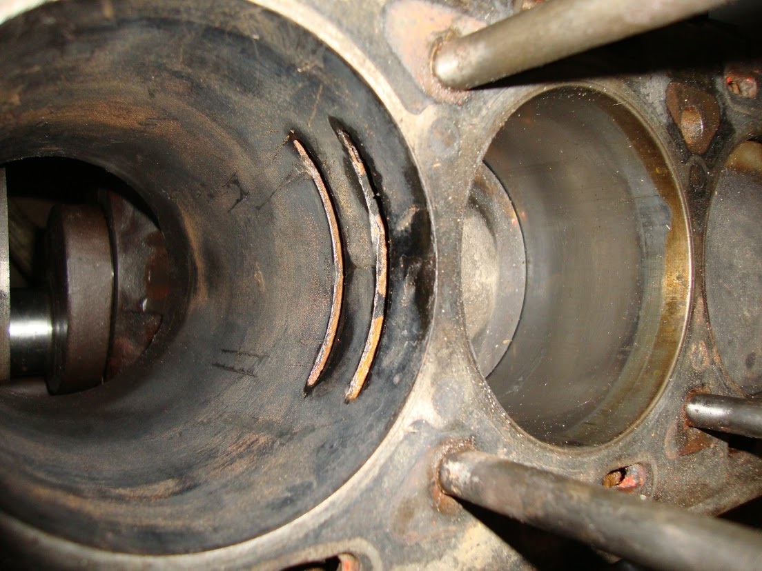

Much depends on whether the engine is a long-stud engine or not. These have engine numbers with 7L and 8L. Long stud engines up to about 1981 can suffer cracking between the bores. This is because to provide coolant passages between bores, passages were machined accessed from the bores and then covered over with thin wall liners.
Once cracked, the engine will suffer continual head gasket failures, like mine did until the block was replaced with an uncracked one. Reason for this is the strength of the metal bridge above the coolant passage is lost once cracked and the block face drops slightly relieving the gasket pressure and allowing combustion gases into the coolant jacket,
This happened to my 1980, (8L block), and my replacement was a 7L block. 7Ls crack less than 8Ls even though they are virtually the same. I was told at the time, (early 90s) by an engine builder, that Jaguar tried to speed up the engine manufacturing process in the 70s by reducing the aging period after casting. Whether this is just an old wives tale I'm not sure but it was confirmed that iron casting practice was to leave new castings for a few weeks to let them "age". This allowed the stresses induced after casting and cooling to relieve following which machining could proceed. The pressing in of the liners could also induce stress into the metal bridge above the machined passage.
It is possible to cure the problem by removing the liners, and machinge the top of the block to take lipped (or "top-hat") liners that touch each other and cover the crack.
Here's a photo of a block with a liner removed : -
