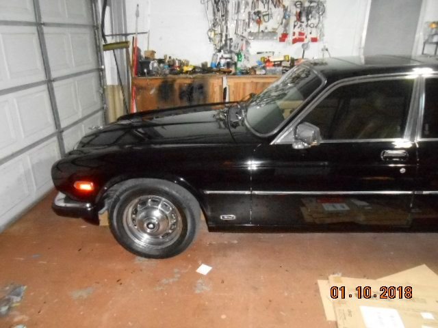

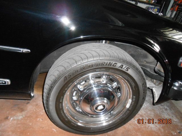

When I did my Chevy conversion I had the same problem.
I resolved the issue by removing the spacers from the coil spring (2 on each side) and 1 1/16 grade 8 washers at the spring pan.
From this
to this
spring spacers
From this
to this
spring spacers
So Sanchez, you just took out the upper spacers and then added the washers to the spring plates to lower the plate a little? The reason I am asking is I will be doing this to the 1974 car I just got because it has had the 350 swap done and sits high in the front. Please let me know and thanks.
Old Dec 26, 2019 | 05:04 AM
sanchez's Avatar
Joined: Jun 2015
Posts: 1,514
Likes: 687

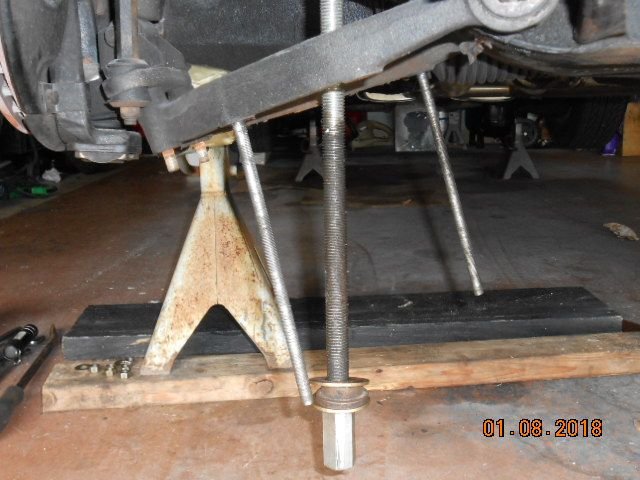

Yes. I resolved the issue by removing the spacers from the coil spring (2 on each side) and 1 1/16 grade 8 washers at the spring pan.
After driving the car around for a couple of months, the springs settled and I removed the grade 8 washers I had added at the spring pan.
You will have to design a tool to remove the coil springs from the car.
front spring removal tool

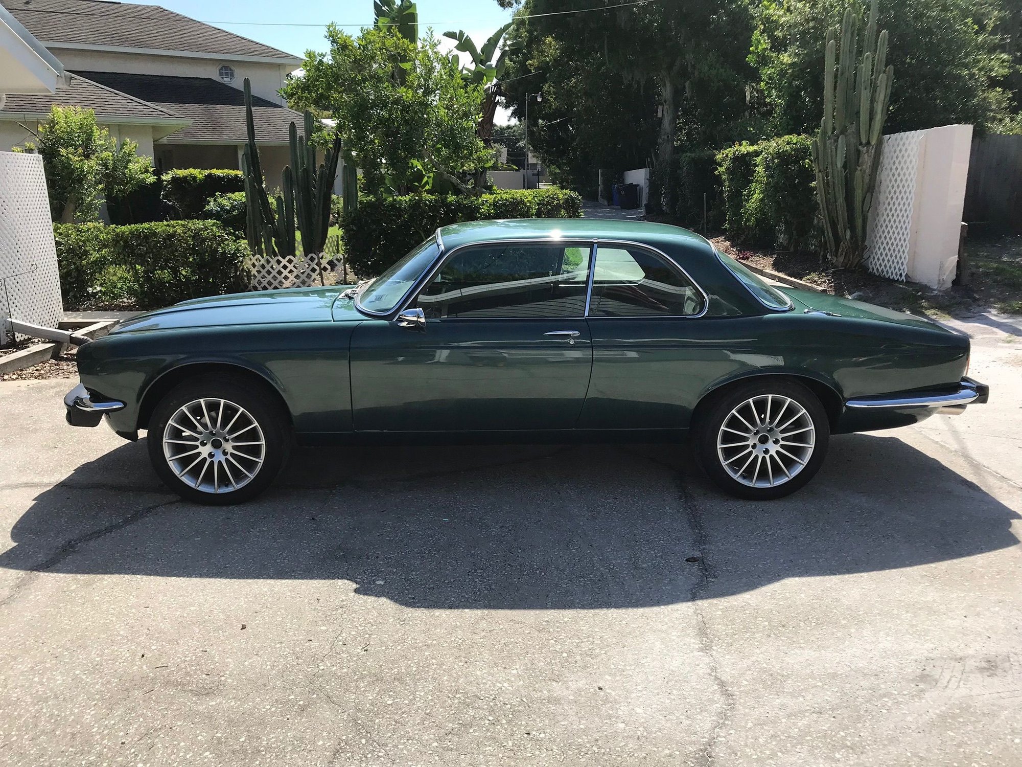

Used a local restoration shop, they had a process to slowly heat the springs to lower.
2” front drop

Is the ride still as smooth using the heat treatment method to lower the front?
Regardless, the stance looks great and so is your car.
