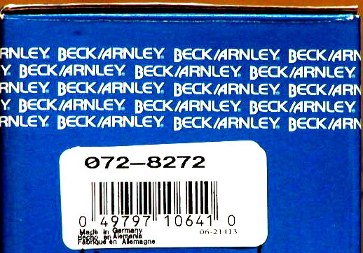

After 38 years it seemed a good idea to change out the master cylinder -- especially after the panic stop the other day and the front brakes didn't. No harm, I merely looked a little stupid as I finally got stopped in the middle of the intersection. Fortunately no one was behind me so I could back out before cross traffic got the green light.
I put in an order for a familiar brand, Beck/Arnley, and it came in a very timely manner. Quick inspection/comparison showed it seems to be the right one. I was thinking I would install it tomorrow, so it seemed a good idea to see what all might be involved, if there's anything different from "standard" since I'm still learning how the Brits did things in the '70s.
We hear all sorts of tales about counterfeits, from prescription medications to military helicopter tail rotor bearings. They always say a dead give-away is poor spelling. I would think Germans would know how to spell "Lucas."
Attached Thumbnails Master Cylinder-beckarnleybox.jpg   Master Cylinder-beckarnleymaster.jpg
