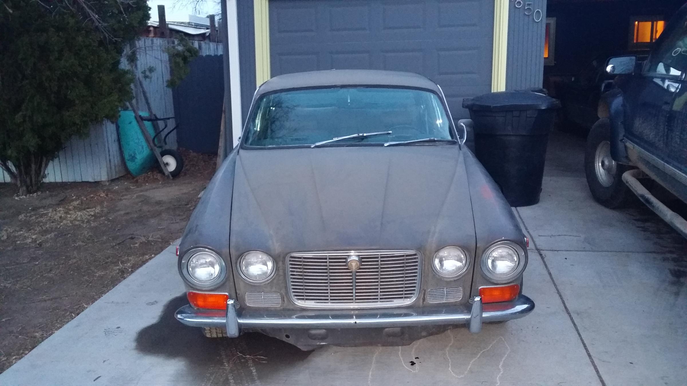

I just picked up a 1971 XJ6 that hasn't been on the road in many years. The body seems to be pretty solid with only minor rust issues (some in the rocker panel, some bubbling in the rear wheel well), but is overall straight and doesn't appear to have ever needed repair.

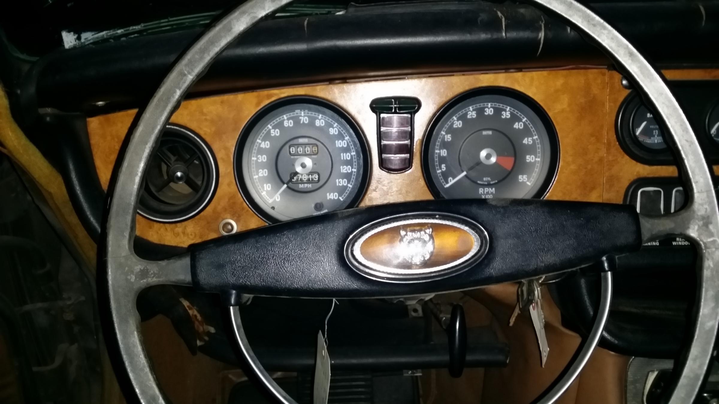

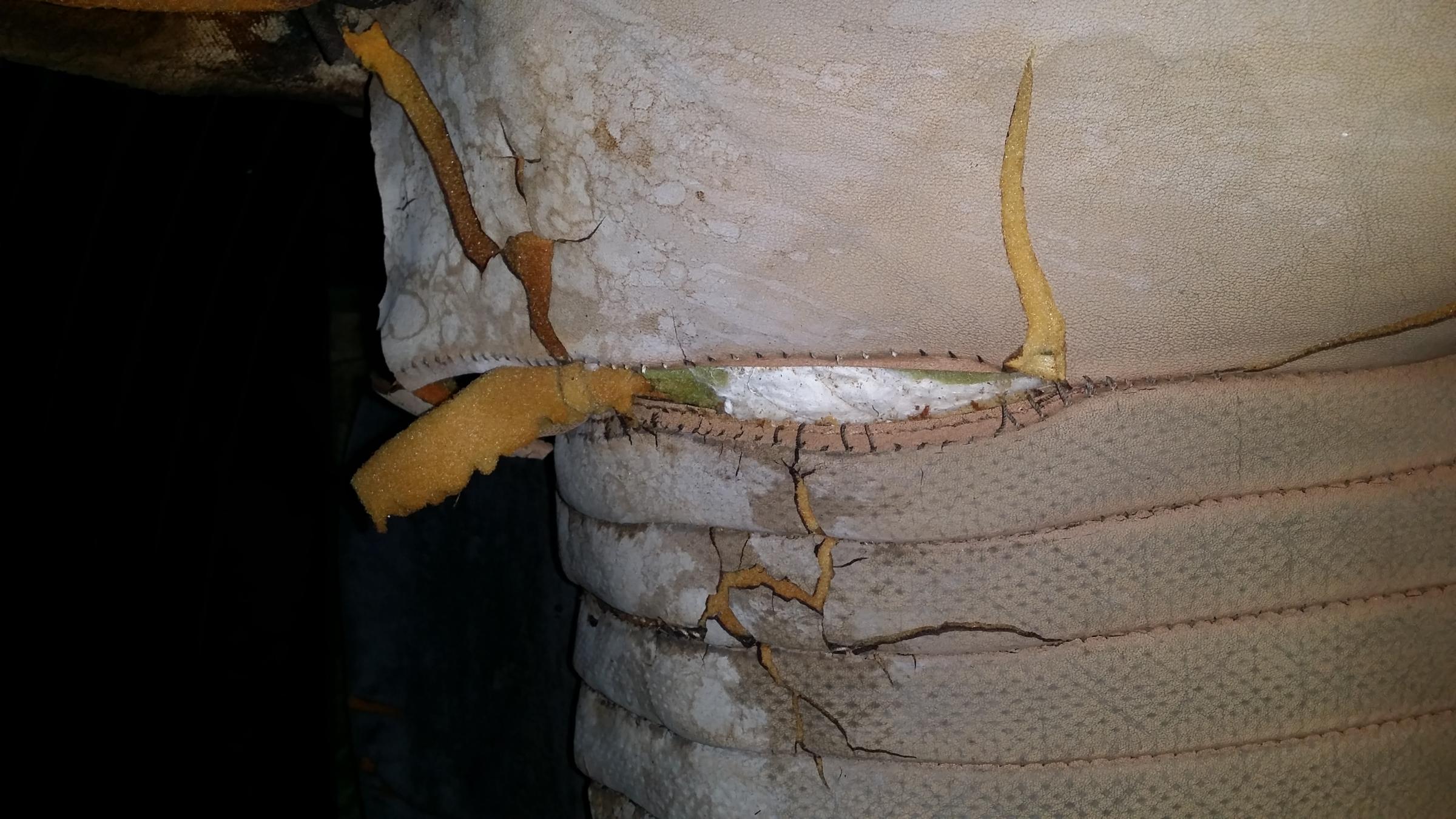

The interior is a different story with the front seats being good for pattern making and that's about it. Most of the rubber seals around the windows are dry and cracked.

Mechanical parts are not usually a problem, but trim parts will be difficult. The dash top is a particular problem as it is plastic foam covered in vinyl leather-look. Fuel tanks are obtainable new, I have now seen several adverts for these in the UK. I think the Series 1 and 2 tanks are the same, but you'd have to do some small mods if using Series 3 tanks.

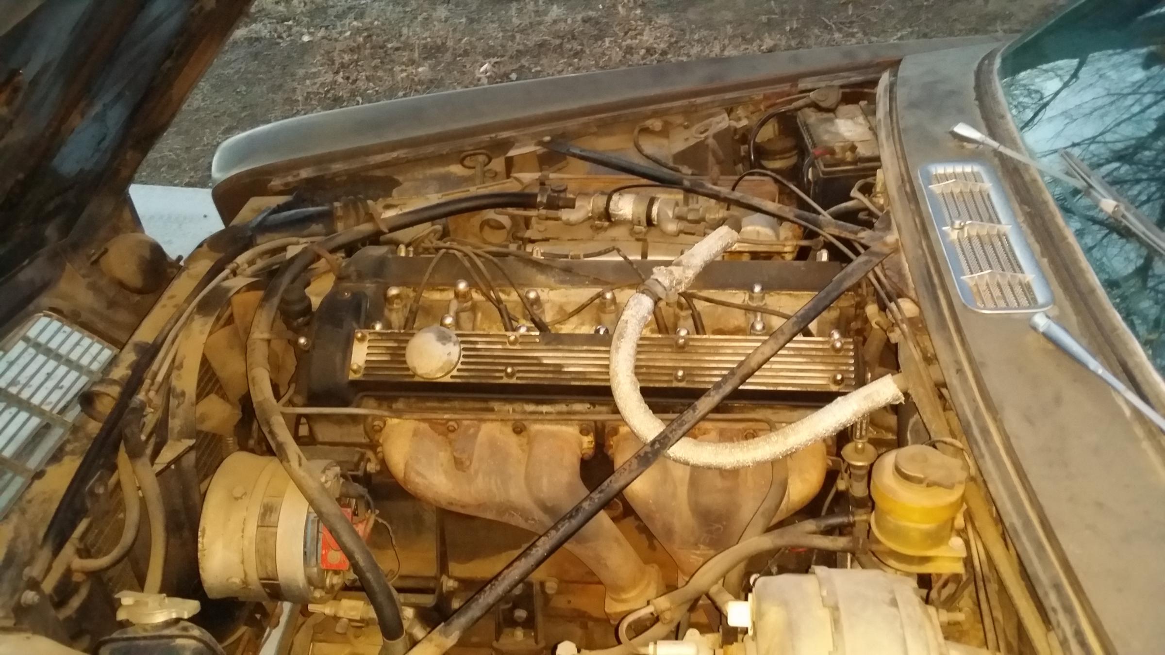

Ok, here is what I have done/learned as of tonight:
I pulled all the spark plugs after taking a shop vac to each plug area in an attempt to get rid of as much of the crud around the spark plugs as possible. There was still more that fell into the cylinders than I would have liked.
After removing the spark plugs, I examined the plug wires which will definitely need replacement. Most seemed ok, but one was down to bare wires in areas.
I shot some marvel mystery oil in each spark plug hole. From what I can see the tops of the pistons are looking pretty black. While I was at it, I took a peak at the exhaust cam (didn't remove the cover) which was in much better shape than anticipated.
I vacuumed up that lovely yellowish sand looking stuff in the gas tank caps. Took a look inside and was greeted by a healthy amount of rust. Tossed a can of sea foam in each tank.
For the hell of it, I installed a new battery just to see what works and what doesn't. Here are the results:
1. Engine does turn over
2. Map light works
3. Fan works (slow only)
4. Power windows work (pitifully. All windows move slow, passenger rear is now stuck about an inch or so down)
5. No lights, turn signals, etc.
So at this point I figure I need new gas tanks (I'll still wash out the tanks, but am not getting my hopes up). I am also not terribly excited to chase all the electrical work it appears I need to, but oh well.
Any pointers on the electrical?

Following on from your peek down the plug holes, as a serial destroyer of straight six Jaguar XK engines in my younger days, I can vouch that carbon build up on pistons and valves was normal.
