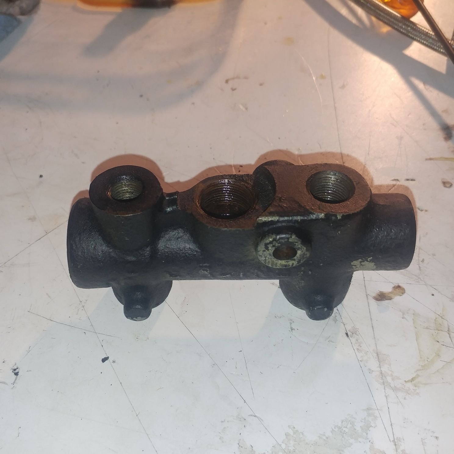

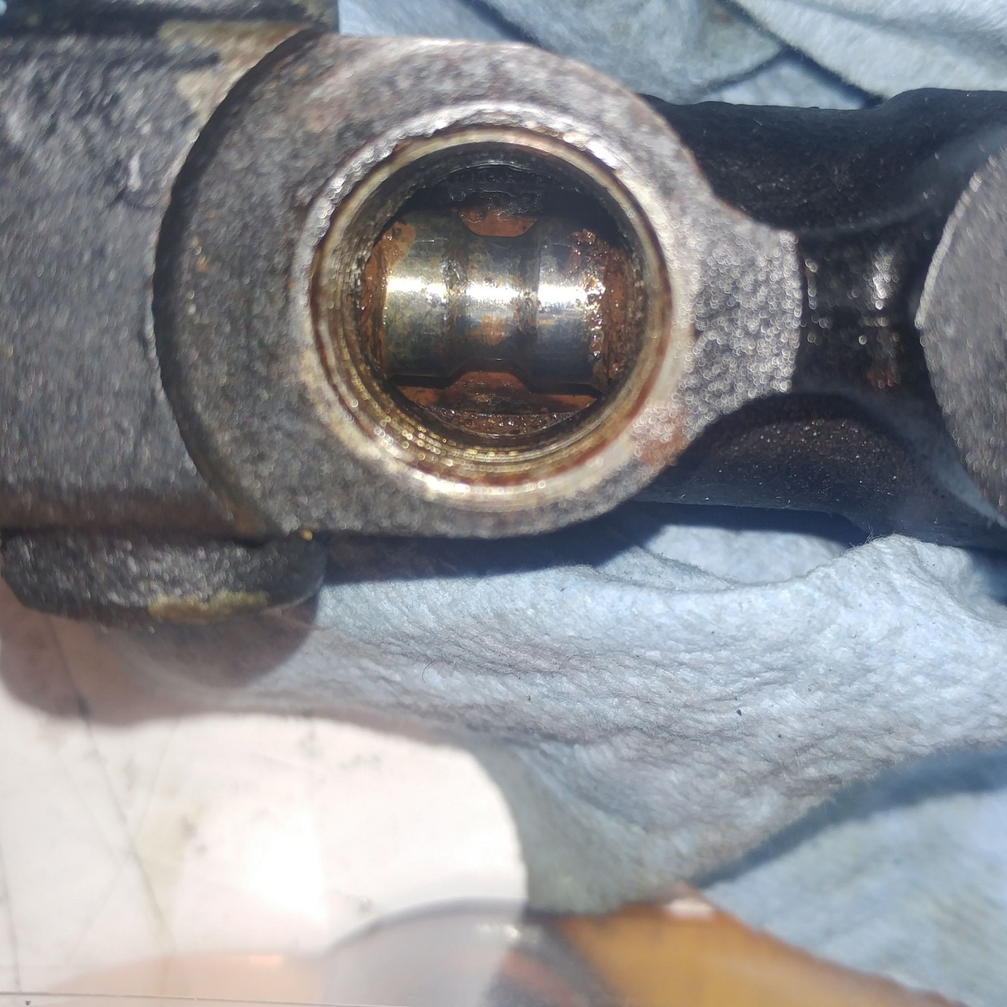

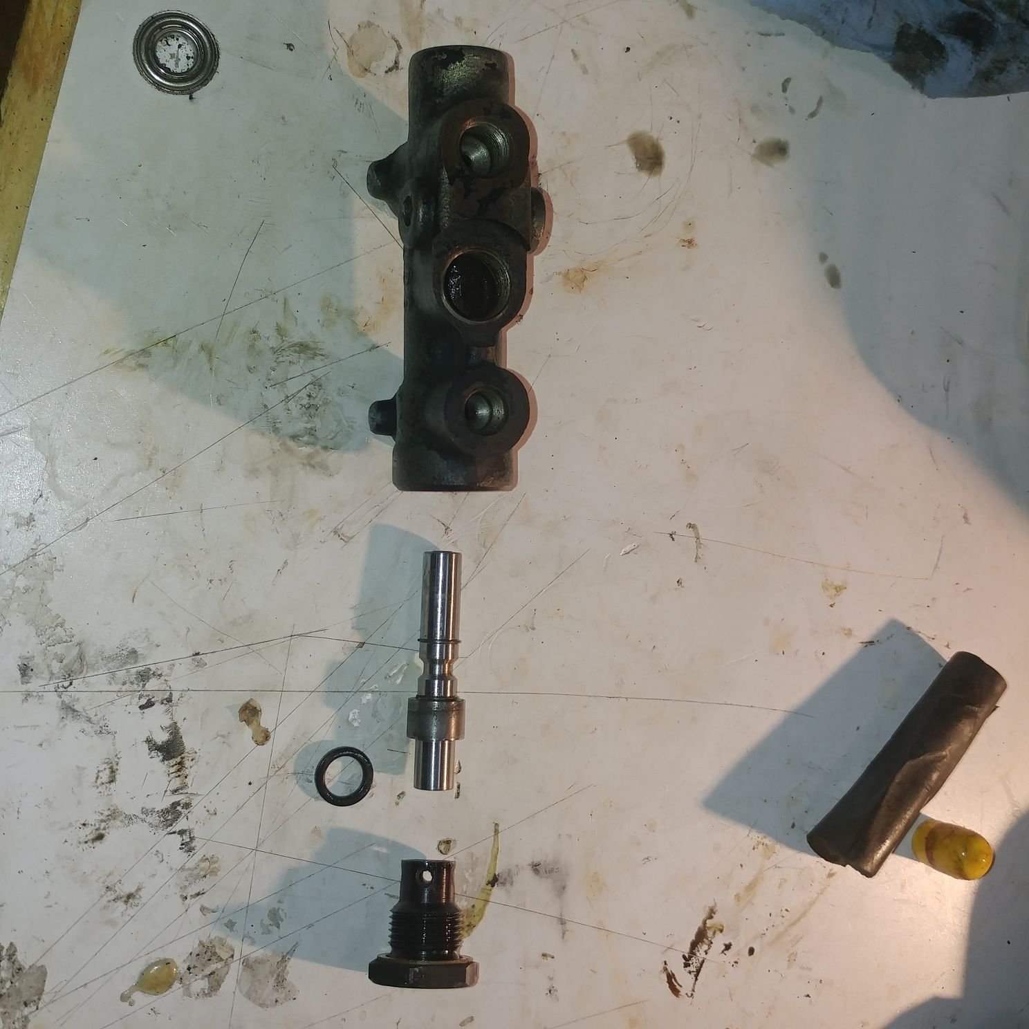

IF it isn't the booster, then check the mechanism that distributes the balance between front and rear brakes. I found mine super clogged and not working because the brake fluid went bad and everything became sticky. Don't know if this applies to the Series III you have. I have a Series II. But I thought I would throw it out there anyway.

I actually took off the brake lines, distribution block, cleaned inside, outside and painted them and polished the brass block.
