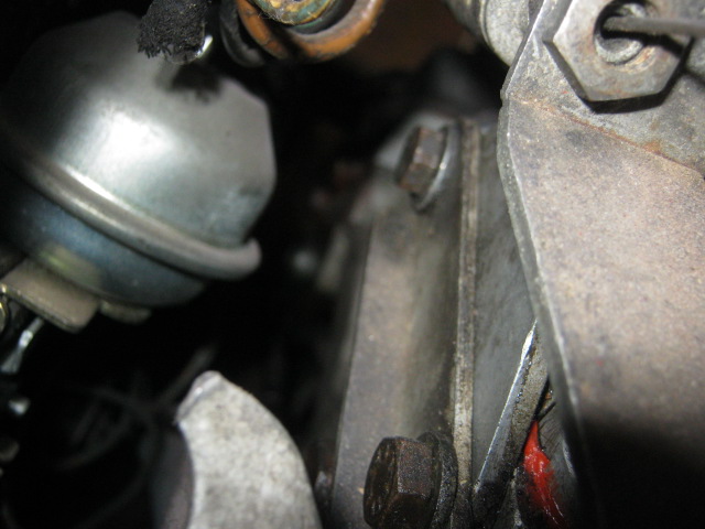

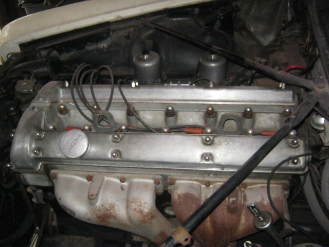

The answer is..... Yes....
The original smooth covers from the 3.8 will work on the 4.2...
And, yes, the 3.8 had the tach drive on the rear, but it is easily solved by adding a blanking plate to the rear of the cam cover.. (I'll attach some photos)...
This pair is on a 76 Coupe (4.2L) and will be removed and sold... The price the OP paid was about right ($75)....
David
