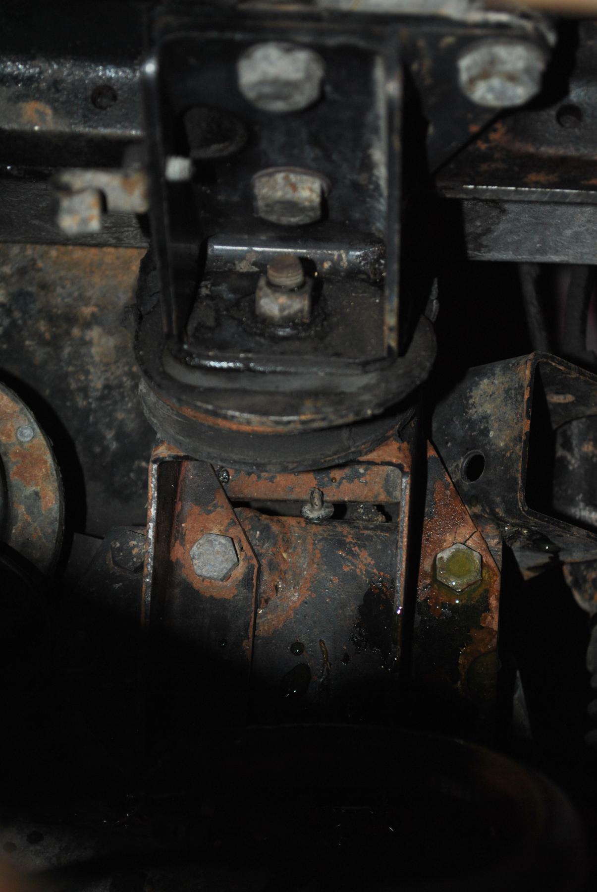

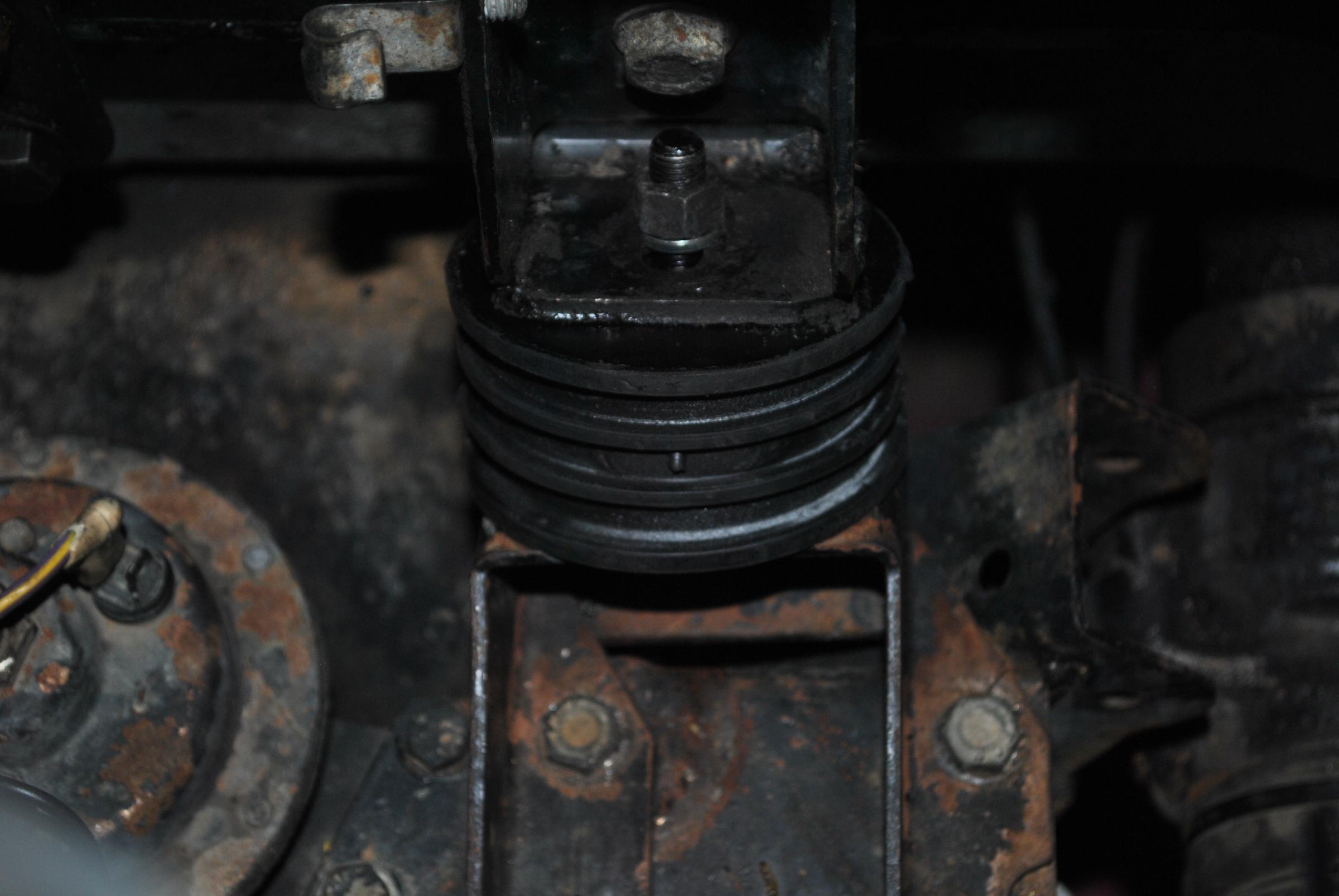

Thanks again for your help with the kickdown,now sorted. New micro switch. Broken engine mounts were causing the sticking throttle we talked about too,engine was moving a long way when accelerating up hill causing cable to get stuck behind master cylinder.
Yep looking at your pic I can see the rear window is noticeably longer than the front,looking out the window mine looks the same size as the front.
Thankyou all for your input on this thread. Lots of good solutions,fortunately I did not have to change ride height. I fitted the new engine mounts today, that gave me around 20mm more clearance. Then undid pipe connections and jiggled the pipes around pushed them up into the trans tunnel .Got a good 50mm there,tightened it all up again and road tested. Pipe not touching body anywhere
and about 40-mm clearance at worst position over top of the drive with me in the car and 2 half full tanks.
As you can see in the pics two of the rubber layers were missing off both mounts.
Clarke

That was one F-ed up engine mount alright The mounts in my 73 are screwed up as well. Not broken but weirdly distorted. The top and bottom bolts don't line up so the cylinder shape of the mount kind of leans forward. Not sure how that happened but I'm sure it had something to do with the stupid PO's shenannigans. Gotta switch mine out soon too.

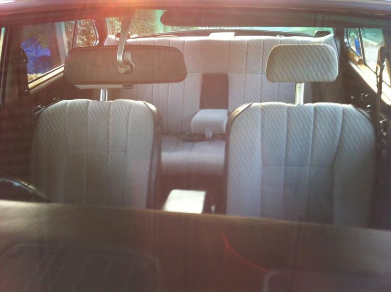

here is some pics of the interior from the add I bought it from,nothing has changed yet. Except the radio,so I can plug in my mp3 and listen to CCR,Eagles,Bob Seger, and ACDC. Nothing like an old bloke at the lights pumping out Bob Seger (lol). That pulls the chicks.

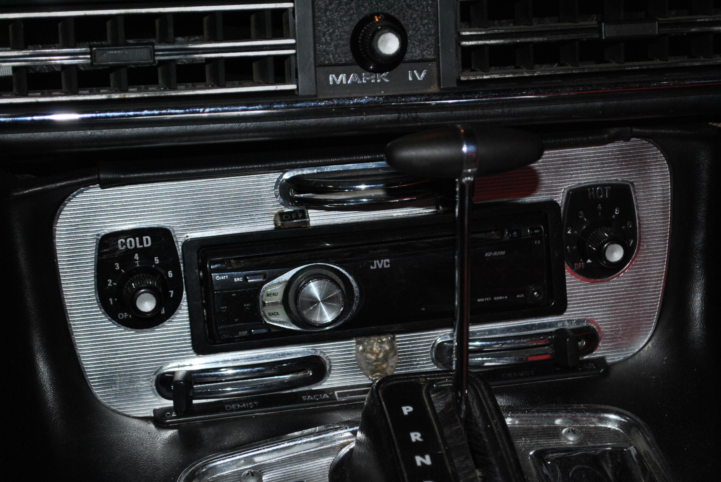

Default New Stereo and surround
Mike, Here is a pic of the new one. Looks much better.
