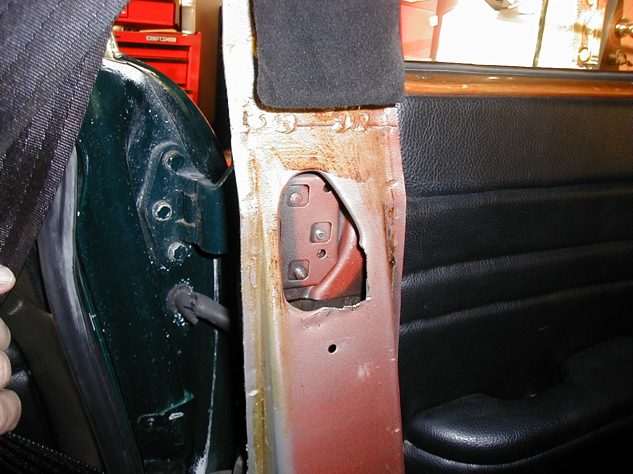

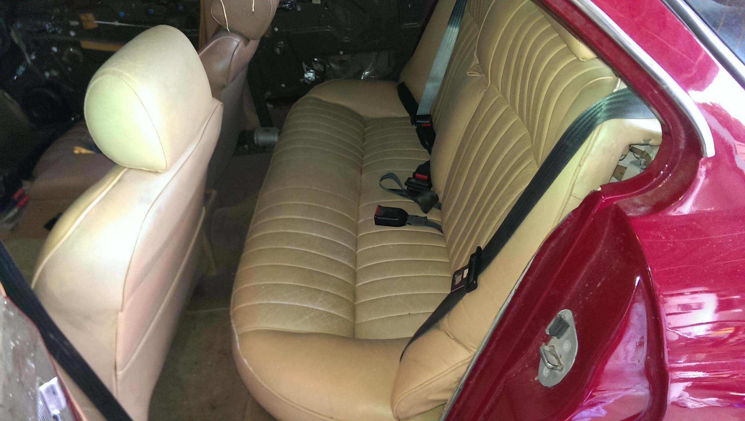

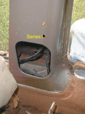

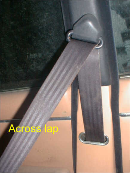

Default Wow, only lasted 44 years?
I got rid of them, old style belts in mine were "magnetic", have S3 rear belts due to the cool retractor that is just a bolt in for our cars.. plus safer than the stock lap belts.
Put, late model OEM belts into the "B" pillars like the S2 and S3 cars.. gained foot room for the rear passengers and modern designed belts.

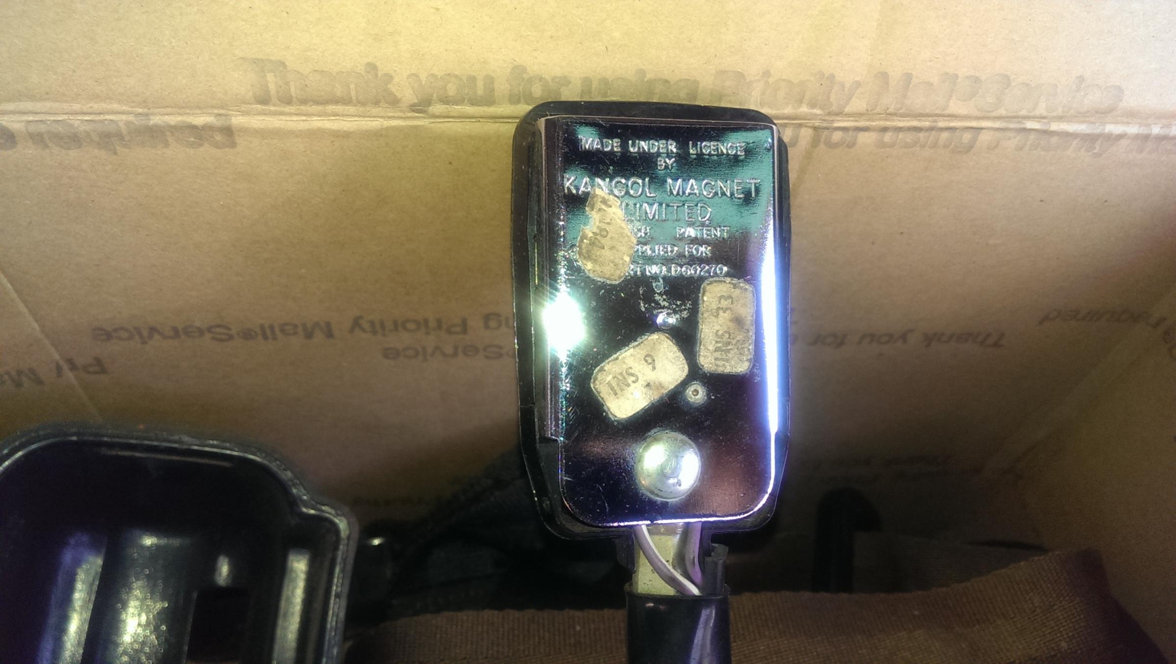

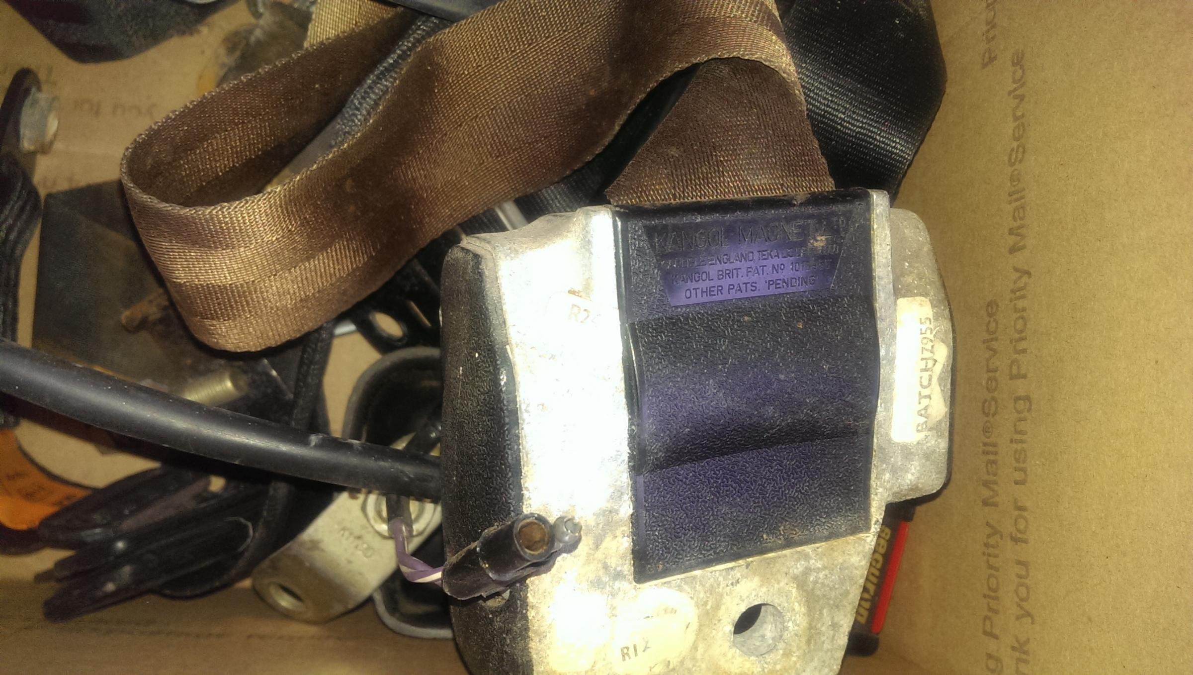

Default My old belts were Mangol Magnet
I found them and was going to send them to you but they are not the same brand. They are in good enough shape as I remember but very odd... let me know if you want them or they are going out in next weeks trash. Kangol Magnet is the brand - typo in the subject line.
