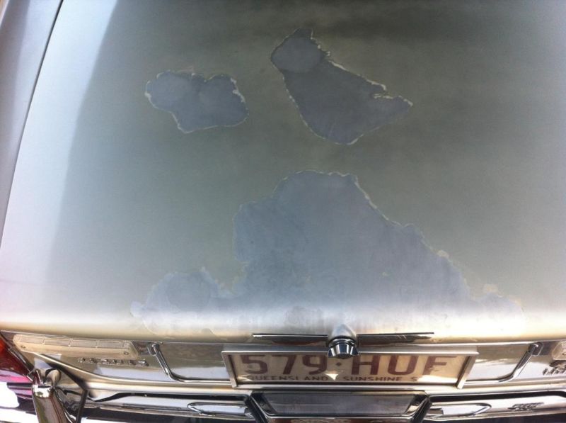

Ken, I took about 12 pictures of the XJ6 at the garage door,my photography is overkill. I never leave home without a camera(even on the bikes). And enjoying the fruits of the road test as we speak.
Clarke
Trawling through the 300+ photos is what took most of the time,but photography has been a passion for 35 years,thank god for digital SLR's. Developing used to cost a fortune. Oh and the 12 hours today getting each photo down from 2.5mb each finally have the complete paper down to 8.1mb. Making each picture file 5% of their original size without loosing the definition.
update, thanks for the PDF conversion Graham,my original word doco was 162mb. No wonder I was having trouble posting it.
