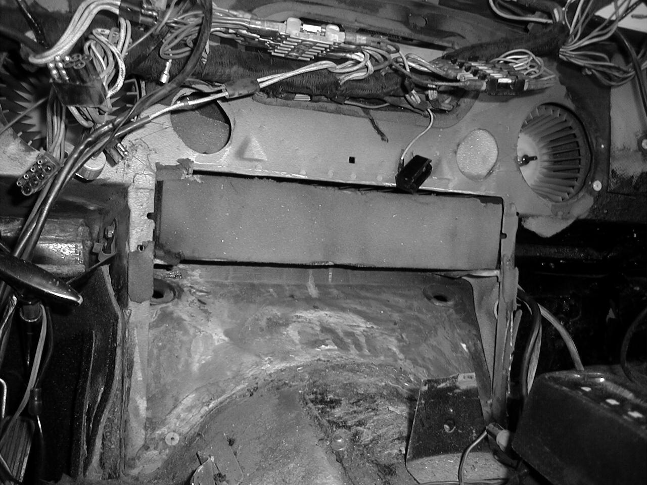

If anyone has some pics of the bare series 1 under dash area ide love to see it.

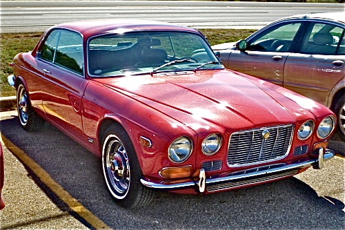

I have seen, up close and personal, a Series II XJ6 Coupe conversion to a Series I. The interior had complete wooden trim on the door sills.
It was very nice looking.
Myself, I would change a Series II American export to a European version but to make a Series I conversion is really a lot of work....
If anything, I would recommend scraping the stock factory air system and install a Vintage Air kit.
You can set up the the air system to use a smart phone for the control panel.
That will eliminate any knobs.

Here are photos from my fun job in fixing a leaking heater matrix... had to pull it out and get it repaired as they are NLA (no longer available).
Let me know if you need any other views?
