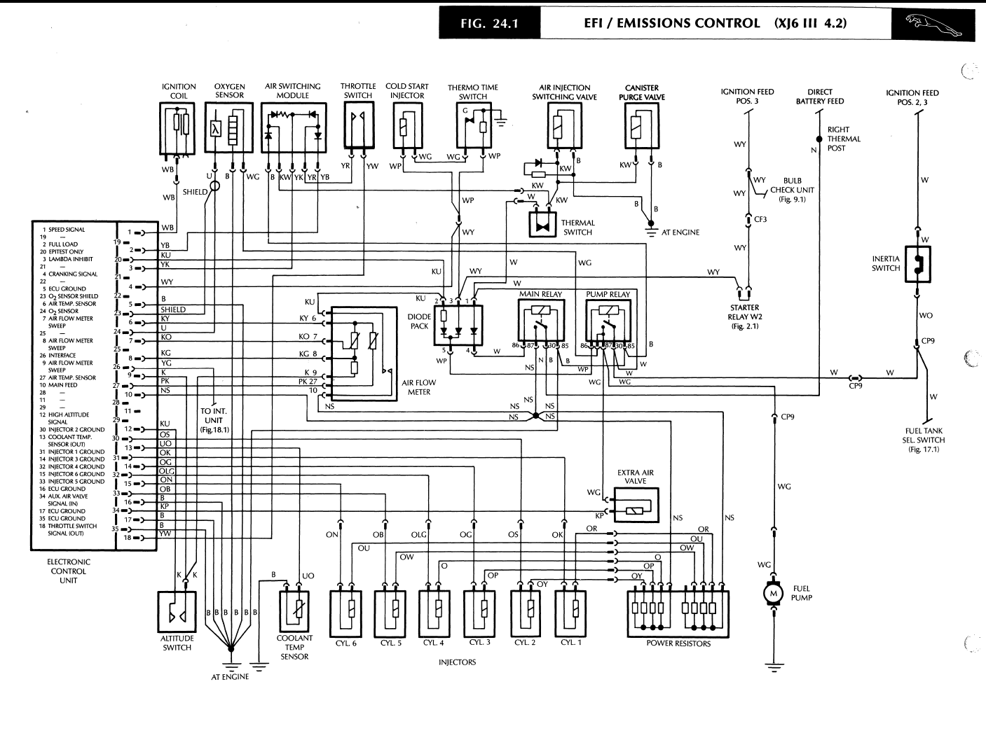

I like this idea -- but I was wondering if the problem is really just starting, why not stick the resistor at the TT sensor since that wont change anything other than restarts. altering the signal from CTS changes everything all the time. What do you think?
Old Nov 2, 2023 | 03:57 PM
David84XJ6's Avatar
Posts: 782
Likes: 461
From: Central California
Not sure which sensor you referring to, the cold start injector circuit has a 35 C switch and timer for cold start, does not trigger on warm restart. see attached diagram.
Rgds
David
