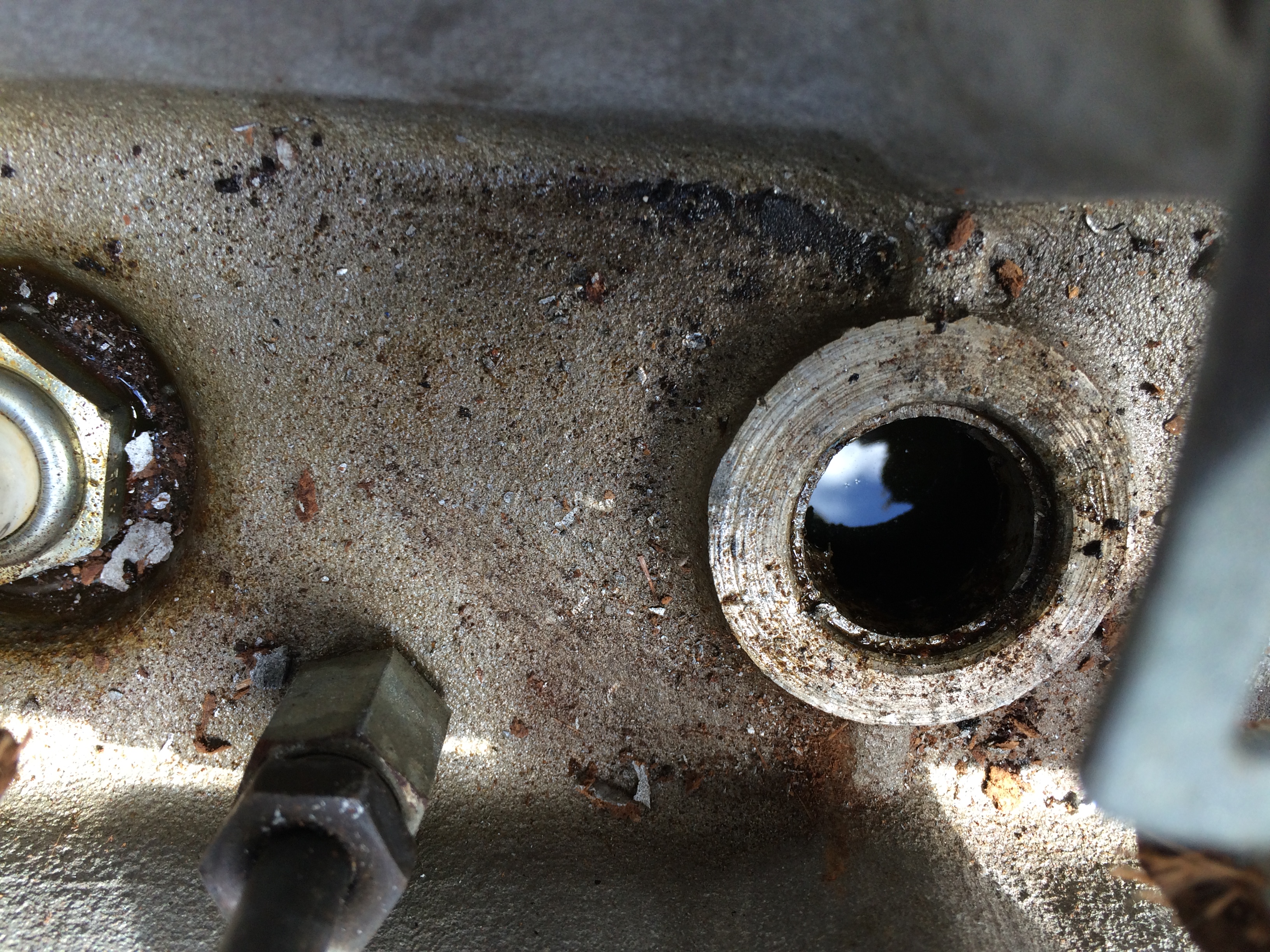

Hi xjforty,
Knock it out and put a new one in.
I had a weeping one which let go in traffic a couple of years ago.
Really not that hard.
Replacement core plugs in Oz are plentiful and cheap and made of brass.
Looking at your photo's, there is a lot of coolant residue in that valley.
I broke the silver card thingy swerving through through the spark plugs when I fixed my one, but then again, I removed all of that when I removed the air pump and all of it's plumbing a little while later.
My old plug dropped into the head, but I used a powerful magnet to find and recover it.
New plug belted in easily. Just remember to smear a sealant around its edges before you fit it.
To fit, use a socket one size smaller with a mallet. Easy
Cheers and good luck'
Nigel

Hi xjfourty,
It's a pretty easy job if a little time consuming.
Time is what will cost you in the shop.
The tubing on top is the smog pump plumbing.
Loosen and detach all six nuts and you should be able to lift the whole kit and kaboodle out of the way. I just removed it full stop when I did my one.
Just remember to blank off each opening with some tape to stop foreign matter from getting into the head.
It is also a good idea to take the leads off the spark plugs on either side of where you are working to make some more room.
If you do go ahead, don't do what I did and lever the core plug removal tool against one of the spark plugs as you will probably shatter the porcelain part of the plug like I did, which made getting that one out a whole lot of fun.
If you ask anyone who deals with these engines for core plugs, I would be very surprised if they don't literally reach behind and pull them out for you as they are readily available.
From memory there was a choice of two materials but I wanted and fitted a brass one.
Oh, and get a vacuum cleaner out and suck all the crap out of the valley before you remove anything physically from the head as foreign matter falling into the head is not ideal.
Cheers and good luck,
Nigel
