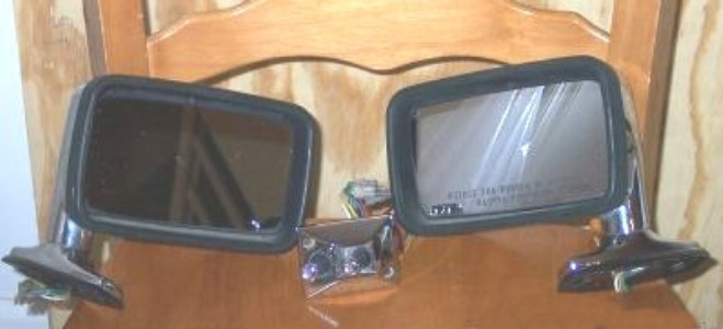

Has anyone fitted a similar mirror to this on there series II? Was fitting difficult what did you do with the adjuster inside the car for the original mirror. Just need to replace my original mirrors they are very tatty.

ohh, it's a Series 2... sorry, I thought it was a Series 3 with motorized door mirrors.
I don't think the Series 2 came with electric mirrors, but adapting Series 3 mirrors is not impossible, I did it to my 1965 S type, electrically it was a piece of cake, I pulled the entire mirror-harness from a salvage XJ-6 and tranferred it to the S type, it is just a 1-hot, 1-earth wire harness.

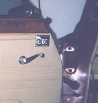

Mounting the mirrors on the doors was another story, it required measuring 100 times, making a final template, and then drilling once, no room for errors here. But I did it.

here's some more pics. I also added rubber "accordion" necks at the door jambs to run the wires to the interior. Got them from the rear doors of a GM SUV. Had to drill 1" holes on both jambs. Looks like a factory job.
I can't drive without electric mirrors, especially at night, there is nothing like being able to control the mirrors as you need. The S type came with original Lucas door-mounted mirrors which were totally useless in today's traffic conditions.
