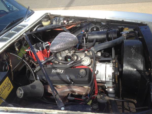

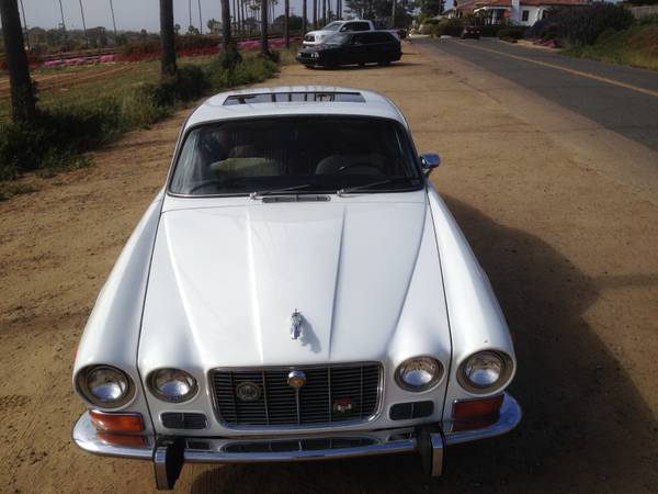

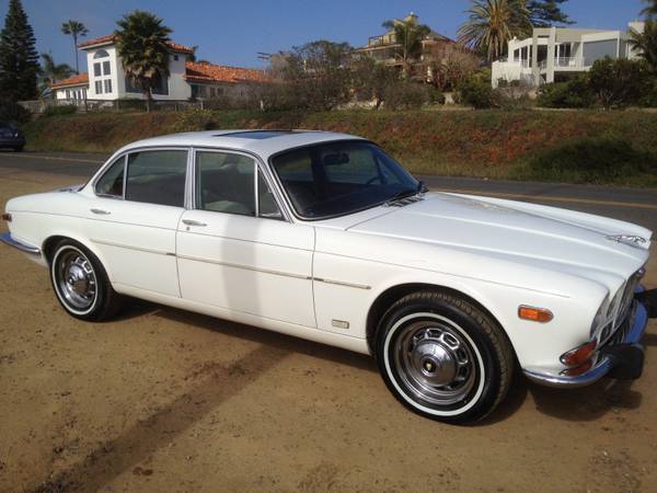

Series 1's with the Chrome bumpers are a great looking cars. I'd want it!
This one looks like a John's conversion. They can be rough and very unrefined because they use a suspension joint as a motor mount and this doesn't provide the proper isolation. Alternator looks out of alignment and may toss the belt. Belt looks new so it probably tossed it recently. Typical for John's conversion.
Monster transmission can be harsh too. They're called monster for a reason, they usually shift and bang.
.060 for a SBC is really stretching it.
This car really needs a good and long test drive to evaluate it properly but it reminds me of the 76 coupe I bought, it ran and drove, had a John's conversion, was rough, slow, not tuned properly, needed lots of finishing. I ended up redoing the whole car and would have been better off starting with a shell. New engine, new mounts, new trans and so on.... Search around here, there are lots of well done conversions. When converted well, they are an absolute joy to drive. Smooth, fast and economical. When not done well they are grating and disappointing.
Knowing what I know...if I was in the market for a series 1 sedan. I'd pay 1500 to 2500 depending on what was re-useable and for me a rough around the edges carb'd .060 over 350 with a bang shifter isn't very useable. Car is worth 7 to 9 grand mint as a convert and will cost you every bit of 5000 to get this car there. Lots of ways to look at this and this is just one.

Not knowing the market in the US it's hard comment on a price. Body wise it looks straight and all the trim is still on the car which down here can be hard to find.
As you say interior is not a problem done over time. If it drives ok I would take a chance on the conversion being good, and that can be fixed.
Thing is you get a driver you can play around with at your lesure.(that is how mine is)
It would be a $4-8k here I think,from what I saw searching for a straight series 1 with all the trim and registerable.

350 auto = no OD = lots of gas to drive the car.
John's conversion = poor motor mounts and no after sale support to non
original owner.
Have you confirmed the heating and AC actually work? Car is full of plastic parts that are NLA for the heating behind the radio. Drive the car
down the road and take your hands off the wheel = does it stay straight?
Get it up on a lift and confirm the rear brakes are not leaking and have some pads left.. check the handbrakes = do they hold the car = or LOTS OF MONEY TO FIX.
Shroud around fan is "hooky", not a well done engine compartment...I have a '71 Jag with SBC and sold my '72 Jag with LT1 and John's conversion... the best part is this is a '73 and has good door hinges and later model heating fans.
Check the front seats to make sure the rubber diaphragms have not rotted out.. just more money when redoing the interior.
original owner.
