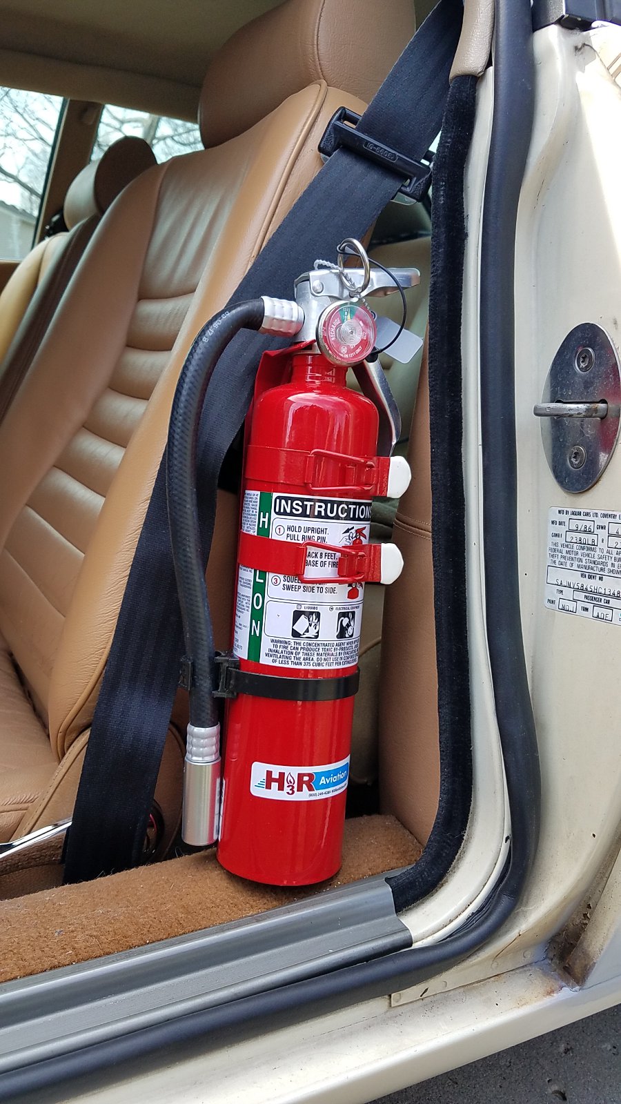

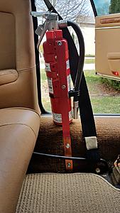

Thinking about fire, or fire suppression, I found myself rigging up this arrangement (see photos).

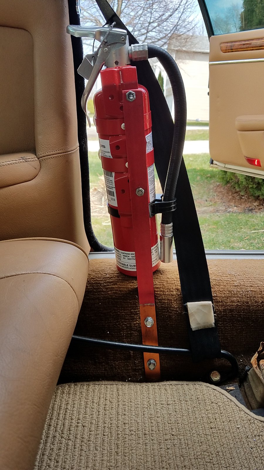

The "brace" that holds the extinguisher is a piece of 1/4" thick aluminum stock. Two long screws secure it to the body, and two other nut/bolt arrangements hole the bracket to the brace.
I've had this installed about a month, and it has proved to be completely non-annoying.
The photo shows the seat all the way back, and I can comfortably get in and out without even knowing the extinguisher is there. It doesn't rattle, bang against the door when I close the door (hard to see in the pics but the bracket is titled in a bit) or cause any other annoyance or interference.
Of course if you actually want to put a passenger in the back seat it will get in the way, but since that sort of torture has long-since been banned I don't have to deal with it :-)
Anyway, if you want a quick way to get to your FE this may do it.

I guess you're dead if someone t-bones you from that side of the car anyways, but in case you had any doubts, that fire extinguisher will certainly help.
I don't like where you have that. If you're not putting anyone in the back seat anyways, why not just mount it horizontally behind your seat somehow? This looks like Takata's solution for an airbag.
I don't think there is anything paranoid about carrying one, but I don't see why it needs to impact aesthetics so much. I like them mounted in front of the seat or a big one in the trunk that offsets the extra time to get it.

The photo shows the seat in the full back position. When it's in the driving position, the entire fire extinguisher assembly is completely behind the seat (as seen from the side). And I think that if I get hit that hard from the left rear quarter...what with no air bags or anything...I'm probably done anyway.
Here in the land of the round-abouts (we have more than 100...more than any other city in the US), the most likely scenario is that a car entering the round about will either hit me on the right side, or I will hit them with my right front. So I don't worry that much about a impact from the left. Not to say it wouldn't happen...but I'm a pretty defensive driver and don't go blundering into an intersection, even on a green light, without seeing what is coming from the left.
I've had the car 5 years now, and this summer I'll replace all the fuel hoses (this was the first thing I did when I bought it).
I don't worry about the ascetics too much. I don't carry that many passengers, and it's virtually unnoticeable from the passenger front seat.

Oh, just another point, the extinguisher is mounted to a flat aluminum bar, which is easily bendable down and in...in fact I can bend it with my hand with not a lot of pressure, so I think it's more likely to be pushed down than going into the seat.
